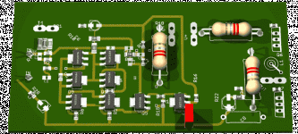

I see many capacitors in series with low value resistors like 0R02... is this just for simulation or is it an intended component...
PS, I am makeing a nice layout now useing SOT223 packages... (they are maybe even slightly larger than the cans)...

R21, R22 and R22 are parasitics - approximate ESR of the capacitors, meant only for simulation. Likewise, R26 and R27 are the approximate lead resistance from the PSU board to the amplifier board, again for the simulation (I should probably have used different notation for the parasitics, I noticed that you've placed and routed the parasitics also on your layout). Everything else is a real component.
I'm changing a few components, removing the parasitics and moving things around on your layout. The main changes are capacitor values and diameters, and replacement of the integrated current mirror with discretes. I will also try to route as much as possible on one layer, leaving just a few unavoidable jumpers.
The main problem I'm facing is that the free version of Eagle 4.16 seems to have a minimum snap-to grid value that is larger than what you used, making some angled routes impossible to route at nice (45, 90, 135 degree) angles. I think I can work around it, let me see how it goes...

Big sigh of relief....
Can you show resistor dissipation as well with your sim program...?
I am just working on rough guesses so far...

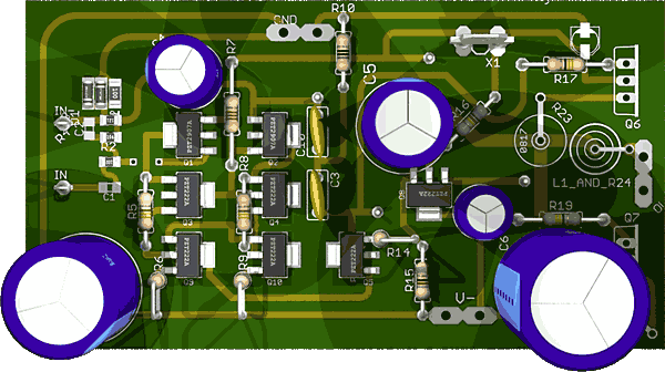

Excuse me going all SMD on the project, it is some practice... First time I made working new library components...
As you can see the transistors are realy big for SMD stuff...
Which brings me to another question... The 2n2222s etc used I guess were pretty hot at the time of design, but surely there has to be better devices by now?
P.S. it is notfinished yet.. just a snapshot of were I am at now.

R23 is 1W, R25 is 5W. Everything else can be 1/4 W.
The electrolytics (numbering as per my schematic) are:
C4: 100uF, 25v; 8 mm should be fine.
C5: 330uF, 50/63v; 10 mm should be ok, 12 mm by way of abundant precaution.
C11, C14: 1800uF, 25/35v; 12 mm should be ok. (I forgot to add a film bypass cap in parallel to these. You can put a 100nF film in parallel with both these).
C7: 330uF, 6.3v or higher; 10 mm.
C8: 9900uf, 6.3v consisting of 3 x 3300uF, 6.3v in parallel (again missed showing the caps in parallel on LTSpice schematic). 4 x 12mm should cover any need for a 4th cap in parallel.
The other caps seem to be ok - you may want to leave enough width for the small caps to allow the use of polystyrene, silver mica or box-type polyester as needed. In particular, the input coupling cap (C1) outline can be made much larger to allow the use of bulky Axial-lead Teflons/Paper-Oil/Polyprops, etc., as necessary.
Edit: The 2n2222/2n2907 are because of the included small-signal LTSpice models - you can safely substitute any small signal device with Vceo > 50v, including the following:
2n2222: bc548/549/550, bf422, 2sc1815, 2sc1845, 2sc2240, mpsa42, ...
2n2907: bc558/559/560, bf423, 2sa1015, 2sa992, 2sa970, mpsa92, ...
For Q3, 2sc2705 is probably best, but any of the NPNs above should work. Also add an outline for a Miller cap of ~27 pF between B-C of Q3.

AKSA, thanks for your kind words. Nordic, thanks for your good work on the SMT PCB and giving me a nice head-start on the through-hole version. I wrestled with it until 3 AM - the modified placement is almost done, and the remaining rat's nest looks very manageable now. I'm confident that all tracks will route in one layer, and will be reasonably short and smooth.
