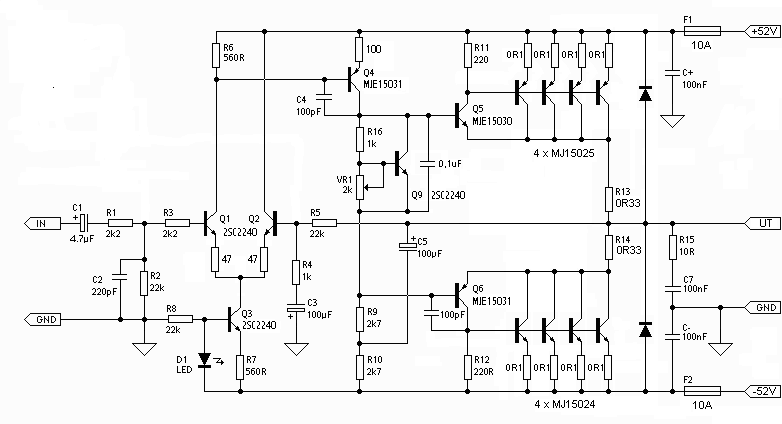

I've been following this thread for a while. Since I'm about to build a modified Rod Elliot amp too.
Here's my version of the circuit.
What do you think about this?
I'm a little unsure about the value of the degeneration resistors, I do understand that these will reduce open-loop gain much though.

recommend also that you put a res between the emitter and -60 V. This creates a local feedback and you will get a more temperature stable stage and lower distortion. You will also improve the phase margin (less possibilities to oscillation) and get a more predicable gain. Voltage across this res should be at least 0,5-1 V. The same goes for Q1 and Q2. 47-220 ohms are normal values. You won't improve thermal stability (not a problem here) but you lower the dist. You will also get slightly higher noise but that's not a big problem, usually only critical in mic and phono amps.
Why should the voltage across the resistance be atleast 0,5-1V?
And aprox. how much open-loop gain is recommended?
/Freddie
letting the emitter resistor have 0.5 - 1 volt accross it improves the VAS circuit by improving linearity and compensates for any current changes accross the collector by feeding a negative signal back to the base. Thus introducing local negative feed back and also making the stage more temperature stable. The reason the voltage is 0.5-1 is so you have a good amount of feedback, since more voltage accross will mean more feedback and less voltage means less feedback. 1 volt seems to be good since it doesn't cause too much of a voltage drop, and it permits a useful amount of feedback for the gain of the transistor and the current flowing through it... The reason your gain is more predictable is because you can calculate for the feedback of the more stabilized transistor and achieve a less variable number...

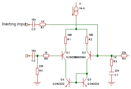

And, I know i could bridge two amps and go BAL to the speaker, but I don't have enough parts for to amps. I did hear that you can feed the inverted side of the BAL input to th other side of the LTP but I'm not sure what to do to make it work. I'd imagine that feeding the signal right to the base of the transistor would work through a 1 or 2k resistor as with the other side and let the feedback also go in there, but I'm not COMPLETELY sure of this.
Here's an example of what I'm thinking so you get an idea....
EDIT:nevermind R6 and R5, they are completely wrong values
