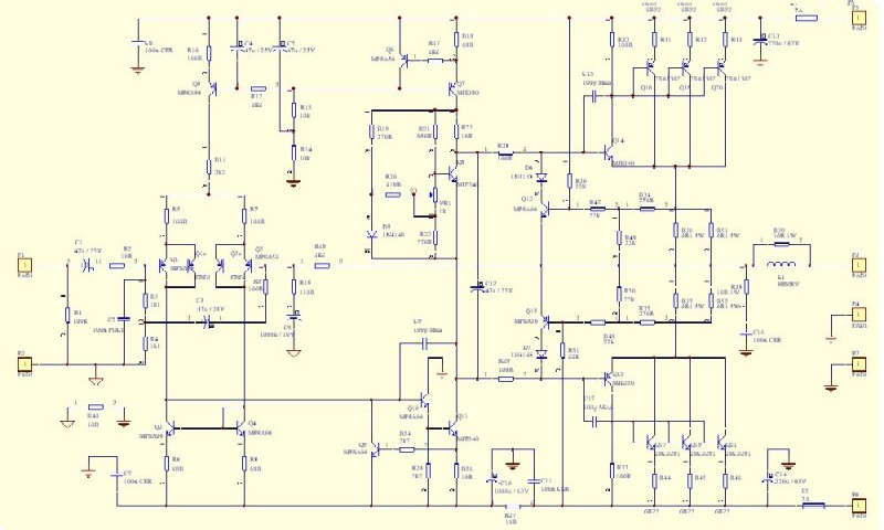

Also, how do I figure out what's going on with bias of the VAS, I know that if it's wrong, I'll have an offset at the output of the whole amp... I'm not sure how it's supposed to achieve bias with the current mirror in there. Does it simply balance itself when the offset from the output comes to the LTP and causes a bias change? or is it independant of that?
Well, could anybody answer my previous question about bias of the VAS, also. Anymore ideas to make this amplifier better? I found out that with the transformer I have, I'll have rails of +/- 80 volts, where my original supply voltage was to be about 65 or 70.
I will change my resistances where needed to compensate for voltage change, but I'm having trouble how I perform the VAS bias! Please, can anyone help me with that part?🙁

The site belongs to Luc Henderieckx, who helped me develop the amp.
The circuit is based on Douglas Self's Load Invariant amp. I believe that you would have probably come to the same circuit if you had continued to improve your design.
I'll try and attach an image of the schematic (my first time). Excuse the low quality, please.
Shaun
e96mlo said:
Some questions:
1. Why do you have parallel transistors in the diff. stage?
2. It seems like you have a limiting transistor on the VAS. What for?
3. Wouldn't the current limiter be on all the time because of the resistor from base to supply?
/Marcus
If you double numbers of transistors you half the noise.
So 4+4 transistors would give 1/4 of the noise in one transistor.
I dont remember if it is -3dB or -6dB in signal/noise (SNR)
for every doubling.
That limiting transistor has to be normally off.
halo
1. They're not meant to be parallel. Think of them as alternatives. Use either MPSA56 or 2SA970 (I think); they have different pin-outs, so I made allocation for both options on the revised PCB.
2. The Vas needs current-limiting for when the VI protection kicks in. But this current limit is set higher than the standing current of the Vas class A stage, so it will not normally come into play.
3. No. (a) There is a voltage divider formed by the other resistors
(b) These are not the final resistor values.
