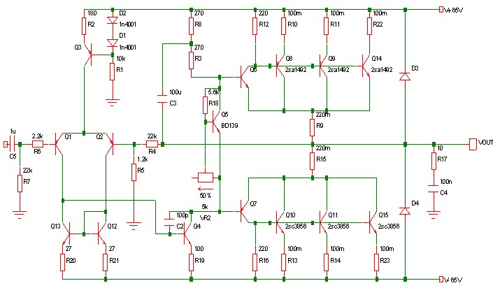

Okay, i see your ideas...
About the flyback diodes, I forgot to pick names for them...
I have a bunch of high curent/voltage diodes that I intend to use here, but I still don't know the number... Also, about the pots, when you say use all three legs, are you meaning like a rheostat or something? And I will use a current mirror in there since it seems so great, I do think it would achieve better balance than the other ideas(pots) Also, I had a question about bias of the VAS, wheres it supposed to come from, what controlls it?

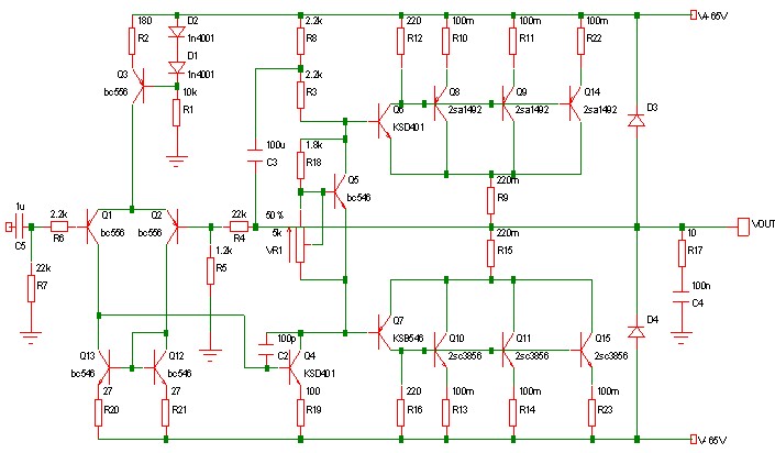

OKAY, I've completed the amplifier design except for the fact that
I can't find the right transistors to use for the LTP, mirror, constant current source, VAS, and drivers.. I was originally going to use 2n3906 for the small signal transistors and BD139/140 for the vas and drivers, but it seems that they are two low in BVceo
for my designated rail voltage. So, can anybody help me choose what transistors t use, because I don't know about that many so I'm having trouble picking... Also, whoever reads this, please look at the finished diag. attached and note if you see something else wrong...

EUREKA! I found the perfect page for finding transistor info and found out what transistors should do it. Sooo, I've completely finished my amp, all I have to do is put my electronics where my mouth is and see how well it performs. If anybody has any pointers for finishing touches, please say so!

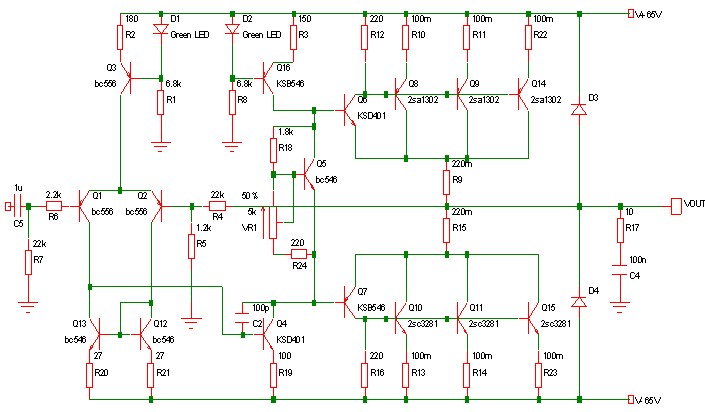

Hanging leg on pot(oops, forgot the diagram)
Sorry about that, I meant to post the latest diagram with that note, here it is anyway, and I have fixed the hanging leg on the pot...
EDIT: I added the extra O/T trannies to make sure I had enough current handling, just so you know...
