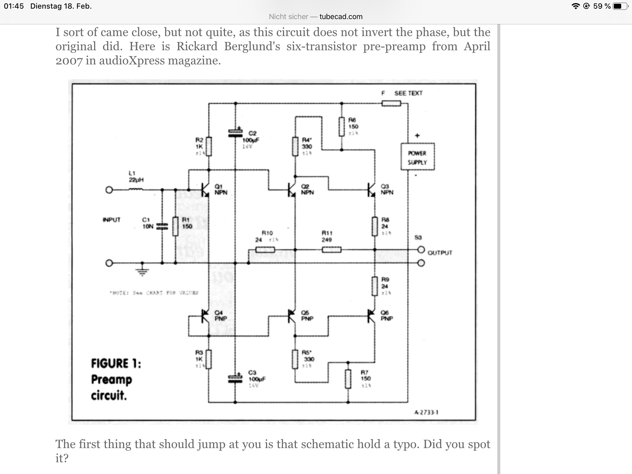

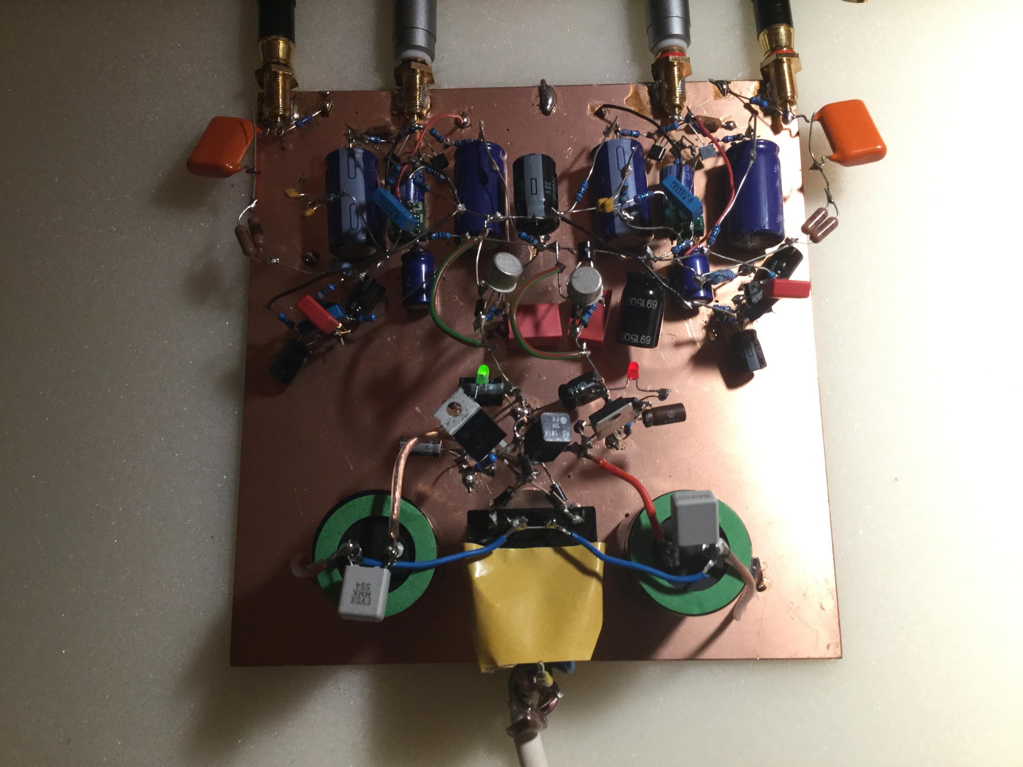

Just for fun I build the Renardson MC Pre-Pre, a design that is a bit similar to what QUAD did.
Unfortunately I could not make it work so far. I build several versions. All play music but it sound distorted and noisy.
I may be oscillation, on the scope the output shows spikes.

It's worth trying. I always treat everyone as stupid. I start with myself. From your photo you have done the right things.

Greetings from beyond the grave. The Bonsai post was a little disconcerting, but no, I'm still around. There was a post on another thread saying I was at Manchester University, which is equally wrong. I'm just retired. I never needed a MC preamp and so never bothered to build the circuit. I know Dimitri tried it, but with a servo, and possibly used the circuit in a commercial design, but anyway I don't see anything obviously wrong with this version. I would worry slightly about those complementary feedback pairs in the supplies, maybe try removing the 1000uF capacitors, or the idea to try with batteries may narrow down the problem.

I bridged the cap multiplier and now it works. So there must have being some Oszillation.
I have considerable noise now as a result so simple LM317, 337 does not seem enough. I will try how to solve that.
