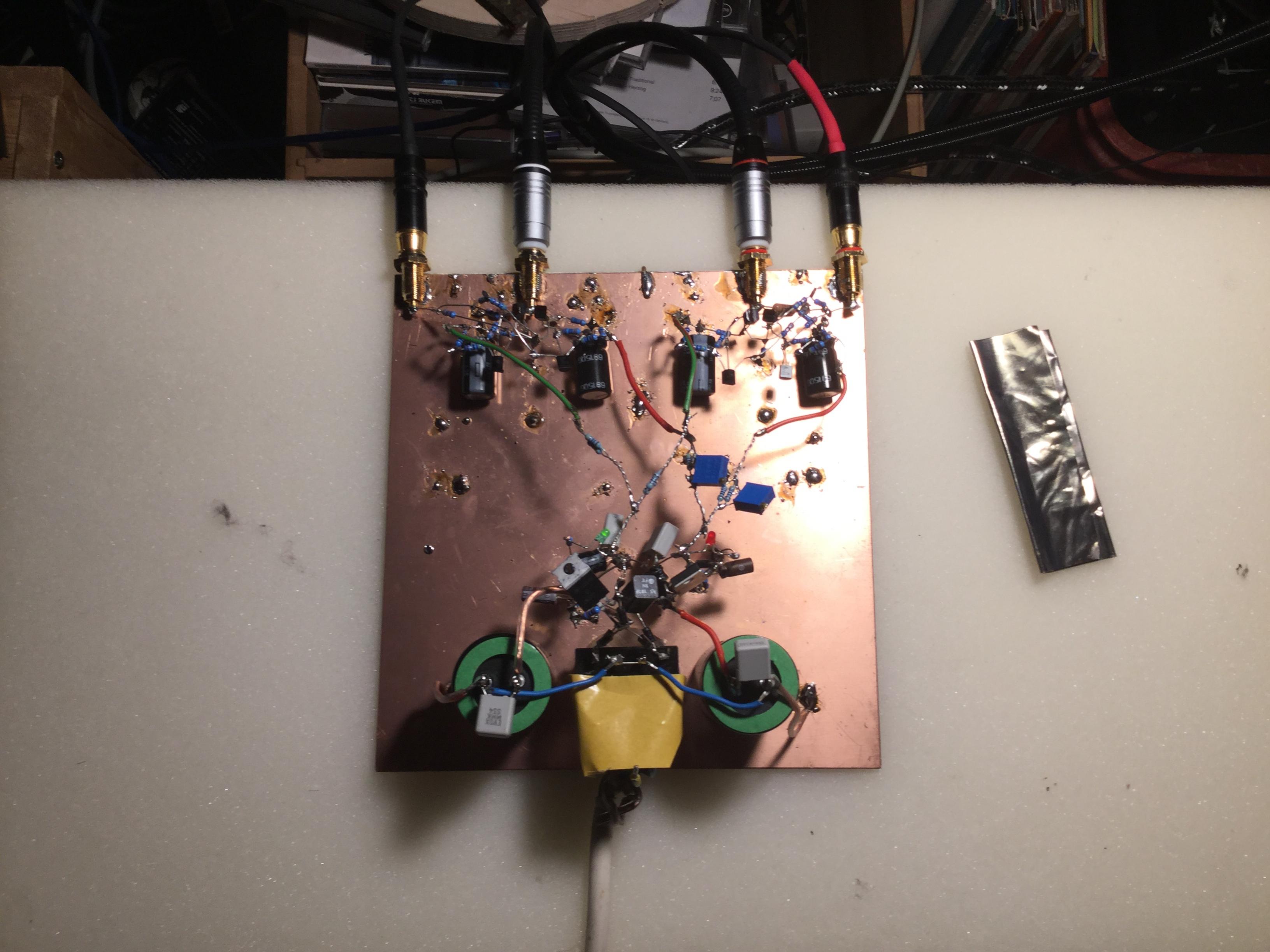

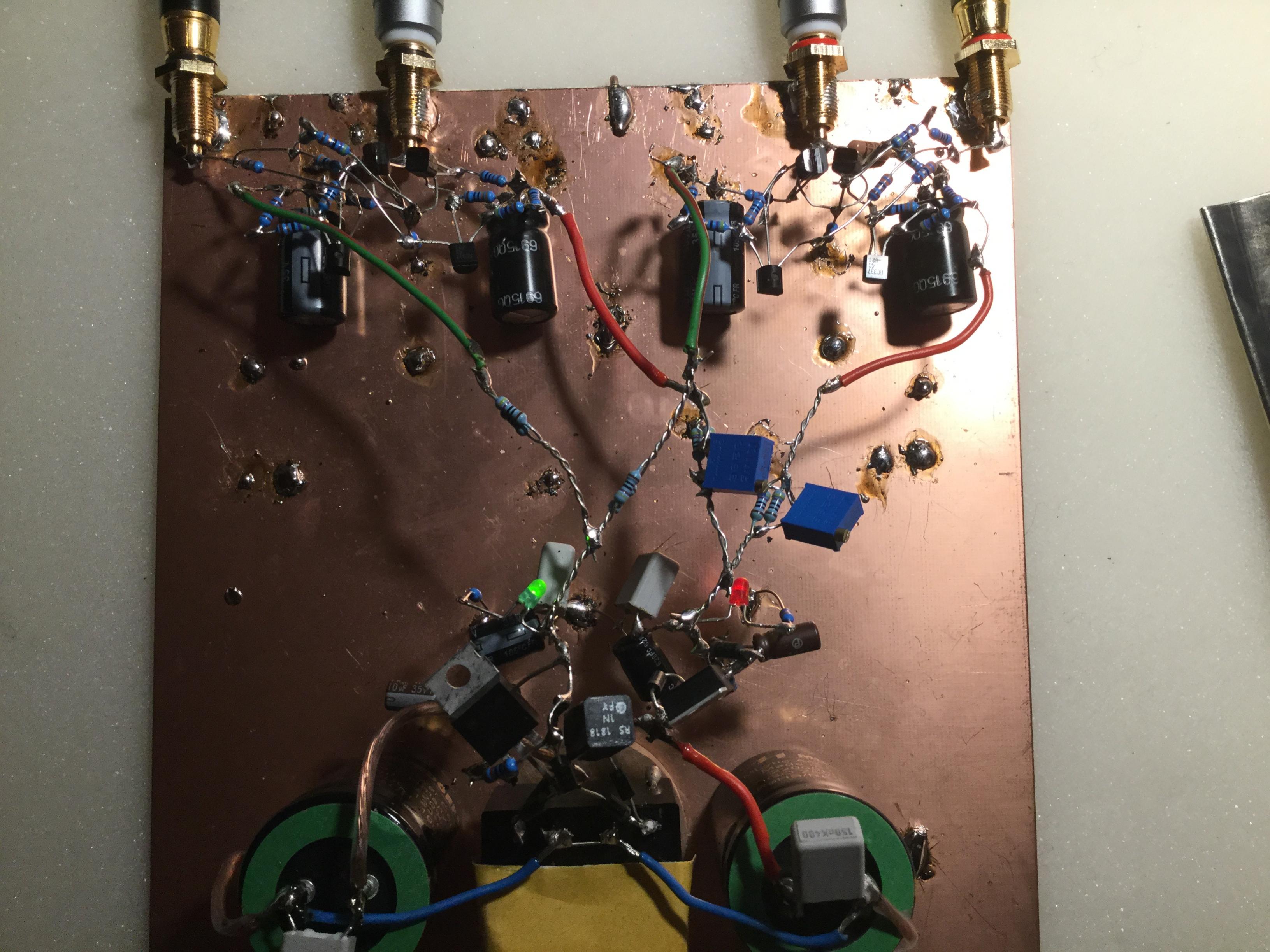

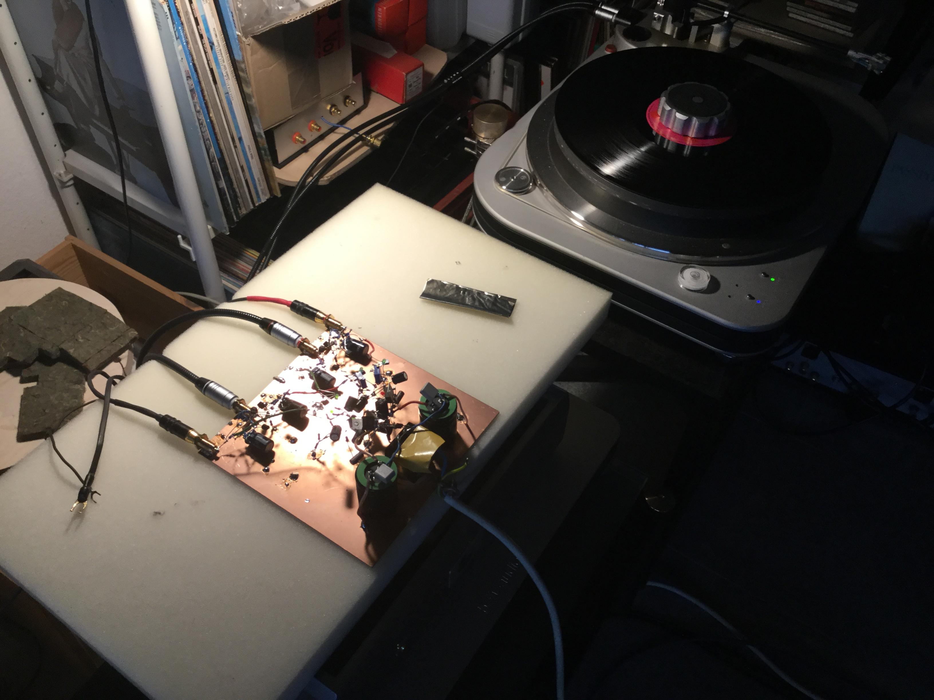

This time I have luck. The circuit in post 11082 worked right away.
The only difference is that I use a conventional plus-minus supply.
That has a disadvantage. Input and output offset has to be trimmed.
I simply made the two supply voltages as similar as a could with a simple trimmer.
There is is a bit of hum. That partly comes from the mains transformer that is in board and partly from the PSSR that is not that great.
I have a solution for this that I will try now.
