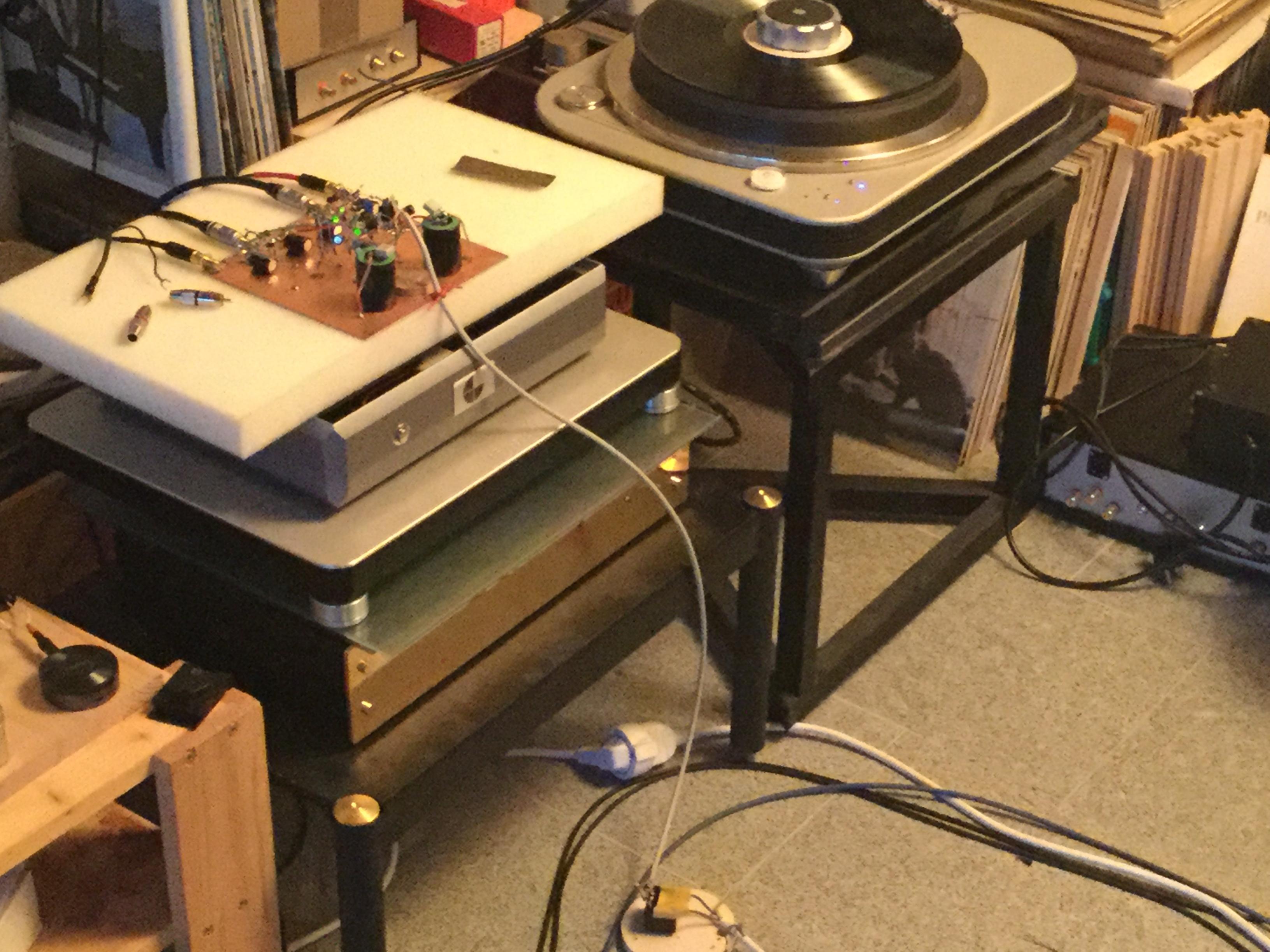

I moved the transformer to the floor. Hum gone, hiss very low.

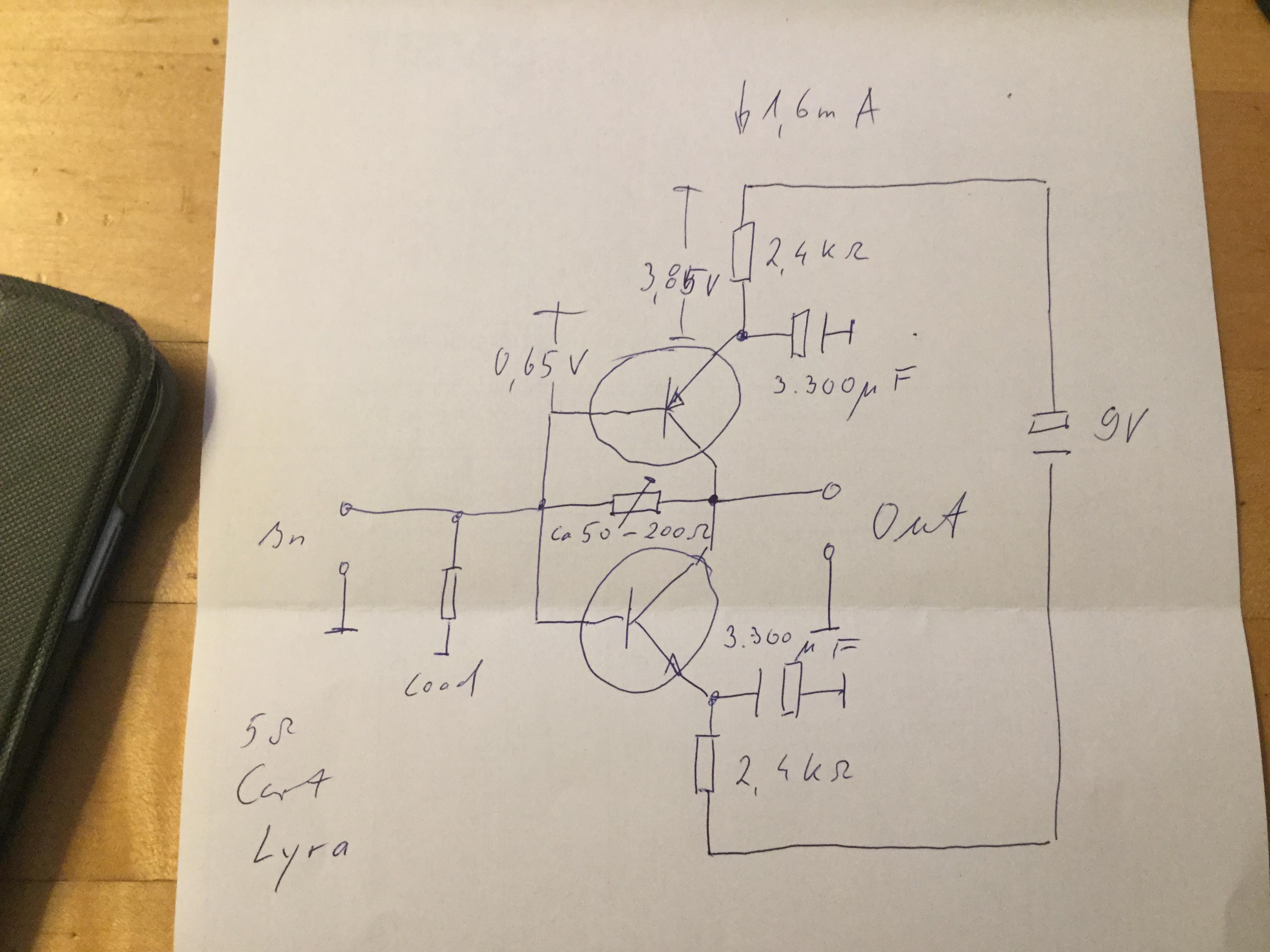

Building constant current sources for better PSRR and less distortion.
What is the purpose of the big caps c4 and c5 in your schematic ?

Here is the most simple circuit I could think of.
It is a John Curl design from the 70th.
You could also take out the feedback resistor and terminate the output with it.
You could call the first version shunt feedback and the second version a kind of Lokal current feedback. Some will say open loop.
