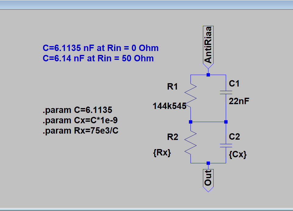

Would you share the anti riaa circuit you are using ?
Here it is.
You can use either a source of 0 Ohm or 50 Ohm by changing the value of {Cx}.
Input is at the top, output has to be loaded with 10 Ohm.

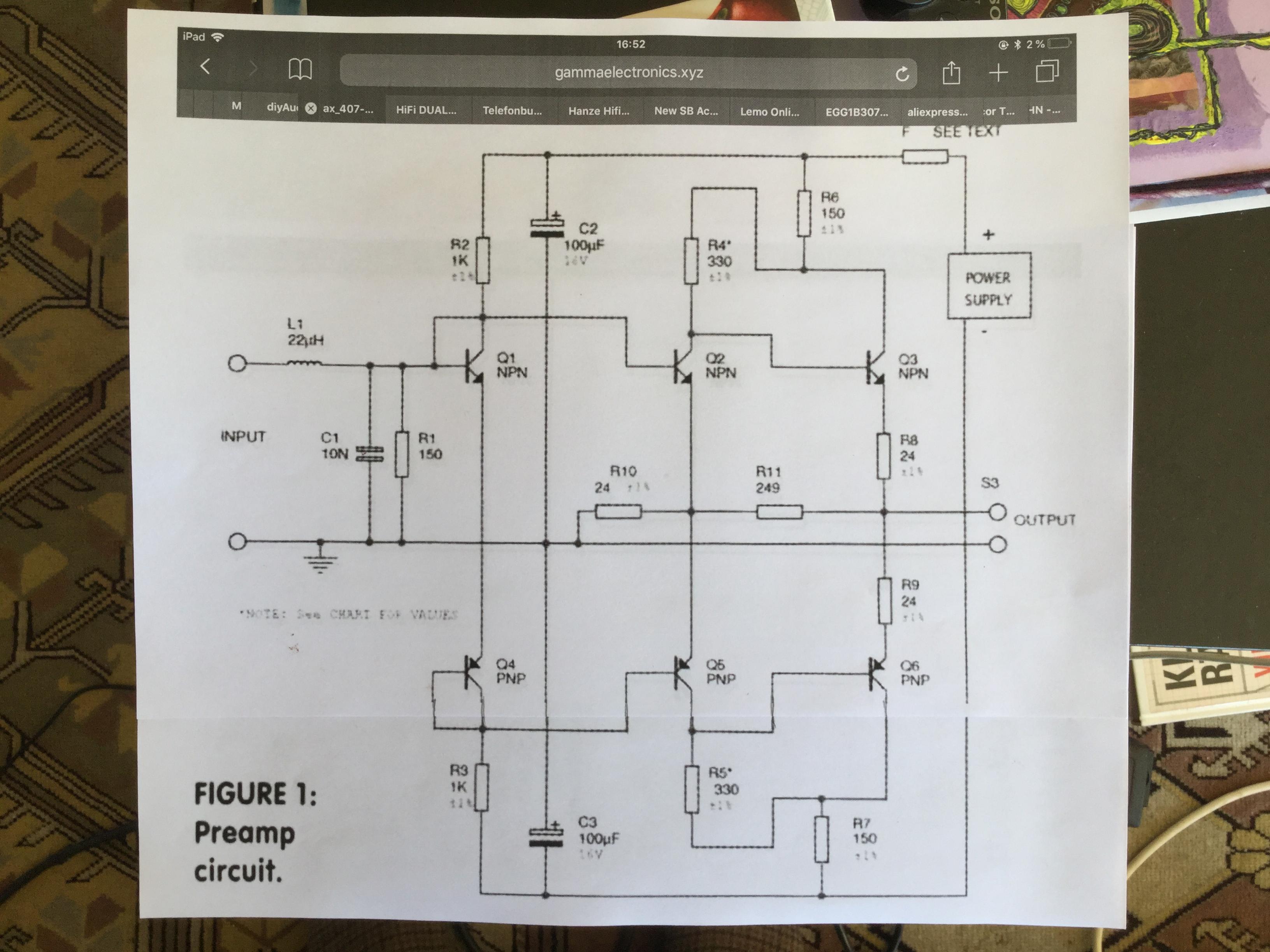

O.k. a quick sim, all BC-327/337(40)'s
Gain about 28dB
Noise about 24nv/Hz1/2
THD near -85dB
PSU-load 75mA
As one can see, the design has a 'not do good' PSSR and the 75mA (per 15V rail) is thus demanding, it (the PSU) needs to be firm and precise.
The output offset (with the ideal transistors) is 11mV (not to bad at all).
