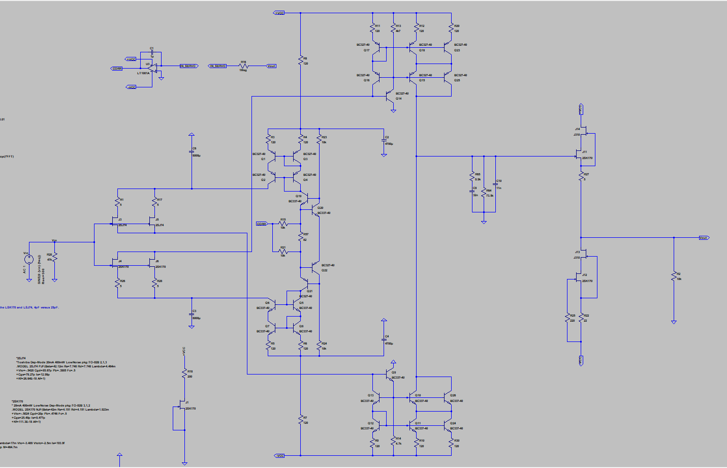

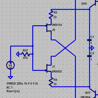

Just tried :) Q&D (quick and dirty) removed the input BJT's substituted 2 JFets (more or less randomly selected) and guess what, it works, the gain is down to 60dB (from 80) and the sim seems to work just fine, I'm sure you can take it from here :)

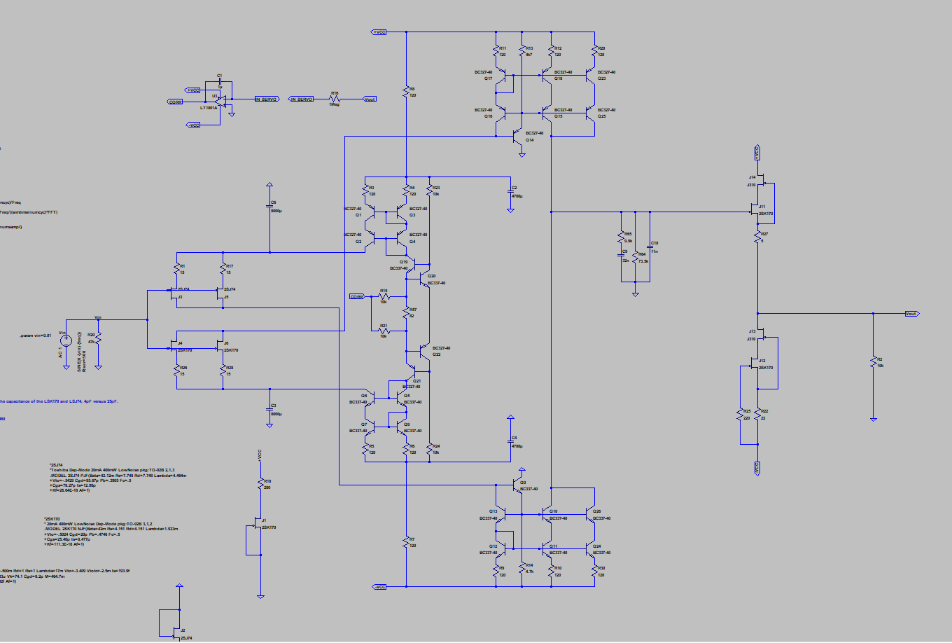

What i need to know is your imput regarding the amplifying current mirror. Is it stable?
I just came across this thread, not knowing the history.
But there are a few things that I noticed:
1) The 5 Ohm resistors are connected to the Drains of J3&J5, but to the Sources of J4&J6. They should all be connected to the source.
2) Of course the current mirrors are stable, but I don't get why the emitters of Q10&Q25 and Q15&Q25 are connected, leave this connection.
3) I see no reason why the current mirrors around Q1-8, Q19-22 are so extremely complex.
This could be done with far less components only playing a role for DC.
