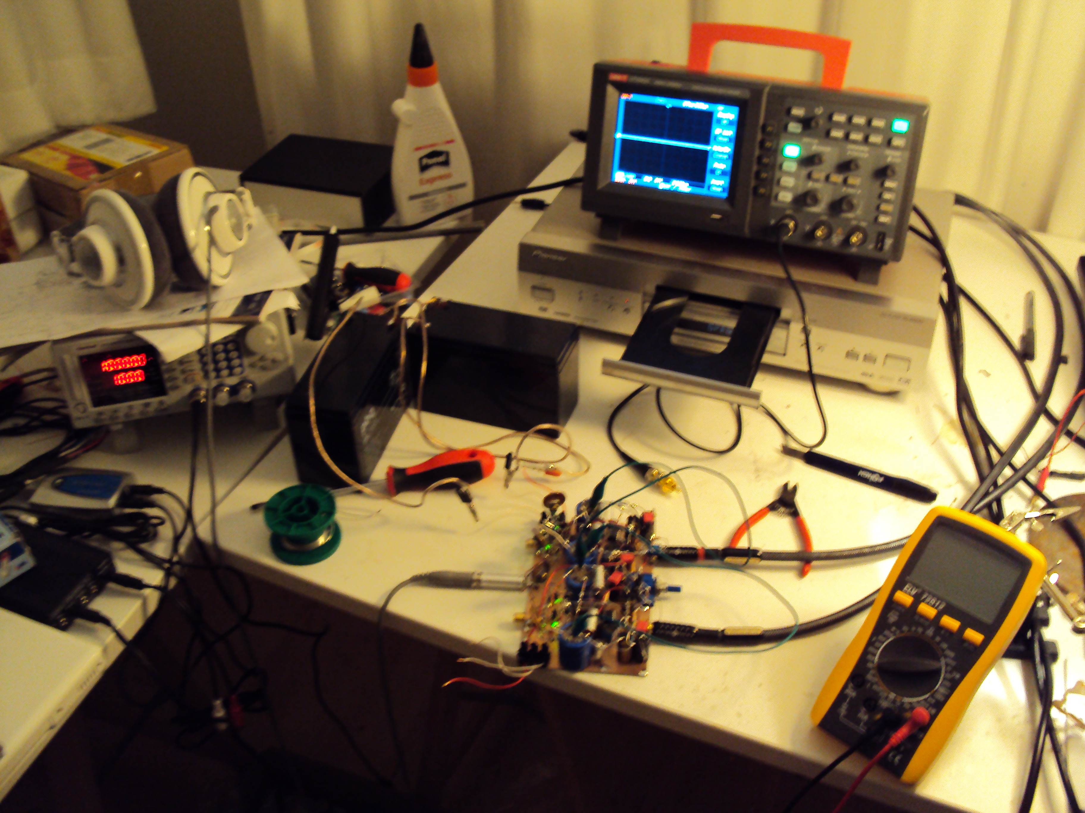

On the photo i am posting you also see my new home mini lab.
I got a little 40MHz digital scope and a 20Mhz generator.
I can measure distortion with my Praxis system on my laptop but only down to -90dB.
I use an M-Audio Transit soundcard because of portablity but that limits resolution.
Dos anybody know a better portable soundcard that does better then that ?

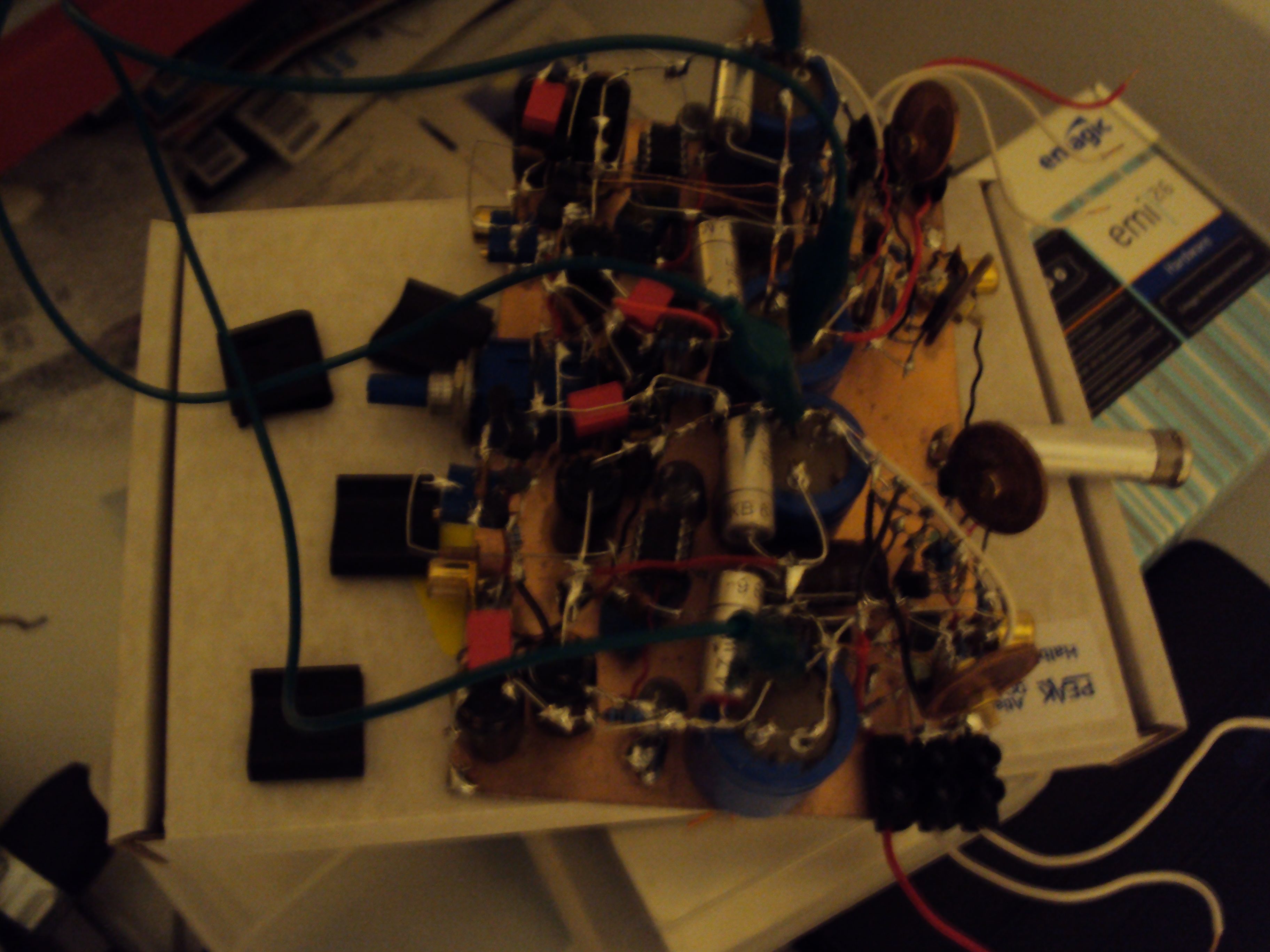

I started to build my version of the Self phonostage.
First, the circuit i posted had two errors : i forgot one 10nF cap and i called a 47kOhm resistor a 200 Ohm. Sorry, the version posted now corrects this errors.
I will use the JLH buffer and because i can not let good enough, good enough i will try darlingtons this time with potentially even less distortion.
I am not sure if i need the servo still but i kept it in the diagramm.
First i build the filter banks and the good news is that the Self trick works. Paralleling several caps with 1% tolerance gives a cap with better then 0.5% tolerance.
The 10nf´s added to absolutely the same value ( 49nF ) , bejond my measurement limit and the 4.7nF bank was better then 0.5%.
I lowered the corner frequency of the subsonic filter to 14Hz / -3dB.
John will recocknise the famous pink Röderstein MKC as used in vintage Mark Levinson equipment.
I also found some "real" cooling profiles for my headphone amp.
I will install them and listen a bit before i go to bed.
