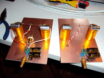

I am already building the MC stage. I did not use the Self design here. It is rather a very simple Phono Clone circuit with the twist that i can use a low value feedback resistor with the ADA4898-1. That comes in quite handy. I have build Phono Clones with the OP211 and AD797 that performed surprisingly well but making the feedback resistor smaller then 500 Ohm was not an option. With my Titan the gain was nearly 40dB and i had to reduce the gain at the output with a resistive devider. Not very elegant !

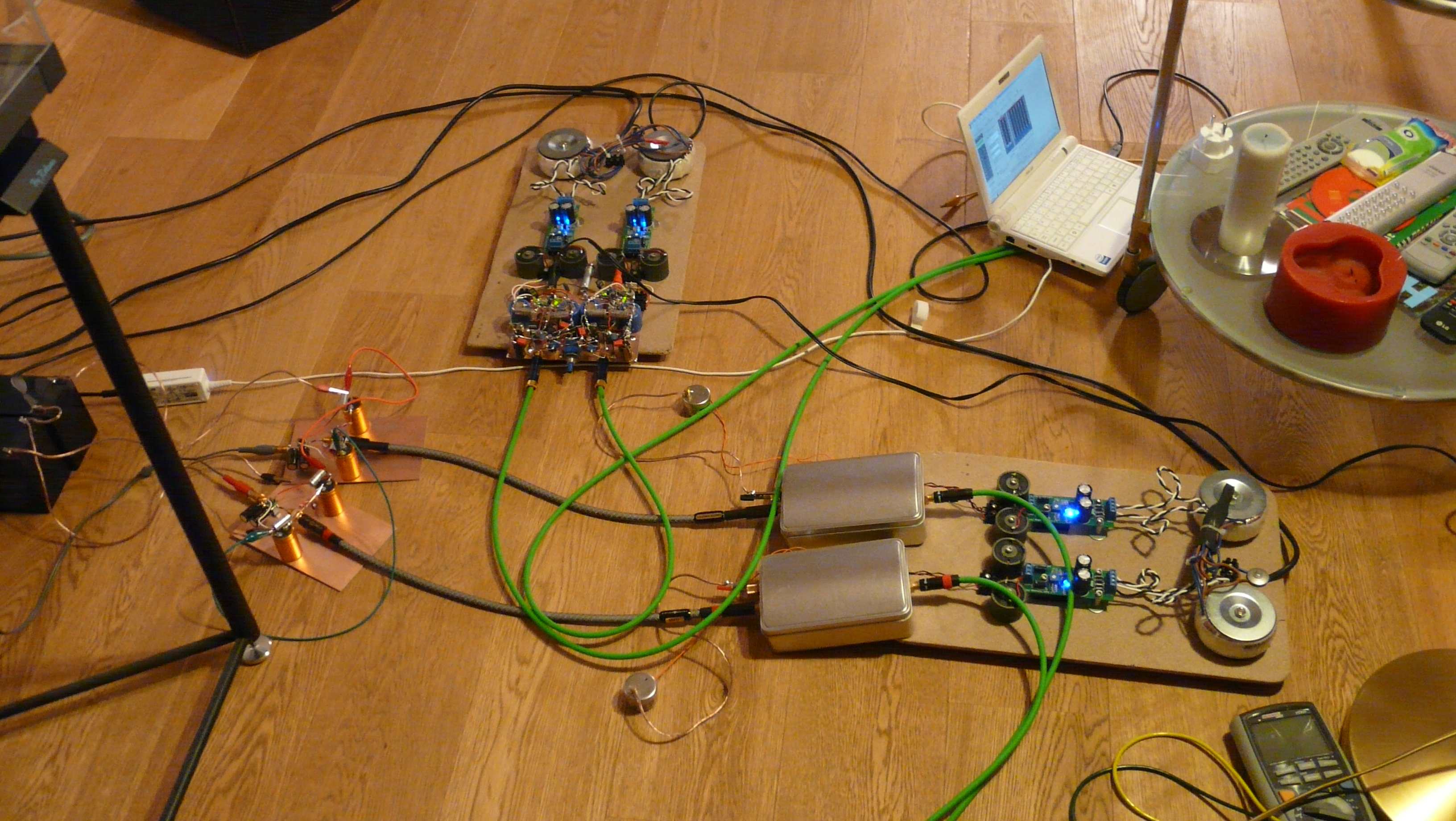

Listening to phonstages and further work on the headphone amp.
I visited a friend and we listened to phono and also listened and measured my headamp
on an Audio Precission system.
We used my REGA turntable with Lyra Helicon on a Roxan stand.
First we listened to the High Z MPP with inductive RIAA and later we substituted the MPP
with the ADA4898 phonoclone.
Noise in both setups was no problem. The MPP dead quite and the Phonoclone had a low level of hiss that sounded like white noise, ear on the electrostatic speakers at decent volume. That ADA4898 has a very low 1/F corner frequency and is superior to the AD797 in that issue.
We both preferered the MPP slightly. It had a more robust and full sound. The Phonoclone was typical for circuits like that. Very fast and clean, maybe a little sterile but with very good resolution, fascinating in it´s own right. This is a very simple little project that you can build in one afternoon. If you want even less noise you can parallel
4 or 8 but that drives the price up ( that chips are not cheep) and a discreet stage can be made for that money.
It was very interesting to listen to and measure the headamp. I had constructed it without any measurement equipment just by common sence and listening and in fact it sounds just fine. We usen the Sennheiser PX200 that worked extremely well.
This is a great bargain when you want to try headphone listening without spending a fortune. Measuring it brought interesting results. We measured the Fet buffer, the linestage and the outputstage seperately. Clipping was at 7.5V RMS. That is loud enough for hedaphone listening but i am contemplating to raise the output for my hard to drive AKG701.
The Fet produced around 0.2% distortion, mainly second harmonic and very linear over frequeny. The compleet amplifier had an exponentially falling distortion profile.
A recipy for good sound in my experience. The shunt feedback voltage amplifier was of cause 100x better and the diamond buffer alone was also under 0.002% so it is posible to run that stage open loop as an option. If you are uncomfortabe with the Fet i designed a new version with OP buffer and servo that should have neglible distortion.
Let´s see how it sounds subjectively. 0.2% second harmonic does not sound like distortion though and one version could have a provission to switch betwen the Fet and OPamp and also between open and closed loop.

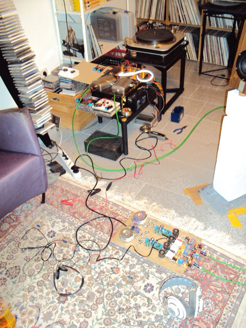

The dirty details
Some visuals:
This picture shows prototypes of Joachims' line amp/headphone amp at the top, his very compact prepre consisting of a new hot opamp and one (yes, one) resistor at the left. The batteries that supplied power to the prepre can be seen at the extreme left (black bricks).
The RIAA preamp is in the metal box, supplied by LC Audio power. It has the inductive RIAA, and the two coils, in sowter xformer cases, can be seen external to the box.
To say it sounded great must be the understatement of the month.
