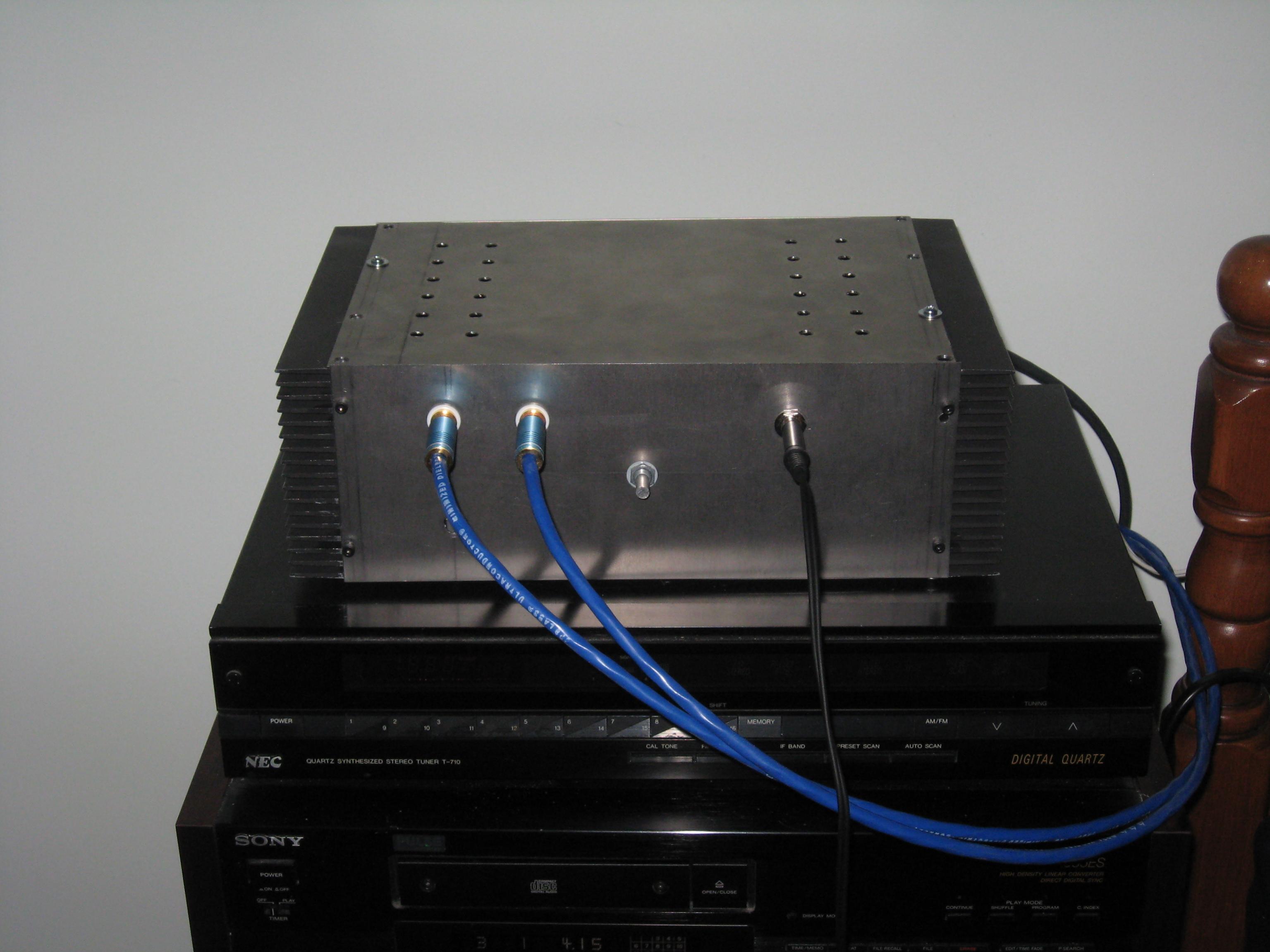

I completed the amp as described By Grey in the first post. I am using HD600 cans. The impedance of the headphones is 300 ohms. The amp sounds very nice,very detailed. The " veil" effect of the Sens seems to be greatly diminished. I used IRF630'S for the outputs. Thank you grey for posting the schematic and all youre advice.

I don't use a cap at the output. I matched the active components very close and used the source resistors to zero output DC-offset. After some fiddling I ended up with around 5-10mV.
No pot at input..
I also tried to build the taylored version but couldn't get it to work properly. I didn't spend alot of time with the Taylored version and plan to return to it when I find the time. Also wanted to listen some time to the "basic" version first.
For power supply I use PCB from chipamp.com in following config:
Trafo 225VA 2x18V
Rectifiers MUR860
Panasonic TSHA Caps
10000µf + 47000µf + 2.2mH + 47000µf + 2,2µf MKP.
I also suggest first building the standard version. It is easy and can hardly go wrong.
The Taylor version is quite a bit more complex in principle and not for beginners.
It looks very simple in the schematics, but there are many factors linked together, and you need to know which one to trim if you devices (both LU1014 and 2SJ103BL) are not quite the same as mine, which will be 99% the case.
Patrick
