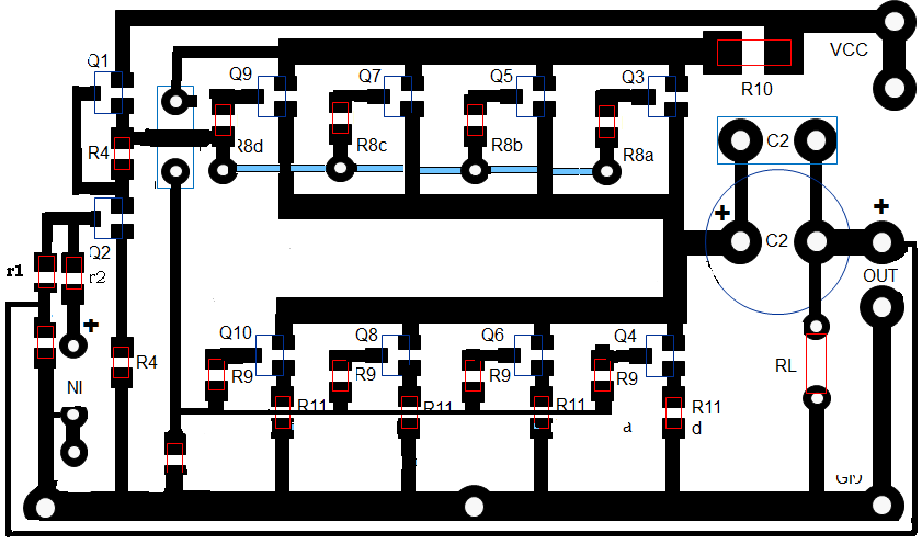

MOSFET follower headphone amplifier

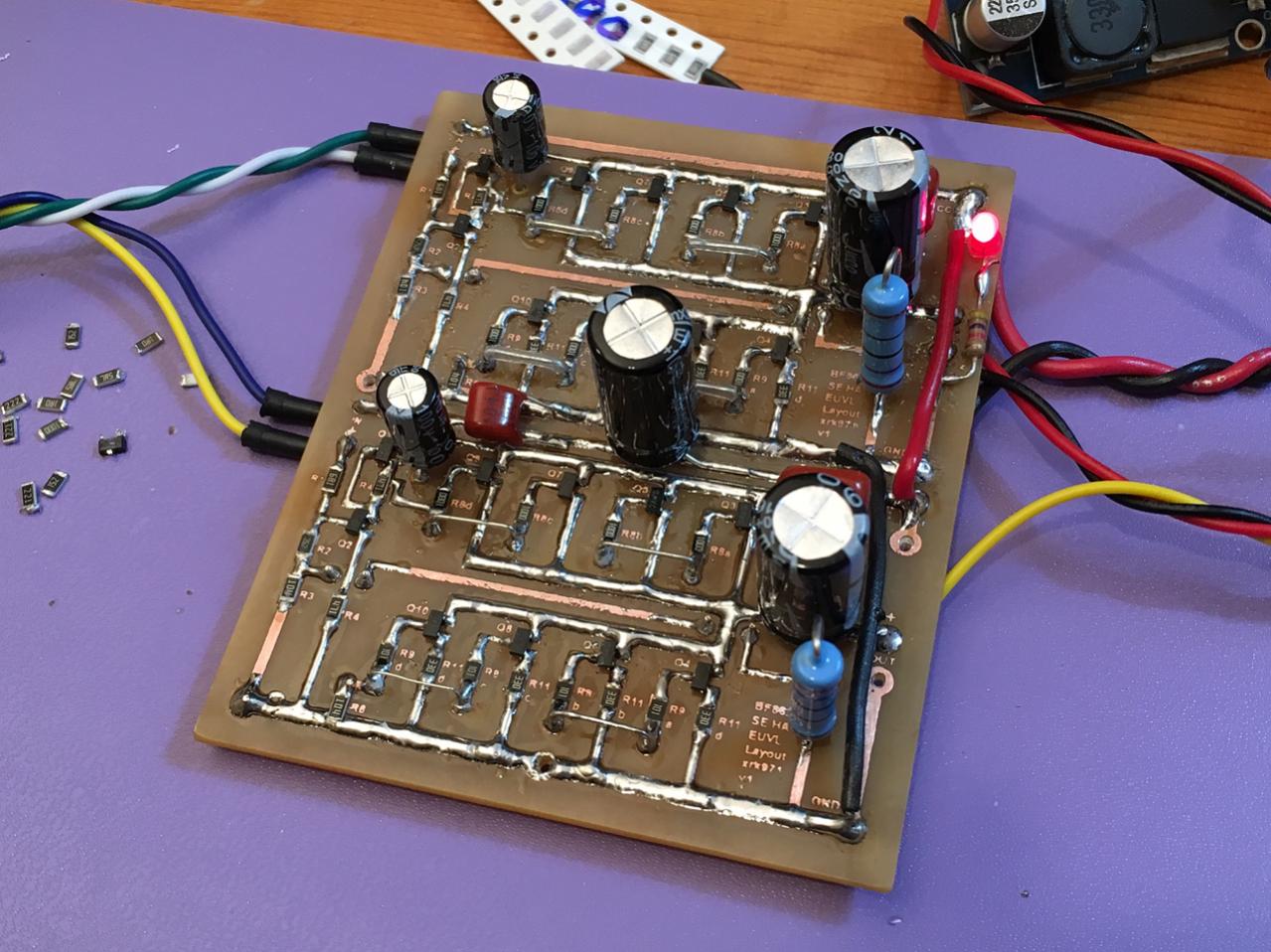

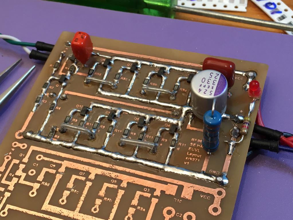

Yes, sort of, I matched them in-situ. After they were installed in circuit, i measured current across each one and they were within 5% (all JFETs from same reel). The outliers, I would remove and pop a new one in until the currents matched. Typically, there was 1 out of 4 that needed to be replaced.
In stereo now. Sounds great.
