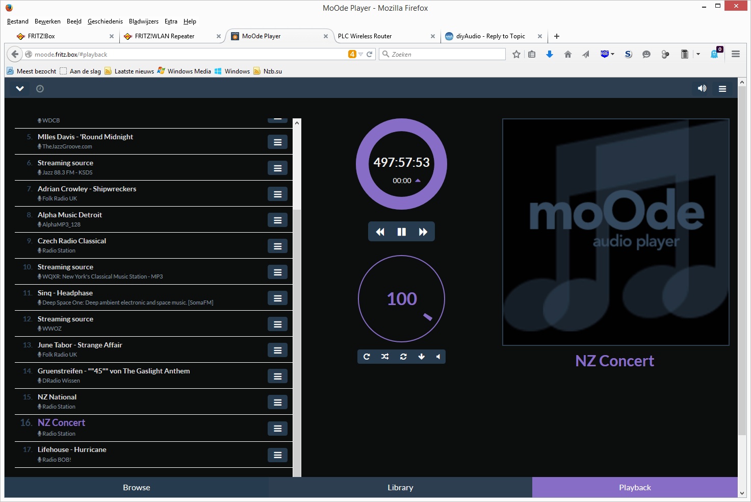

64K is their rate as per this page...Hi,
I couldn't get the mms urls to work at all!
These urls worked ok:
"http://radionz-ice.streamguys.com:80/concert.mp3"
"http://radionz-ice.streamguys.com:80/national.mp3"
Concert was streaming at 48K
National at 64K
Would love to have higher bit rate!
TC
Radio New Zealand : Audio help
(scroll to the end)
Yes, wish the rate was higher too... I live a hop skip and a jump from their Fm transmitter but in a valley that gets extremely poor reception..
(scroll to the end)
National at 64K
TC
