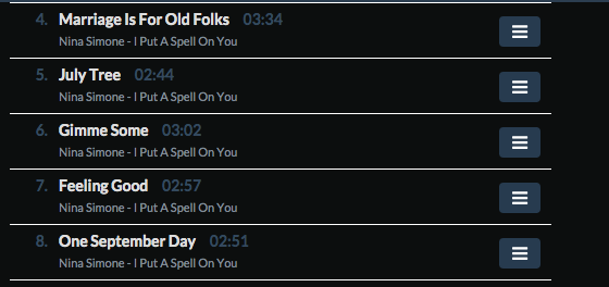

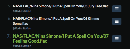

I think I've found out why songs get displayed as radio stations - it's when they don't have proper or full tags.
Here - before and after tagging:

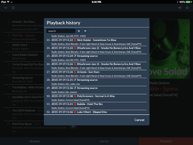

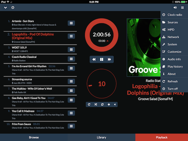

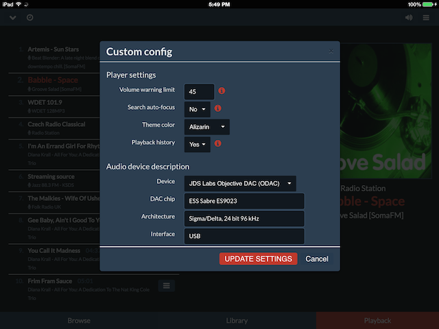

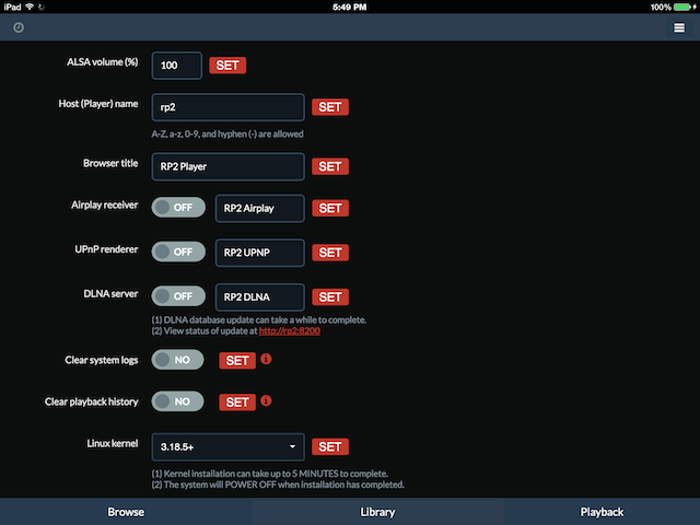

Here's some screen shots of the completed Playback history feature in release 1.9 that includes the following:
- Typedown search
- First/last page speed buttons
- Google song search
The playback history log is turned on/off by a setting on the Custom config popup and cleared if desired, by a setting on the System config page. System logs can also be cleared via System config (no need for ssh!). The history log is maintained by server-side code so no need to have the Player UI running.
