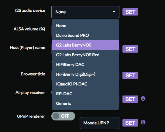

None of the above worked... so I went back and re-burned the image, then the first thing I did was to execute the old Windows systems engineers' trick of 'Just Update EVERYTHING'... or 'rpi-update' as it's known in PiLand.
And guess what? The HiFiberry Amp has disappeared from your list of i2s devices.
attachment.php
So...
I manually made the changes and voila - working.

Nope, can't get it to work with the overlay at all, but it works fine with the 'old' method of entering drivers in /etc/modules
I'll send u a link to 2.0 test release 1 which runs 3.18.14 kernel, same as what is provided by rip-update. If modules method works on this release then I can code for it in I2S config routine for the Hifiberry Amp(Amp+)
Tim

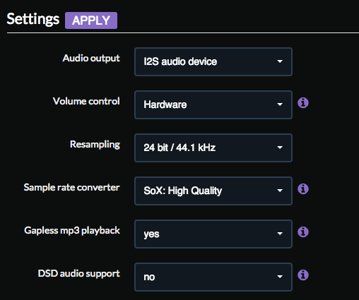

Worked out of the box by selecting HifiBerry Amp from the system screen.
The 'i2s audio device' option was automatically populated in MPD.
However - no hardware volume control, but software works fine.
Any settings I can retrieve for you?
(1) "Worked out of the box by selecting HifiBerry Amp from the system screen."
This suggests / confirms the overlay driver is ok in 3.18.14
(2) "However - no hardware volume control, but software works fine.
On System config screen is ALSA volume blank with an associated message "PCM volume mixer not detected for attached audio device" ?
