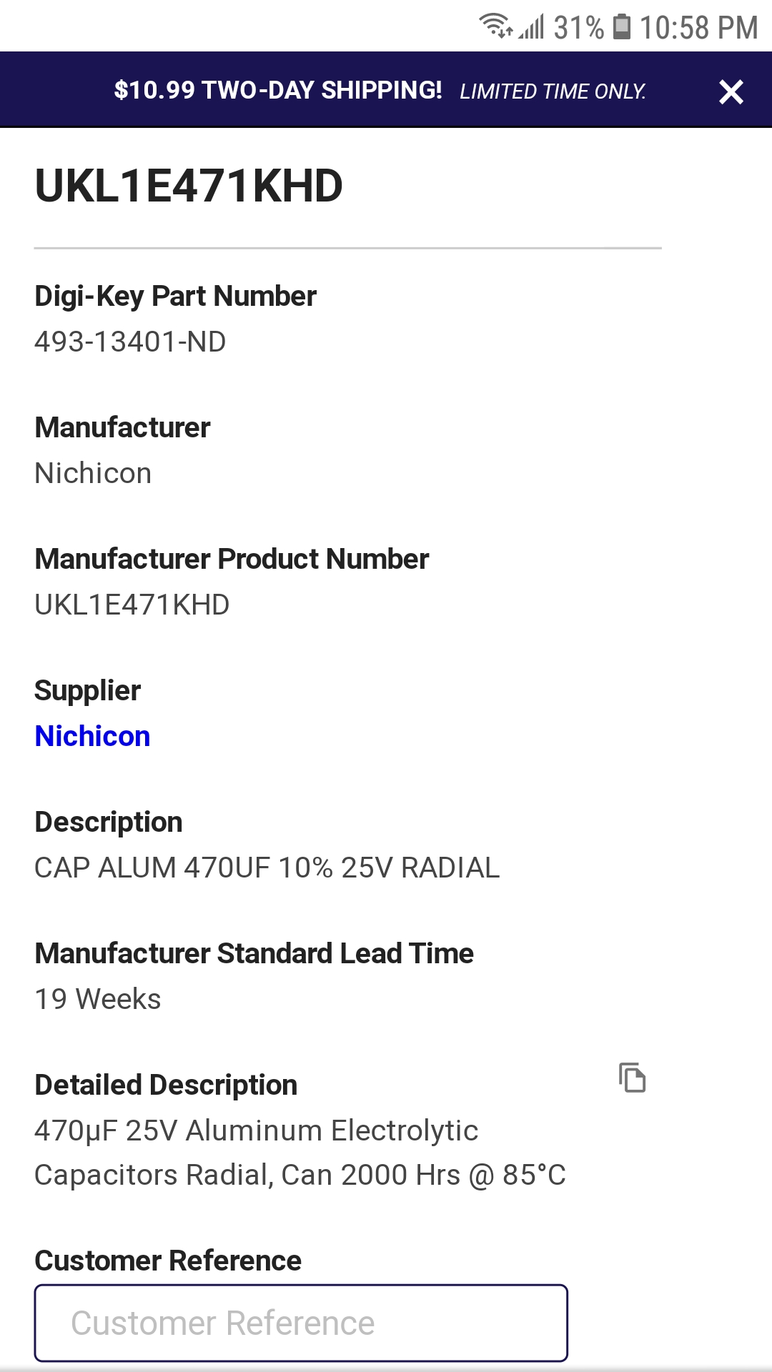

Right on queue! I told you the stock electrolytics suck. They're ticking time-bombs. Everyone needs to recap them that hasn't already! Any mods are going to be short-lived with the stock e-caps as these units are now getting pretty long in the tooth and ready to expire without a refresh.
Is this the post you were thinking of? I’m ok w/replacing all the PS “problem children.” Make and any specification upgrade or “like for like?”You may enjoy dealing with SMD. I find it overly tedious. The overuse of these ceramic SMD caps used everywhere in this device is.. unfortunate. I want to upgrade the analog out section but am just going to purchase one of those upgrade kits from behringermods if he still sells them.

Replace all the 470/16 and 470/25 with the Nichicon UKL low-leakage type as well as any others in the power supply with UKL series of the same capacitance as originals, with voltage ratings the same as originals, or one or two steps higher (max). Otherwise increased ripple starts to get out of hand and changes design parameters. Now available in 10% tolerance! See pic below. Usually these electrolytics (and all others) are rated at 20%, so this is great.
Low-leakage is sometimes referred to as "low-noise" which is what you want in a power supply. Most choose the low ESR/ High Ripple route, also fine, just possibly a little noisier.

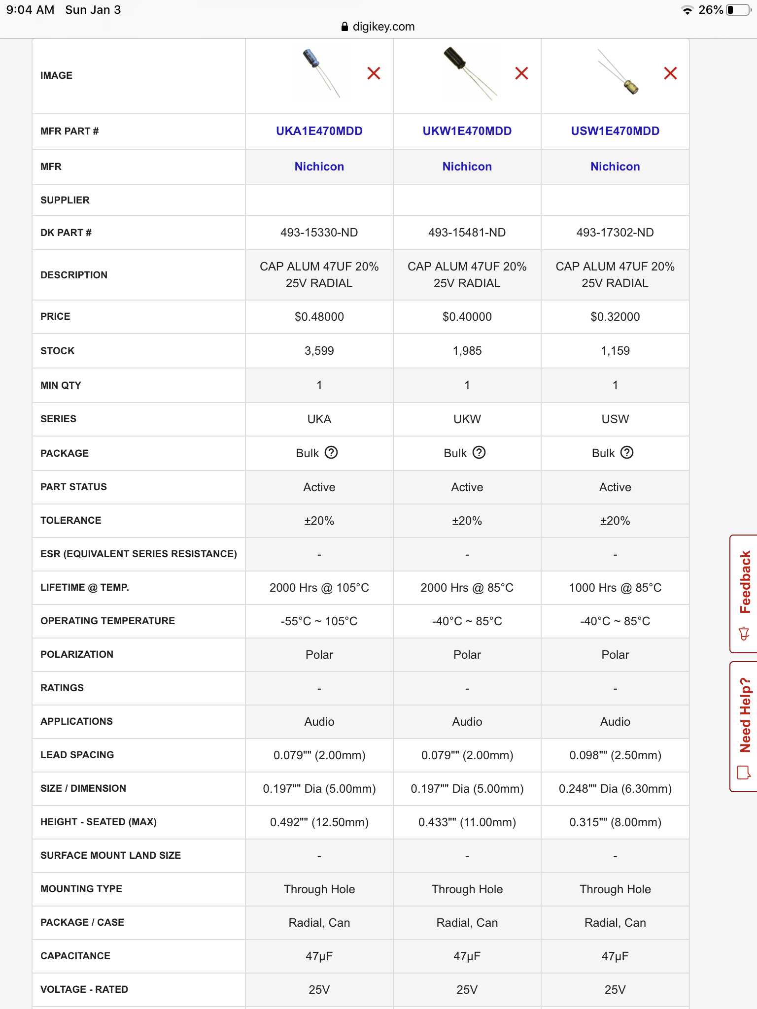

I would not change capacitance or undercut voltage values to allow fitment in tight spaces. Stick with 47uf 25V and find other series that will fit.
UKA, UKW, and a brand-new audio series USW would work for fitment. All are audio-grade and 5mm in diameter except for USW which is 6.3mm. I finally received my DEQ and will be ordering the new 47uf 25V USW series because I am curious to hear how they sound. The original Decon and Xunda caps were probably General-Purpose, cheap Chinese caps. Any Nichicons, Panasonic’s or Elnas would be a huge improvement, especially if they are audio-grade, or are selected for low leakage, impedance or ESR.
Otherwise, I would choose UKW or UKA which would be an exact fit to the originals. In general, don’t change capacitance or voltage value on caps. Just because one person on a thread says you should do it doesn’t always mean it’s safe or a good idea. I am going to purchase the upgraded analog board kit through behringermods. It’s slightly more expensive than purchasing a bunch of other upgraded capacitors, but to me it’s worth the piece of mind of knowing it’s very likely to work as intended once assembled and installed. Here are other options for the 47uf 25V. Bi-polars are technically better than polarized, but that doesn’t always mean you would even notice a difference.

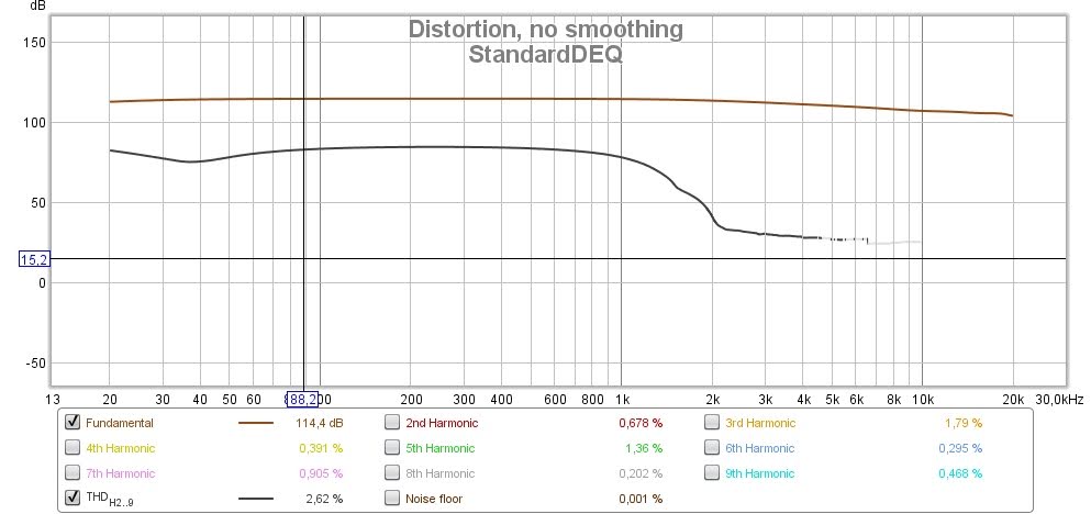

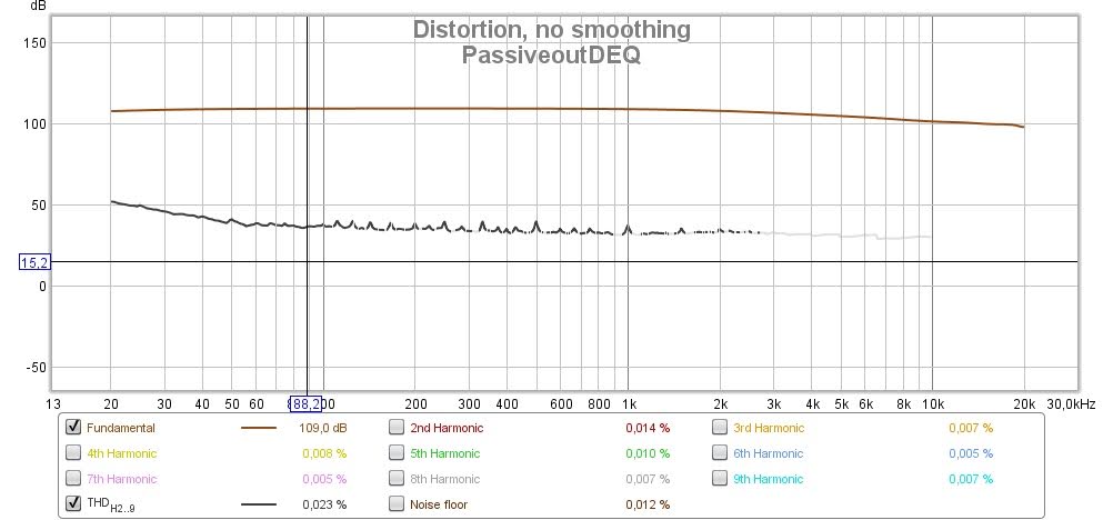

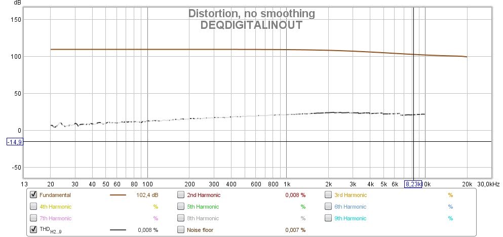

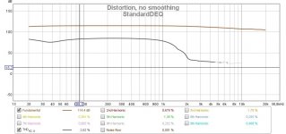

I made a passive out for the DEQ, I have 1 original DEQ and this one, started with measurements, I am not very good at it yet, but got measurements from the analog outs, can it really be that the original has such high THD?
Made the measurements with REW and a Logilink UA0099 USB external soundcard, did it a few times, one DEQ than the other DEQ, the modified one, have a look at the pics, I was surprised....straight through no filters set. Digital in analog out. Pics come in the next reply..have to upload them first...
