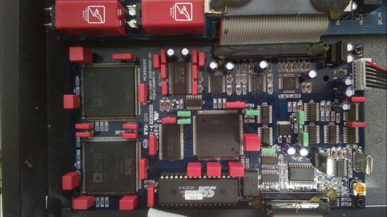

Hi, i want app this mod, look a photo:

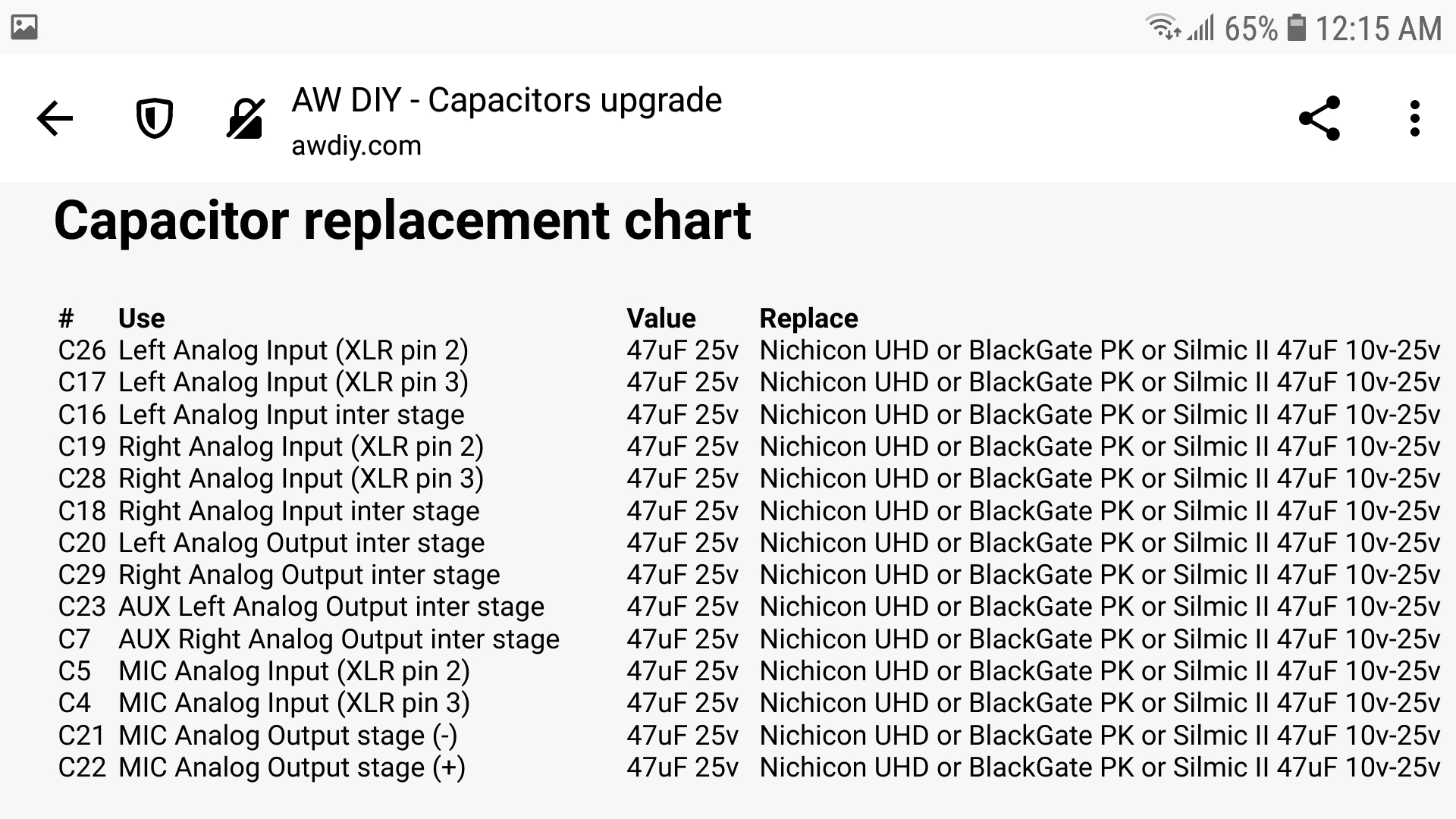

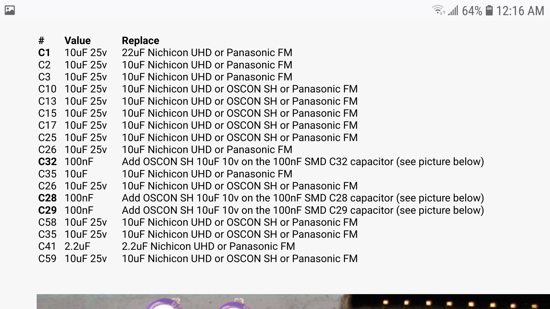

Is there a complete list of values and types of caps to mount? I ask why I see them in various sizes.
Why weren't these types of red caps mounted in the upper right area, I presume wima? Is the image complete then when the work is finished?
I hope for an answer.

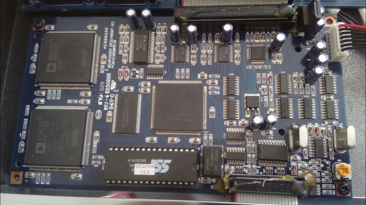

I just ordered another DEQ2496 because I couldn't get the RTA working on the first one. When it arrives I will be replacing all the electrolytics again and will look to see what smaller value caps have been replaced with those red wimas in the photo. They could be mks, mkp, or even mkc. The green ones may likelier be mks polyester but I cannot be certain. The reason that the electrolytics on the upper right haven't been replaced with films is because they are all likely larger than 0.47uf which is the (general) cut-off from going from the larger potted film types to the smaller electrolytic cans.
When I said "top right" I wasn't referring to electrolytics but to SMDs.
Specifically those close to the AK4393, AK4524 and AK4114 (C21, 32, 22, 23, 24, 34, 18, 19, 20, 30, 14, 16)
Below is the photo of my pcb which is best seen.
I want to start with mod from the digital pcb as, for the rest, I still have to decide how and what to do. There are various options ... transformers ... opamp..etc
image for
In my image you will find two caps circled in yellow which are absolutely to be replaced as, being of poor quality (like all the others) they introduce noise. In this 3d you can read about it (post #4):

You may enjoy dealing with SMD. I find it overly tedious. The overuse of these ceramic SMD caps used everywhere in this device is.. unfortunate. I want to upgrade the analog out section but am just going to purchase one of those upgrade kits from behringermods if he still sells them.
https://www.behringermods.com/deq2496.html
If it were me dealing with those annoyingly small SMDs, I'd probably also be soldering some potted films with legs directly to the top of the board. Why not just measure their capacitance or use a magnifying glass to see what values are printed on them so you'll know what sizes you'll need?
That PCB you linked, 6 months ago, they were still selling them. I wrote to him.

I started drawing a map of the ceramic caps.
I have no experience, I am a beginner with datasheets under my eyes and .... guesses.
Besides, English is not my language!
I hope my deq continues to work when I reassemble the card. I don't know if touching all the pins with the tester is good for the dsp ... etc ..
Below what I've done so far:
Link A BIG IMAGE: dav — ImgBB
Where I wrote "TBC" in black or white it means that somehow I have to finish being sure by reading the datasheets better or if someone is an expert .. go ahead!
The caps around the two big dsp should be correct as they are between GND and the various VDD pins of the dsp..which I assume are the power supply pins.
The caps around ak5393 I deduced from the respective datasheet and from some images on the net of a card of a different version than my deq ... which reported the values written on the card.
I reasoned and compared with the datasheet and other information on the net .. and they are certainly fine.
C55 and c44, near the sdram, are between 3.3vdc and GND.
I assume they are 100nF too and have something to do with the ram power supply.
I haven't read the ram datasheet, so I wrote "TBC".
Regarding the DSP in the center of the card:
c67, 39, 54, 47, reading the datasheet, are external capacitors and are between GND and 4 pins of the chip called "VDDINT" (Core Power Supply). It seems that the chip has an internal regulator and that it needs these caps externally.
Given the presumed purpose of the cap .. it is always about power supply ... I assume they are 100nF too.
Wanted dsp chip expert !!!! Help!

.....Always around the chip in the center of the board .... c43, 66, 68 and 42 are between GND and the power supply pins (3.3vdc) of the chip and, reasoning as for the two largest dsp, they will certainly be 100nF too.
As soon as I can, I'll go ahead and see if I understand what the other remaining ones are!
PS: TBC = to be confirmed (obvius!)

You don't want to chance capacitance on your replacements unless its been recommended. I still haven't received my DEQ to verify, as I know there are also larger capacitance power filter electrolytics inside, but for starters, here are two photos which show you what you're working with.
It looks like you'll need 10-20 low noise 10uf 25V caps. Oscons are good, but UHD, UHE, UPW, FM or UKL can also work here. UKL is the low-leakage type, the others are more low ESR. Both types are good for feeding ICs, but not direct audio signal path, in my opinion.
Also, looks like 20 or so 47uf 25V for the analog circuit. This is where you'd want to purchase more audio sounding types. RFS Silmic II and UES Muse bi-polar are both very nice, but are twice as large as every other audio series. UFW, UKW, Elna CE-BP, UKA, UKZ are all fine sounding audio electrolytics.
It appears according to the $50 mod link you posted in the cap upgrade section, the person was adding 10V electrolytics on top of the 100nF caps, of which there are many, perhaps dozens on the DEQ. Without knowing more, this tells me that all those 100nF SMDs may only be rated at 10V (or less possibly) if the modder knew what they were doing. This tells me that those 100nF caps could all be replaced by 100nF 10V equivalents possibly. Order some pps or mkp to replace these. I still don't know why he was bypassing some of them with electrolytics instead of just removing them entirely and just installing electrolytics in that particular section of 100nF caps.

Even if I haven't finished "mapping" the caps of the (digital) card yet, today I reassembled the deq ... connected ... and to my amazement it still works perfectly !! yuhhuuu !!
Yesterday I poked him everywhere for hours .. with the multimeter! hahah
Tomorrow or the day after tomorrow I take the card off the deq again and try to go ahead and finish figuring out the capacitors.
The voltage values of all the tiny ceramics are low, they work on 3.3v or on 5v.
10v to mount are also enough.
Today with the deq access and sounding I checked with the multimeter what voltages were in all the remaining ceramics.
Useful clues to understand, together with the datasheets, what function the caps perform!

For the moment, as I am mainly and initially dealing with the digital card I am looking at what cap options there are. What you mentioned are on my guess list. There are also the panasonic FRs which boast super ultra-low esr almost on par with the oscons. Then there are alternatives to oscon (always polymers) from other brands such as kemet..etc..same specifications.

Thanks for the 2 images, I already knew that site where you got them from! they are part of the documents that will help us to make the super recap.
