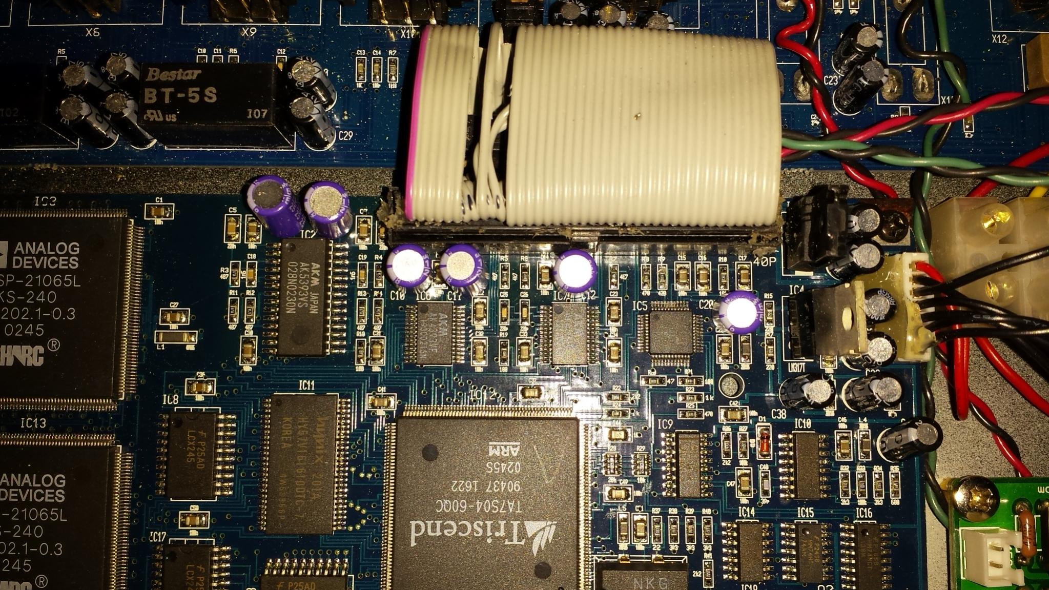

Just wondering if I could get some guidance as to optimum placement of some high end caps on the main board with the DAC. I'm going transformer direct out so giving the dac chip as much love as possible is job one. I also have the older version board.
Here are the options:
Black Gate NX series HI-Q 22u 6.3v ** Only have 2 **
Oscon 47uf and 180uf
and
Elna Simlic II and Panasonic FC all values on hand...
My primary goal is placing the right cap on the correct location based on qualities of each cap.
and
PETEFRONTIERS I'm using R7 top side closest to the connector as spdif input.
Thanks for telling the location for the spdif input. I will try it.
For the caps on the main board, You should change C2, C3, C10, C11 and C20. These caps are filtering the voltage feeding critical chips. I went with 15 uF - 25V Oscon caps but you can put what fits in if they are better than original 10 uF caps

Sorry I missed this one. I would steer clear of the Blackgate caps, they don't have low ESR at higher frequencies. I don't think they are suited for digital or Class-D circuits.Just wondering if I could get some guidance as to optimum placement of some high end caps on the main board with the DAC.
The Oscons should be fine. I use Panasonic FM series caps which are well suited to this use. Don't remember what values I've used, but about triple what was in there but same lead spacing. Seemed to help dynamics. Definitely put them on the analog power pins.
You can use them near the voltage regulators, too. 5V analog is the place to start.

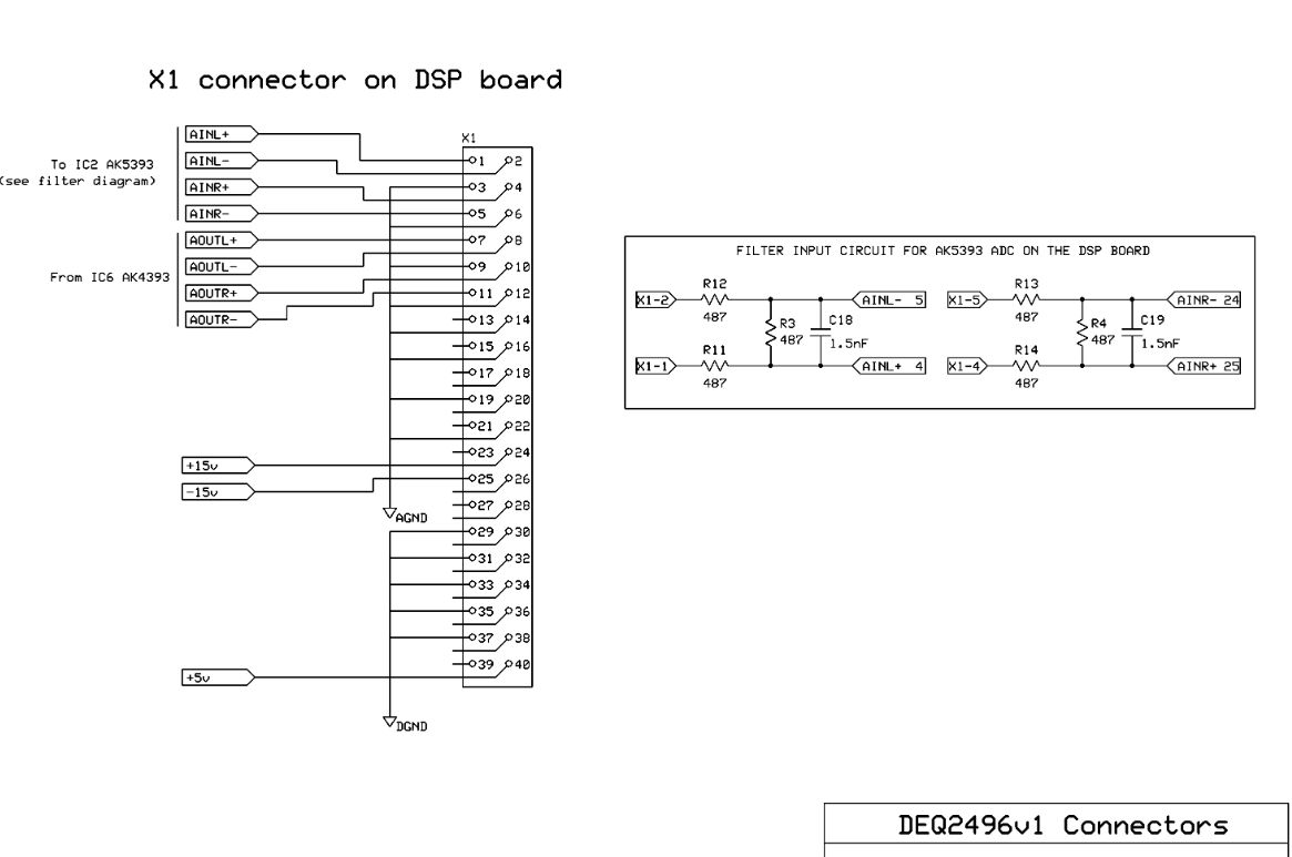

Hi all,
I need the main connector pinout if someone has it I would appreciate a copy,
I am wanting to go digital in ,I have a board that has usb in and I2s out,but the standard aes will do, I just don't know the correct pins to use and I also would like to have the mike input for RTA,
I also need the digital out pins of the DEQ to connect to the input pins 1and 2 on a dcx.
Any help is appreciated!!
Thanks,
NS
Thanks,
NS
Hi Pano,
Yes the biggest one X1 ,But I looked at the data sheet for ak4114 and it has a spdif in and out pins, I hope to try those locations and see if it works as planed,I found stef had found some of the pins but not all in this thread.
I would like to find the digital in and out circuits, I would like to connect the digi out of the DEQ to the DCX digi in,I do not want any XLR connectors or cables just a twisted pair if the levels are close enough.
I want to retain the RTA mike in, I can make a preamp ,but need pin #'s.
