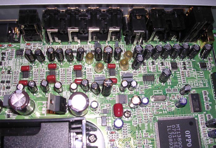

Oppo DV-983
I was just looking at a picture of the audio section in the new Oppo.
http://www.prillaman.net/image/oppo983_int05.jpg
Anyone get their hands on one of these yet? I would like to see some better pics.
It has a different DAC chip from the other Oppos. The CS4361.
The CS4361 is a TSSOP-20 with pins on 0.65mm centers, so it may be easier to solder wires onto this part compared to the other Oppos.
