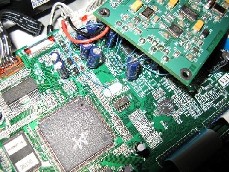

I have opened up my OPPO 970 and certainly agree with your assesment of MT1389 DVD controller pin spacing being far to close to attempt soldering.
But, I was curious if you or anyone else had considered looking at tapping off the digital signals near the input of the CS4360 DAC instead (Assuming that there aren't problematic signal modifying components in the path)?
I have found three small "circle pad holes" with better soldering spacing for the SCLK, LRCK and MCLK inputs for the CS4360.

The CS4360 has SDIN1 on pin 2, SDIN2 on pin 3, SDIN3 on pin 4. Those correlate with the 1, 2, and 3 pairs of single ended outputs .
The Oppo 981 uses SDIN1 as the front speakers and the other two for the rear, center and sub. I use the SDIN1 in the ASRC mod. It has been a long time since I looked at the 970, but I am pretty sure that the 970 has mapped them differently. It may be that 3 is the front. To figure out which one is the front, trace the signals back from the rear panel rca jack to the outputs.
You might have to scrape off some of the green solder mask and expose bare copper in order to solder to those plated through vias. There is mask down in those holes and that makes it hard to solder to them. That is probably a better plan than trying to solder to the IC pins.
If you trace out the data and clocks from the MT1389 to the CS4360 you will also find some very small resistors on the lines.
I have tried to solder to these resistors and it is very difficult also. It sounds like it would be a simple task, heat up one end of a resistor, poke a wire in to the molten solder and then let it cool. That is not what happens. The parts are so small that both ends of the resistor melt and the resistor moves off the pads when you poke the wire to it. Either that or the resistor comes off completely and sticks to the soldering iron and it burns up into nothingness.

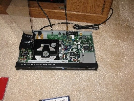

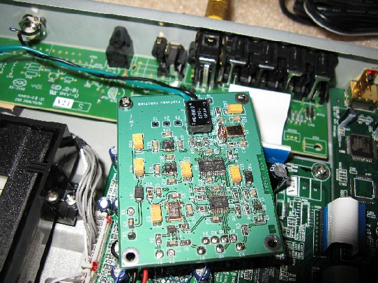

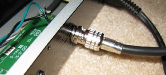

Sorry for the belated update, and for interrupting the current discussion, but I believe my Oppo is working now. After resoldering the clock signal wires to the Oppo board, I haven't had the persistent lock-ups I was before. I'm getting digital output from CD, SACD, and DVD discs.
I've attached a couple pics of the Oppo with the new board...
Ted
Ted
