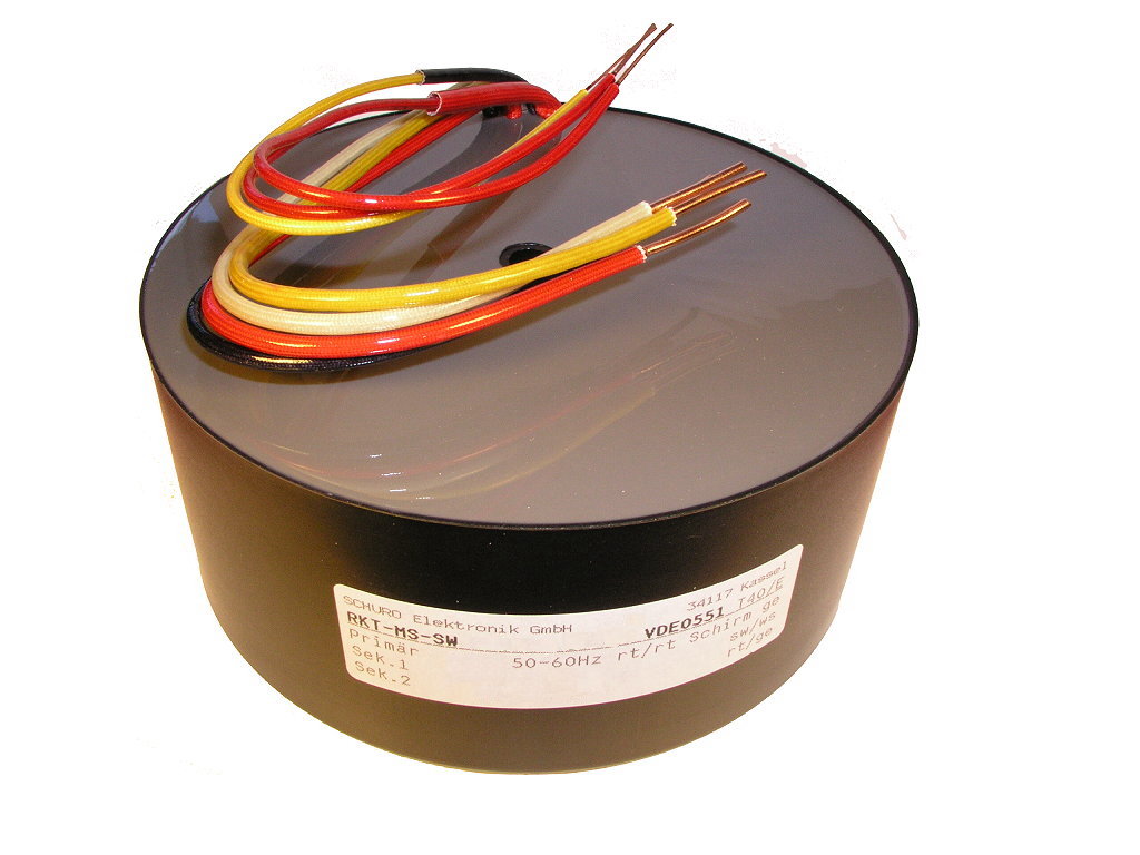

For a good 2 x35Vac/600VA potted audio transformer look here
https://www.hifituning24.de/transformatoren/ringkern_vergossen_v-rkt-ms-sw/600va-2x35v.php
Dass ist einer sehr guten preis.
Thanks for the writeup on smps vs classic psu. Have you any experience with or interest in trying the Connexelectronic SMPS500 or bigger? They look neat and Christi seems to know what he is doing. He also has several capacitor modules to give the smps a bit more grunt for subwoofer duties etc But whether they can sustain a high bias class A I don't know.... "Bass quality" in most cases it will just be fine with the SMPS1200A400, but i think there is a little improvement here to my ears by using classic supply. ...
I've the 340VA version at my home
