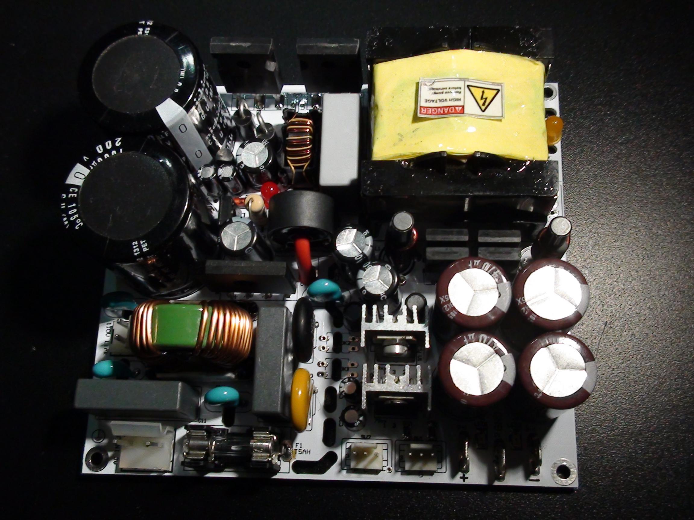

SMPS1200-400 is not the best or the ultimate SMPS for such amplifier, or in general for AB or Mosfet amplifiers. people fooled with the synchronous rectifier technology claimed, as I believe that they best serving the Class-D amplifiers mainly.
Synchronous rectifier is good to improve the SMPS efficiency, Switching at higher frequencies, (Littel bit LOWER ripple), Smaller output capacitors. but that doesn't mean its the best design / combination for Class-AB or Mosfet amplifiers nor it will give the same performance as linear PSU.
You the second person who just noticed the same thing using that SMPS with Mosfet amplifier.
Hope that helps
Do you have experience with the fact it works better with class a or ab amps than the smps1200-400?
Many tests were conducted at AB amplifier and a Mosfet amplifier, and the sound was just perfect, deep bass. its very difficult to anticipate the results at your amplifier.
From my experience and analysis, witch is proven by three persons here, they noticed (let say) a cut off somewhere in the low frequency band.
I could offer you a SMPS to test at your gears, I am going to give you a very good deal, Just To Test! If you are interested.
