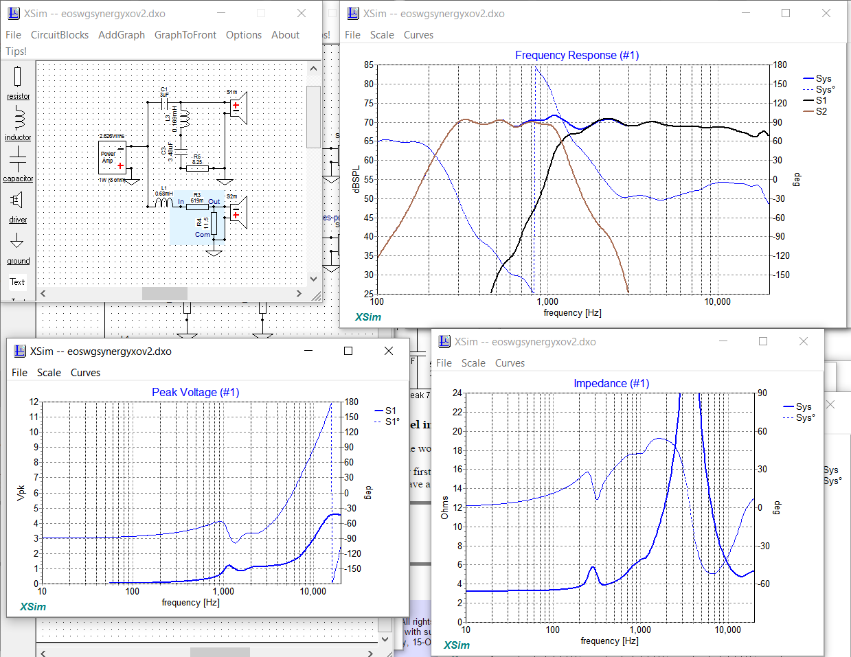

Here's another go. I thought it was pretty cool (on the one that I posted last night) that I could tweak the 1st order hpf cap with a resistor across. Never bothered to look at voltage as bwaslo pointed out. No free lunch as usual. How's this? Is the massive impedance peak at 4khz anything to worry about? I put in a compensation circuit before the hpf but it had no effect on the transfer function....only the impedance so I took it out.

That's a pretty nice result for passives and your first attempt (quite a simple xo as parts counts go). Your mini synergy horn has the capability to be transient perfect and minimum flat phase if you put the ports at the right place and tweak the XO like Bwaslo did on his Cosyne.
I admit, playing around with XO sims can be kind of addictive. It's like a video game - trying to eek out the highest score with the flattest response and lowest parts count

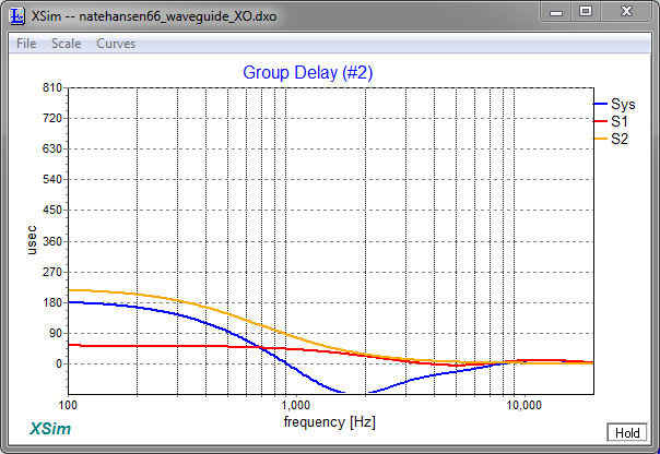

Could be wrong worry about this but if fire your schematic into textbook linear 8 ohm driver to model your tweeter and textbook linear 2,66 ohm driver to model your injection ports get below group delays, yellow is injection ports red is tweeter and blue is system. Know scale is uS but at higher frq they mean something relative to periodT, so if target is for waveguide as to work as a perfect optimated point source think would investigate if any strange wrigles turn up in live measurements at uS scale under group delay.

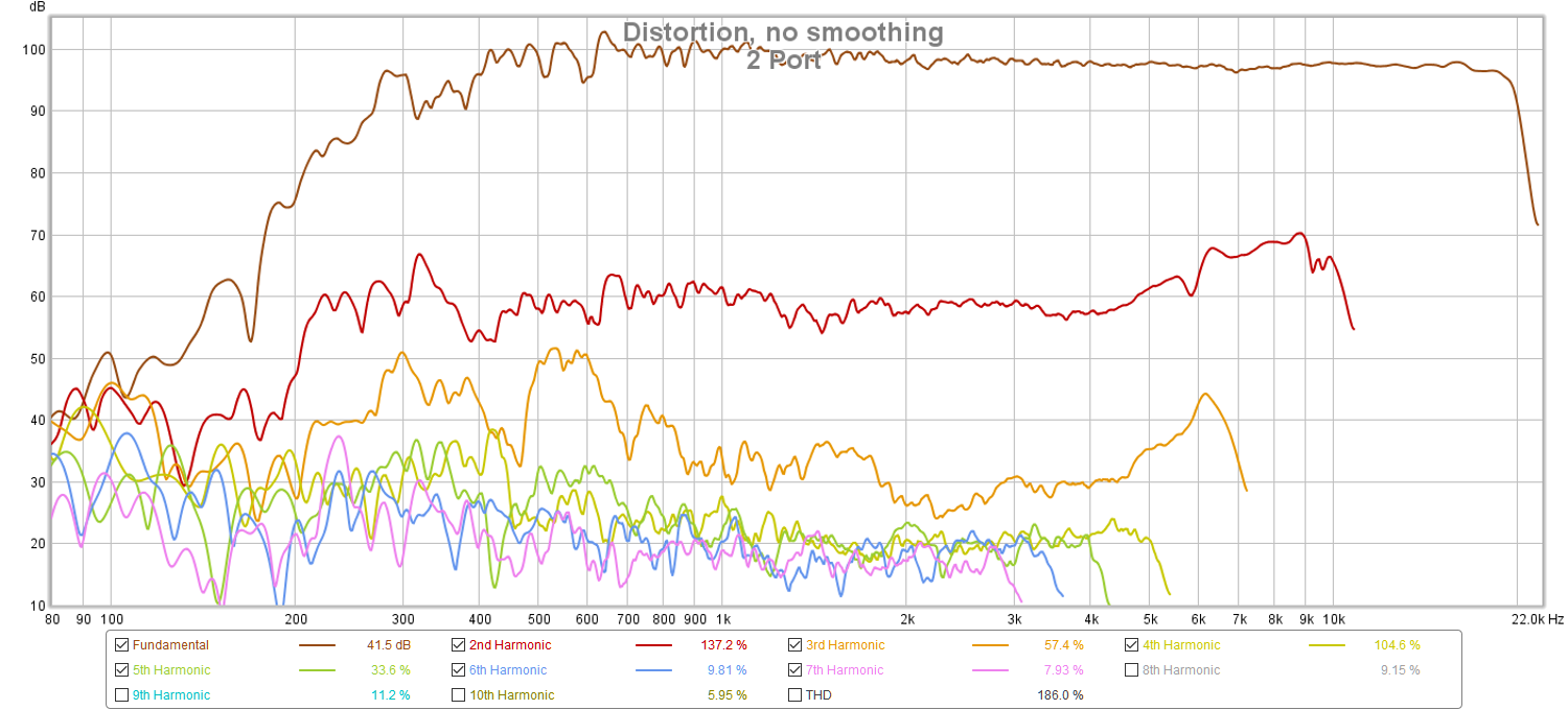

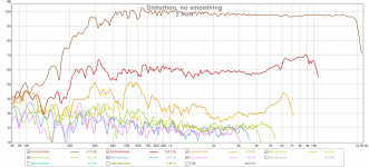

I've been getting data the last couple days, comparing 2 ports per driver vs 1 large port. There are two 4" closed back mids per horn. I'll attach pics of the ports......the velcro on the wg holds foam plugs in place. The port center of the two port/driver version is 1.4" from the CD throat and the one port/driver version is 1.5" from the throat. I tried to make the area of the 2 ports/driver version equal to the area of the single port but it is slightly larger for the 2 port version.
I have detailed polars of both but I'm seeing some issues with mid distortion on the 2 port version that I can't reconcile. I'll post that data next when I get back on my PC.

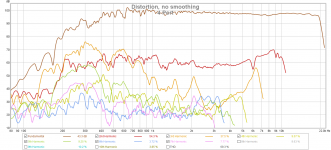

Here is the distortion data take at 42" away from the wg mouth at about 100dB. These were taken back to back. I'm not sure what to make of the distortion on the mid in the 4 port version. I noticed that yesterday when I was getting the polar data. I removed the mids and noticed the t-nuts that I was using to mount the drivers were sticking up over the mounting plate a bit. I filed those down and made sure the mounting surface was nice and clean. I also added some gasket tape. There is plumbers putty in the mid chamber to take up some volume but that does not protrude above the driver mount plate in any way. I reattached the drivers and took the measurements that you see back to back. I'm not really sure what to make of this........I have more of these mids on hand I'm going to try some different drivers.

How can the mid be flat on to 20 with no sign of breakup? I'd expect breakup here we see the distortion peaks

nc535 - yes that's the system response with the cd. The goofy distortion on the 4 port version is isolated to the mid driver.

Nate -- on the midrange distortion: Be really careful to make sure that the surface the midranges get bolted to is very flat. It doesn't take much warp to make the voice coils rub and the cone surrounds to get jacked out of shape. I had a bad distortion problem on my recent horns (audible, didn't even need to measure it), was from a bump on the seam where the mids sit.
