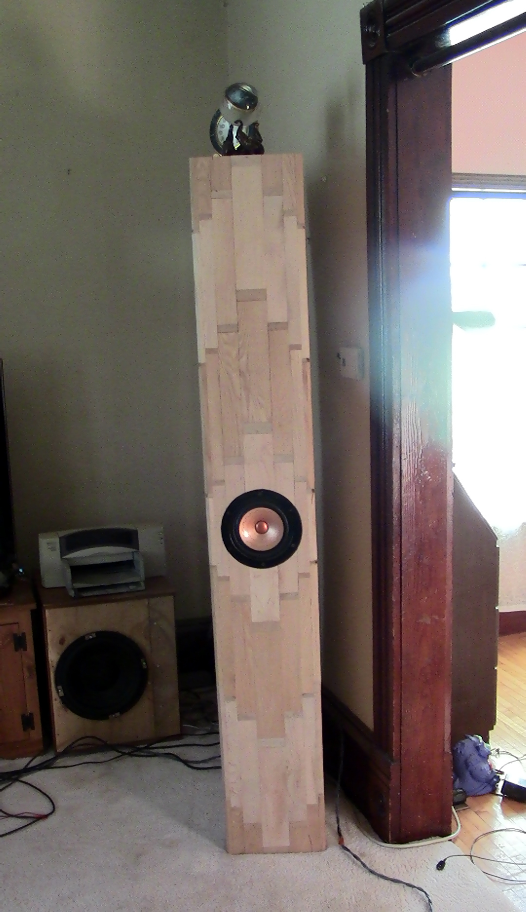

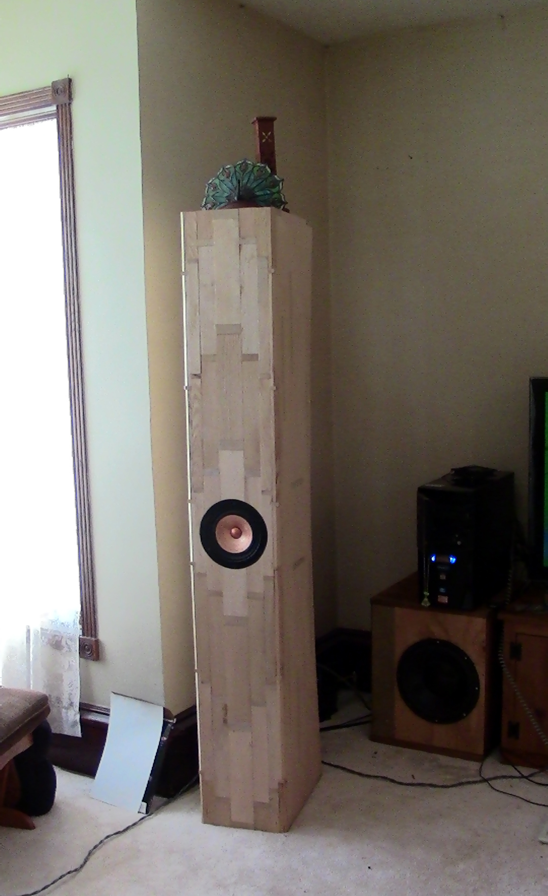

I got the front mosaics to the Aveburys done a year and half ago. I still have a lot of sanding to do on them before I would consider them completed. As it stands now, I will be making a similar mosaic on the back and cutting six inch wide strips 1/4 inch thick of black and white ash for the sides. I have looked into veneer, but the stuff I have access to is pretty thin and low quality. The hardwood Ash I got was a trade for a computer build I did for a friend, so the price was right.

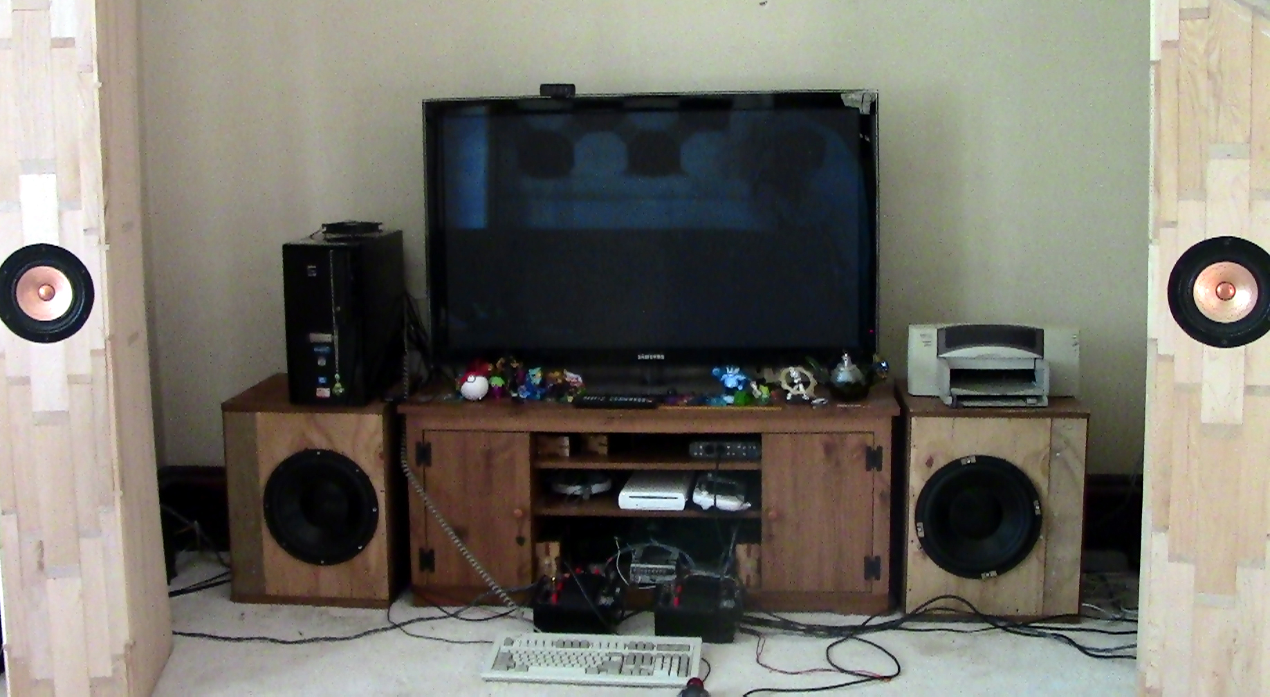

Currently, I am using Avebury in a FAst 4.2 system. The Avebury are the main left and right. The Cheap and Cheerful arrays are back left and right. And I have a pair of Dayton HF 12" subs in experimental 3 cubic foot cabinets
for bass. I am running the system through my on-board computer Realtek Audio card, mainly, as I can run Dolby Digital and DTS soundtracks. I have upgraded my CPU, Graphics Card and now run all software and music off a Solid State hard drive. This all made a significant improvement in the sound (and video) quality in regards to micro details, timing and dynamics, despite the inferior DACs. With the current DACs, it is a toss up. The Realtek offers up to 7.1 channels, where as my M-Audio is over all better, but stereo only. I have acquired a Twisted Pair Buffalo III kit, but I have not assembled yet. I am thinking of making that into a four channel DAC with a MiniSharc DSP board for cross-over and EQ control with a USB controller, so I can run multi-channel from my PC. There is still a lot of design work to consider before building the Buffalo.
Anyway, as it stands, Avebury has a high-pass 12dB/octave cross-over at 80 Hz and the Subs handle 80 Hz on down to 22 Hz in room. Like I say, the M-Audio DAC has a more "resolved" sound and is not as forward as the Realtek, but as the Avebury is no longer asked to do the Sub-sonic stuff, so the mid-range has a tad bit more presence. There is also a lot more headroom. I can pretty much play this set-up as loud as I want. There are only a couple of songs I have that clip the amps with intense mid-range attacks. On the most part, I have to be careful, as for most source material, it is easy to play too loud, as loud is CLEAR. I think I have always associated too loud with distortion, but this is not the case with this system.
All and all, I still prefer the "presence", scale, and encompassing sound of arrays, BUT, there is a "magic" to the layers and layers of dynamics the Alpair 12 possesses. And this will only get better with the Buffalo DAC. Really, the short coming of the Avebury, at least for the sonic bliss I am seeking, it is not an array. My goal is to have the Alpair 12 sound in an array format. May as well Dream Big. ;)
I really like using the subs with Avebury. There is a slight integration hiccup using the subs verses running full-range. I am sure this is caused by the timing between the rear horns and the front-firing subs, BUT this is a compromise that I am personally willing to take. The Alpair is allowed to do what it does best with no IM Distortion what so ever. If you are listening to Jazz trios, then by all mains, run Avebury full-range, but when watching Star Trek, it is time to fire up the subs! I think the bass with the subs is more "relaxed", effortless and lower. Once and a while there is an ill-defined bass rift due to the above integration hiccup, but this is only noticeable with some music. For movies, the subs are the way to go, hands down.
The funny thing about the subs, is I am building them for my brother. He has a dedicated Home Cinema room in his house in Dallas, Texas. I am refining my 777 open baffle system for his mains. I will also by taking the Aveburys down to audition in his room. I am thinking he might like the Avebury in the front with the open baffles in the back for surrounds. It is going to be interesting comparing the two when they are both finished. Thankfully, it is going to be awhile before I can pull away from my new career to deliver and set-up his system in Dallas. So I will get plenty to playtime yet. :D And even if the whole rig ends up with him, I can fund my upcoming array build, maybe with something like a Fostex FF85w. I think having 25 FF85w's per cabinet would be the cats meow. Either way, it is a win, win.

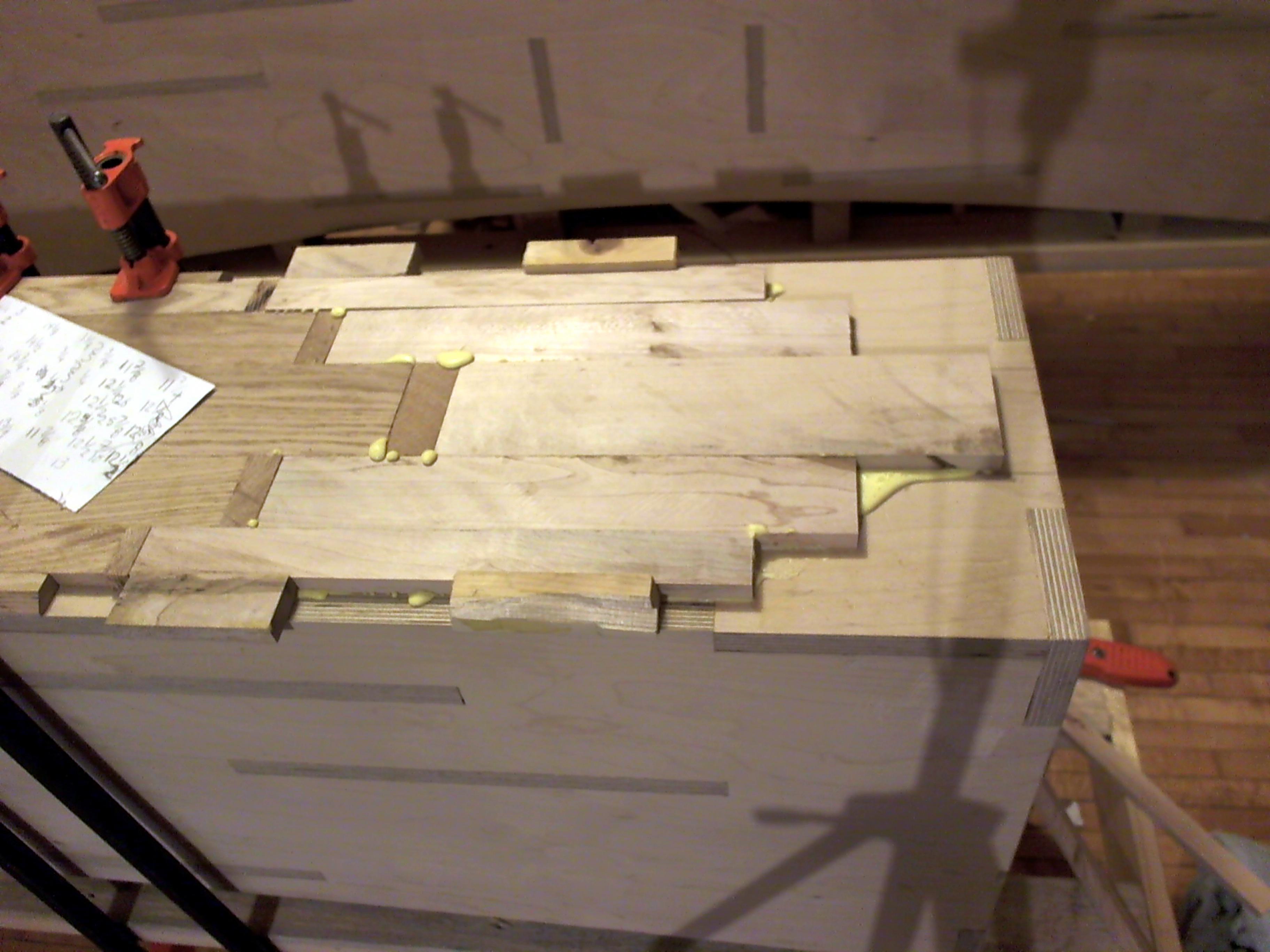

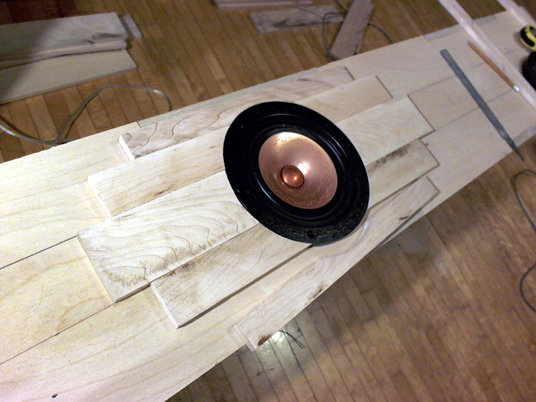

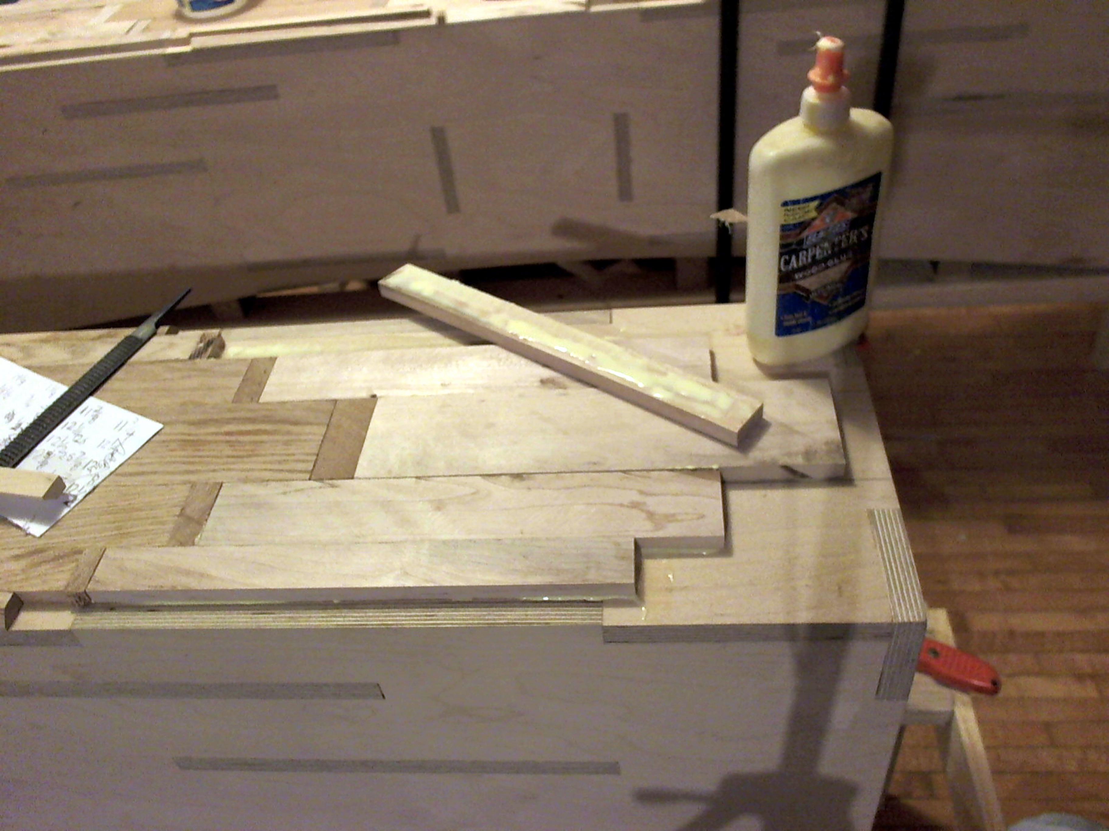

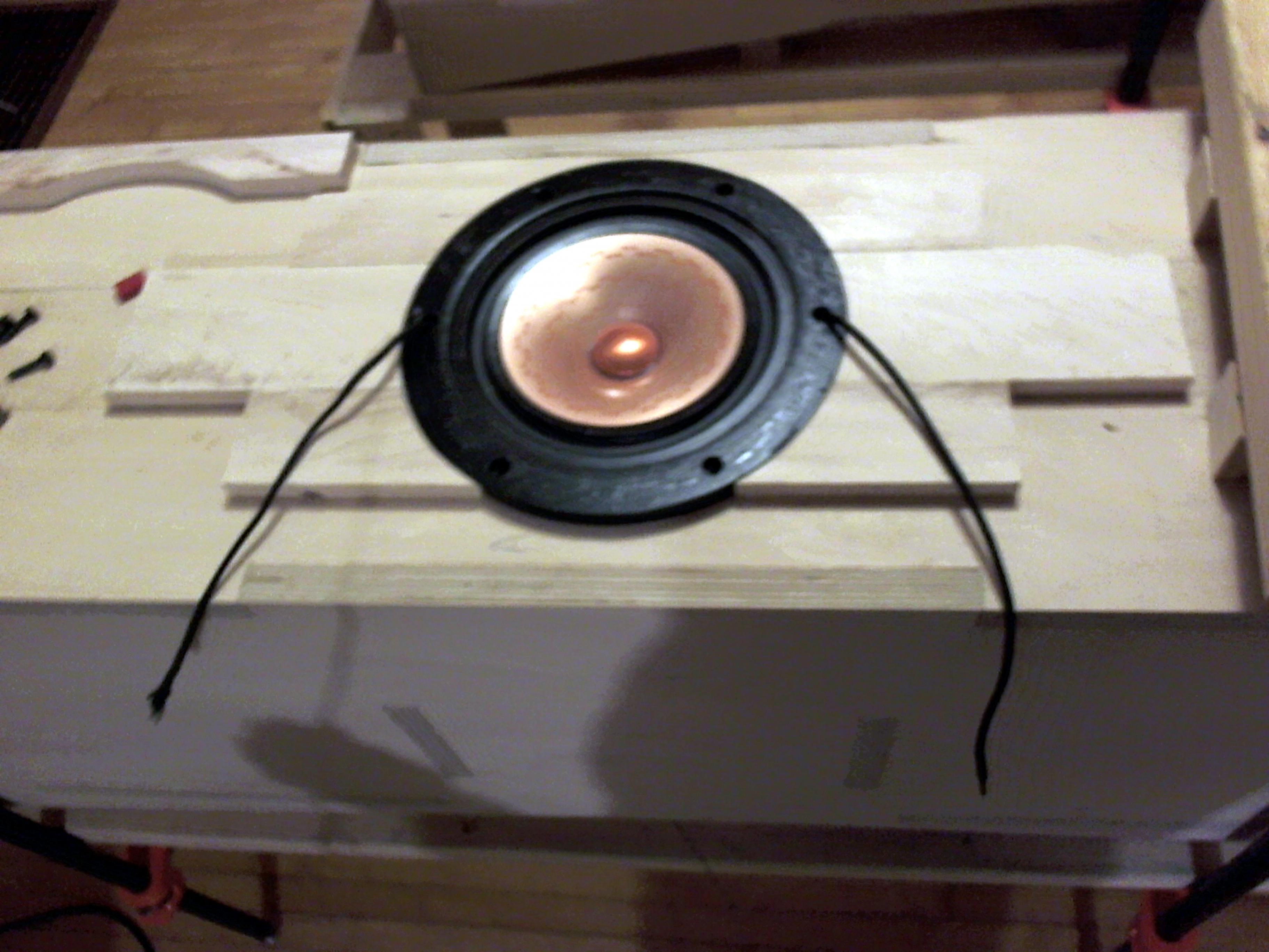

Begining the Mosaic

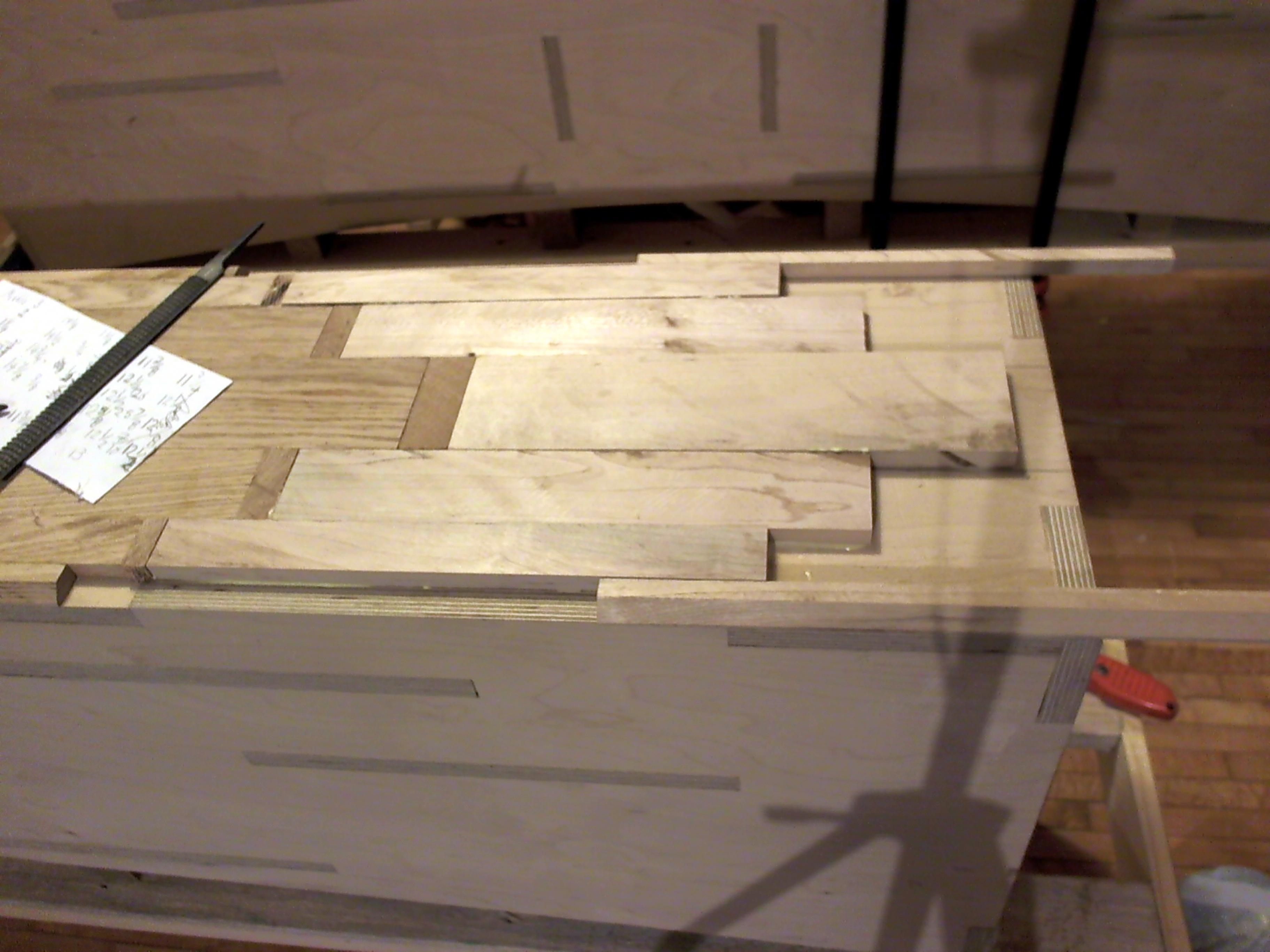

Here is how I went about the mosaics.
I first cut the arcs out of the pieces to fit around the Alpair. I used a shoe lace so I could remove the Alpair without taking the Avebury cabinets off the clamping stands. Note that I cut the oak pieces to the thickness of the Alpair bezel, now making it flush. This was a very labor intensive method of rebating the driver, but I like the aesthetics...

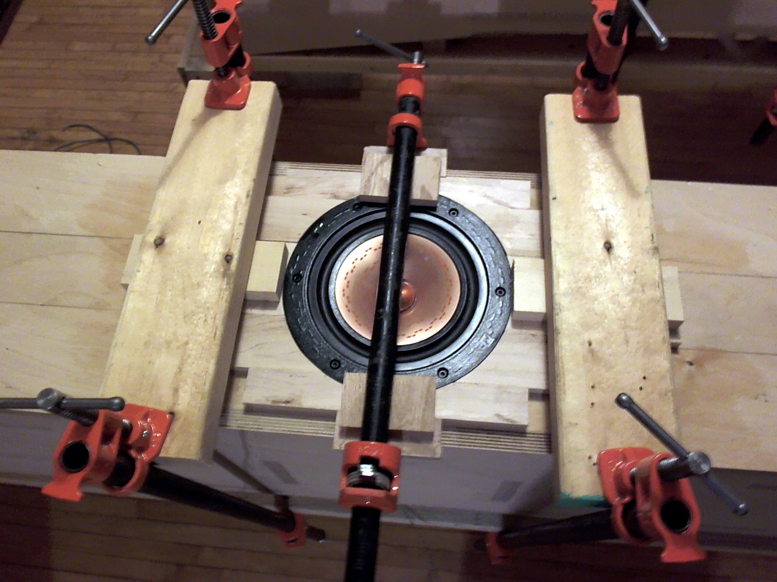

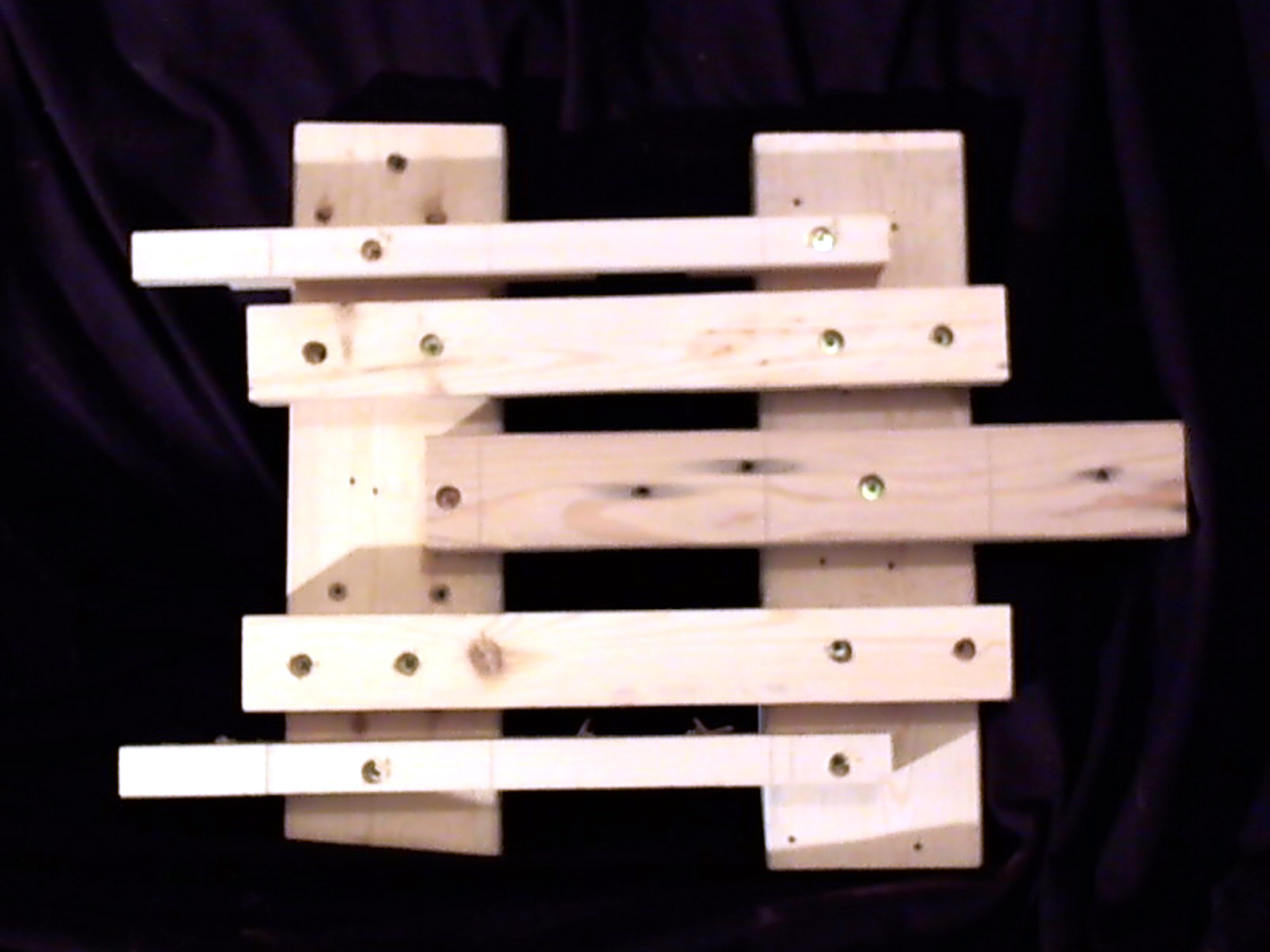

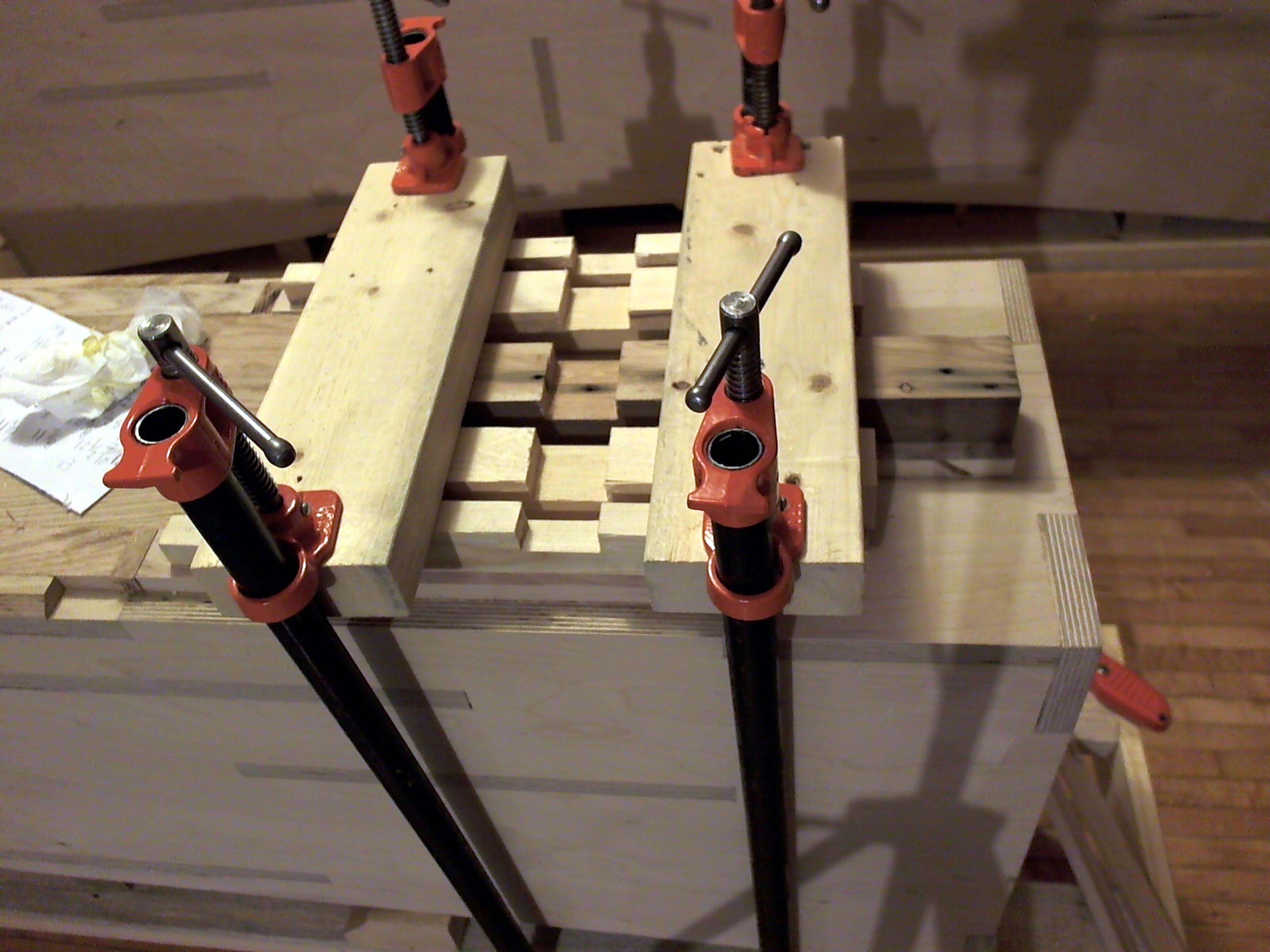

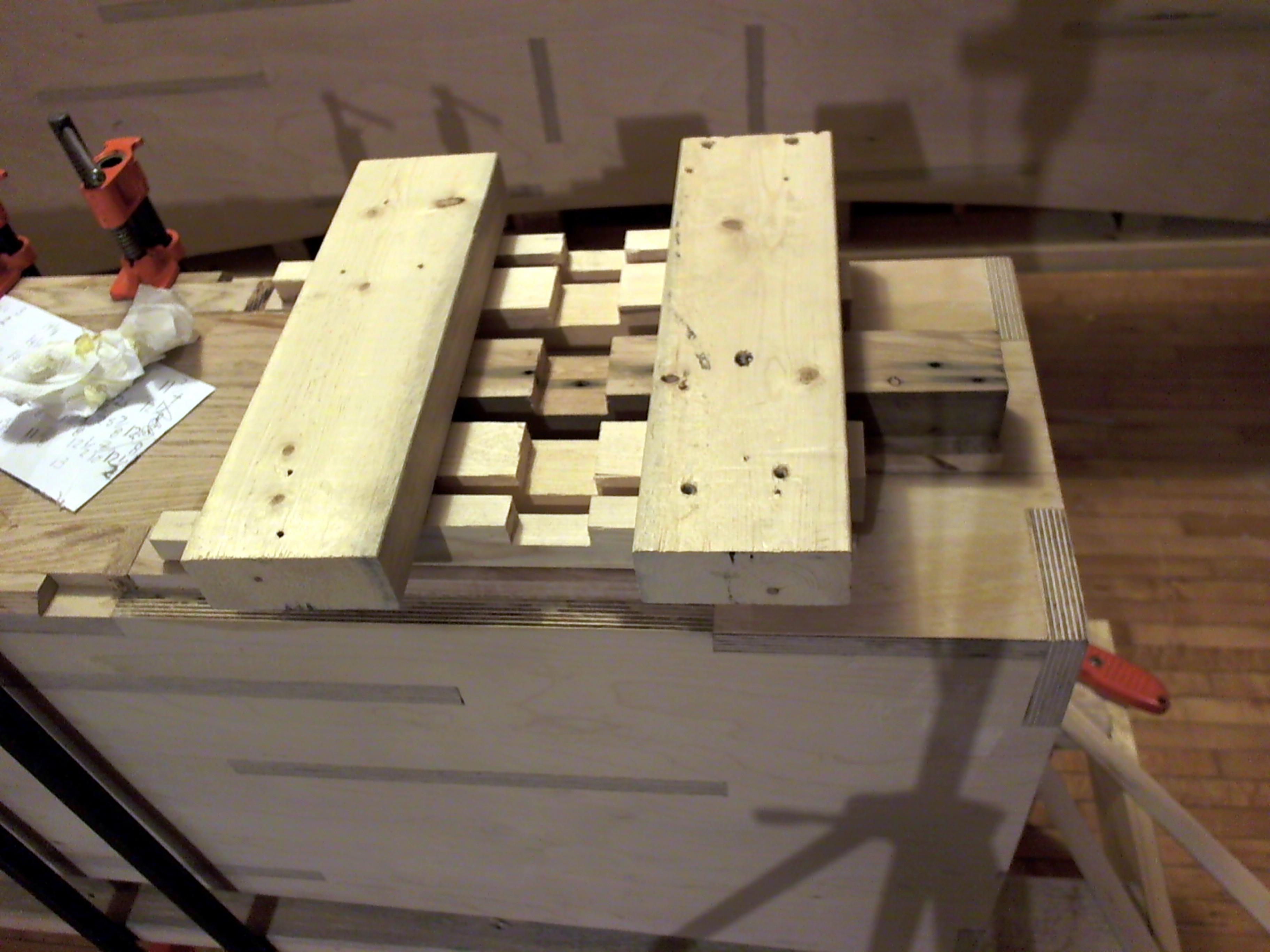

Gluing jig...
For the remaining tiers of the mosaic, I created this gluing jig. If you have ever glued wide pieces of wood with pipe clamps, You may have noticed that the middle of your board can "bow" in the middle, therefore not gluing flat and tight in the middle. To solve this problem, I varied the thickness of the contact boards, making the middle board the thickest and each successive board a little thinner towards the outer edges. So when the cross member boards bows, due to bearing the pressure of the clamps; the contact boards would be fully engaged to their respective pieces, ensuring a tight fit...
This is clear as mud I am sure. If any one wants more information on what I am trying to explain here, let me know, and maybe I can draw something up that would illustrate this better. ;)
Glue Steps 1-4

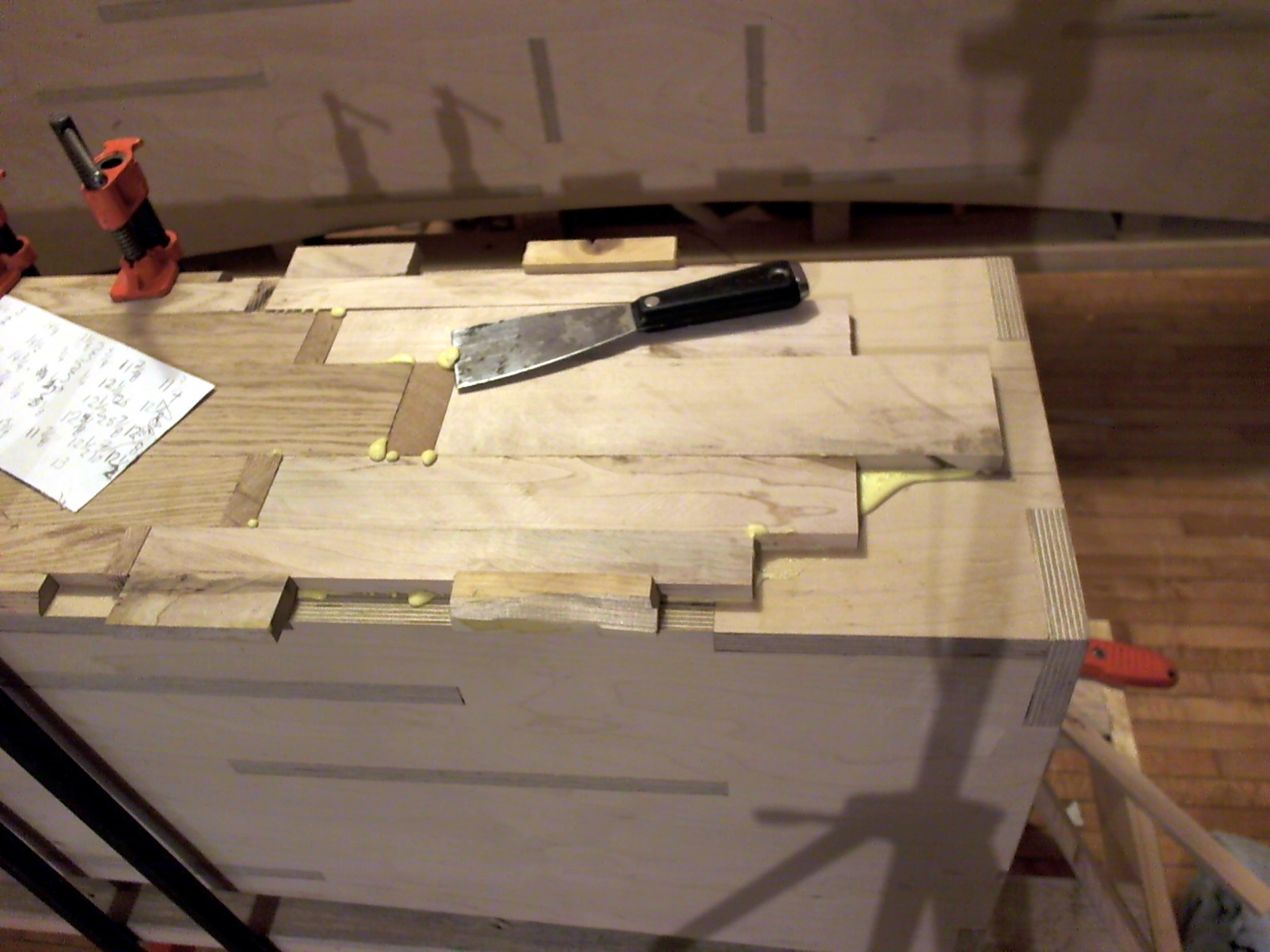

These next photo groupings show the steps in detail I took to glue each tier down. These first four are dry fitting, applying the glue, aligning the jig and installing the first clamps...

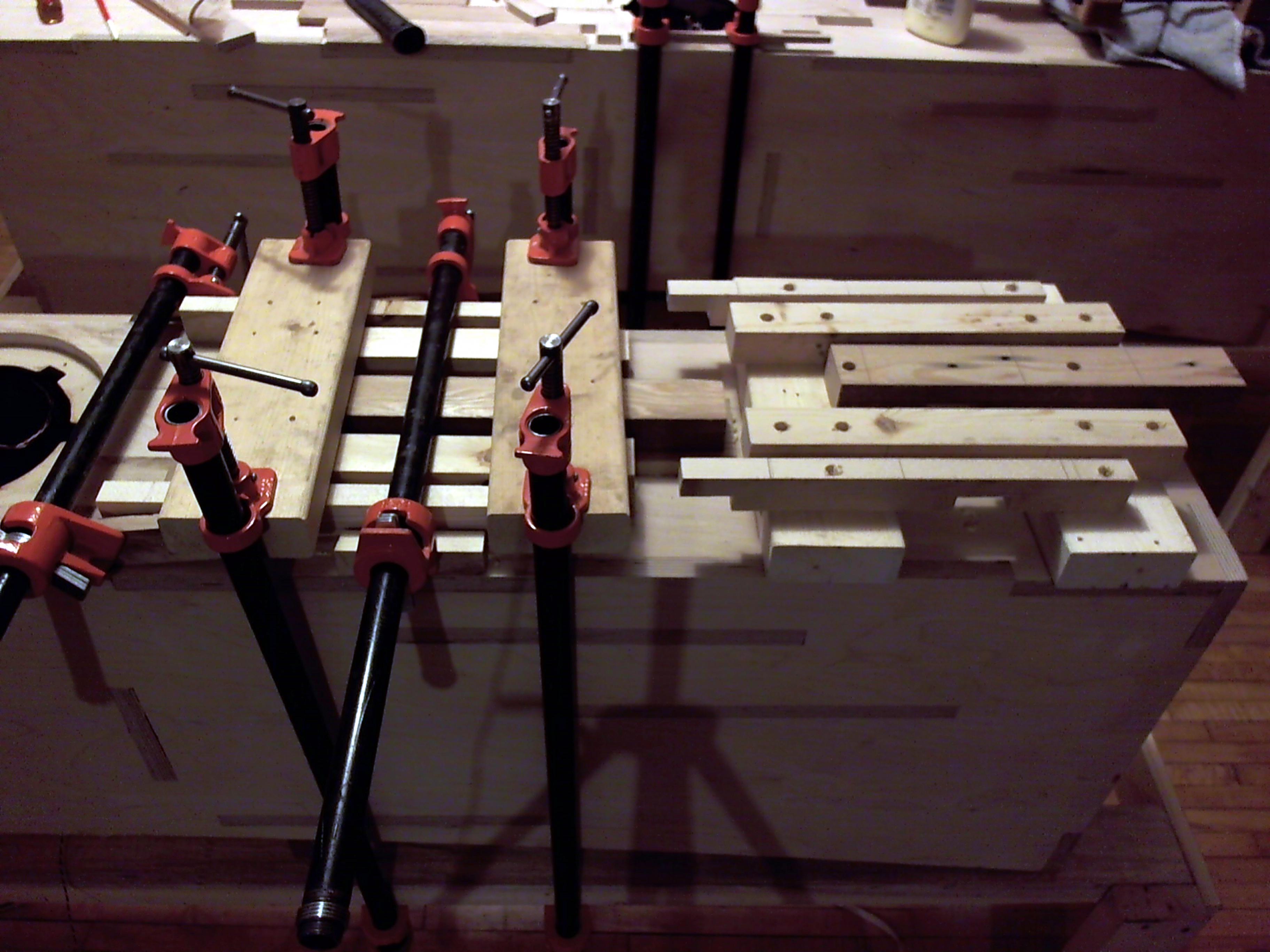

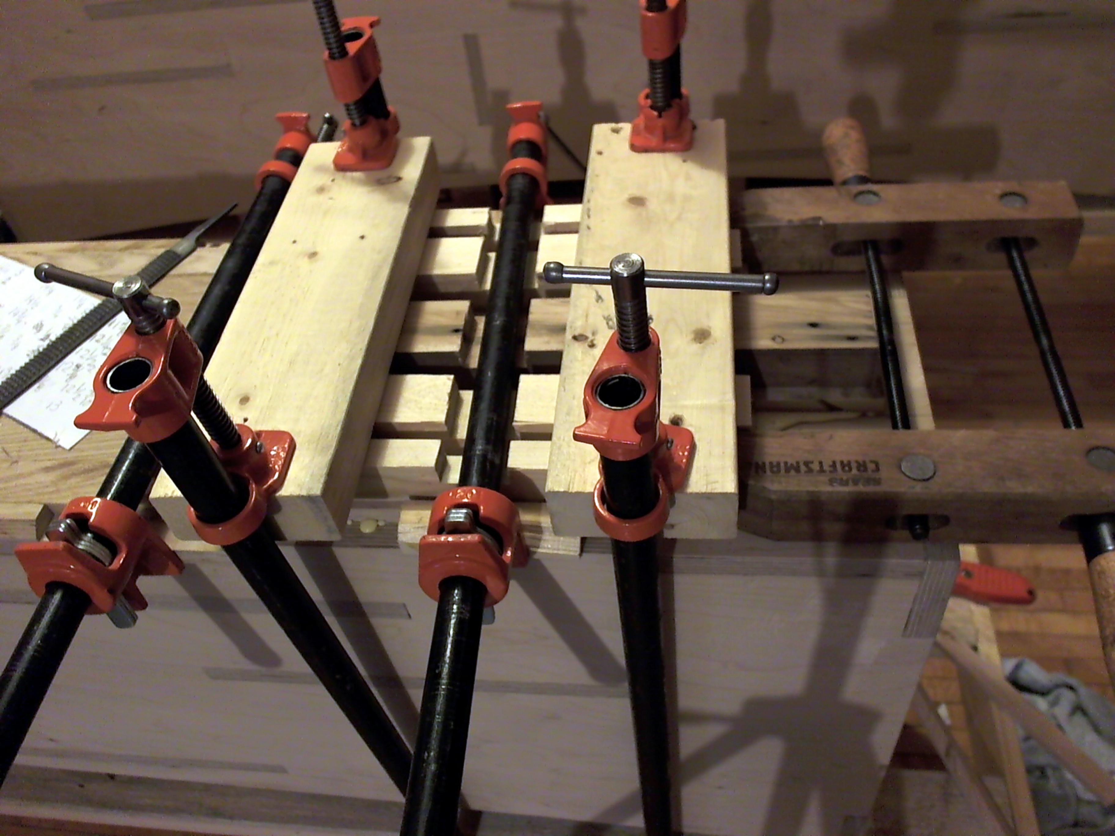

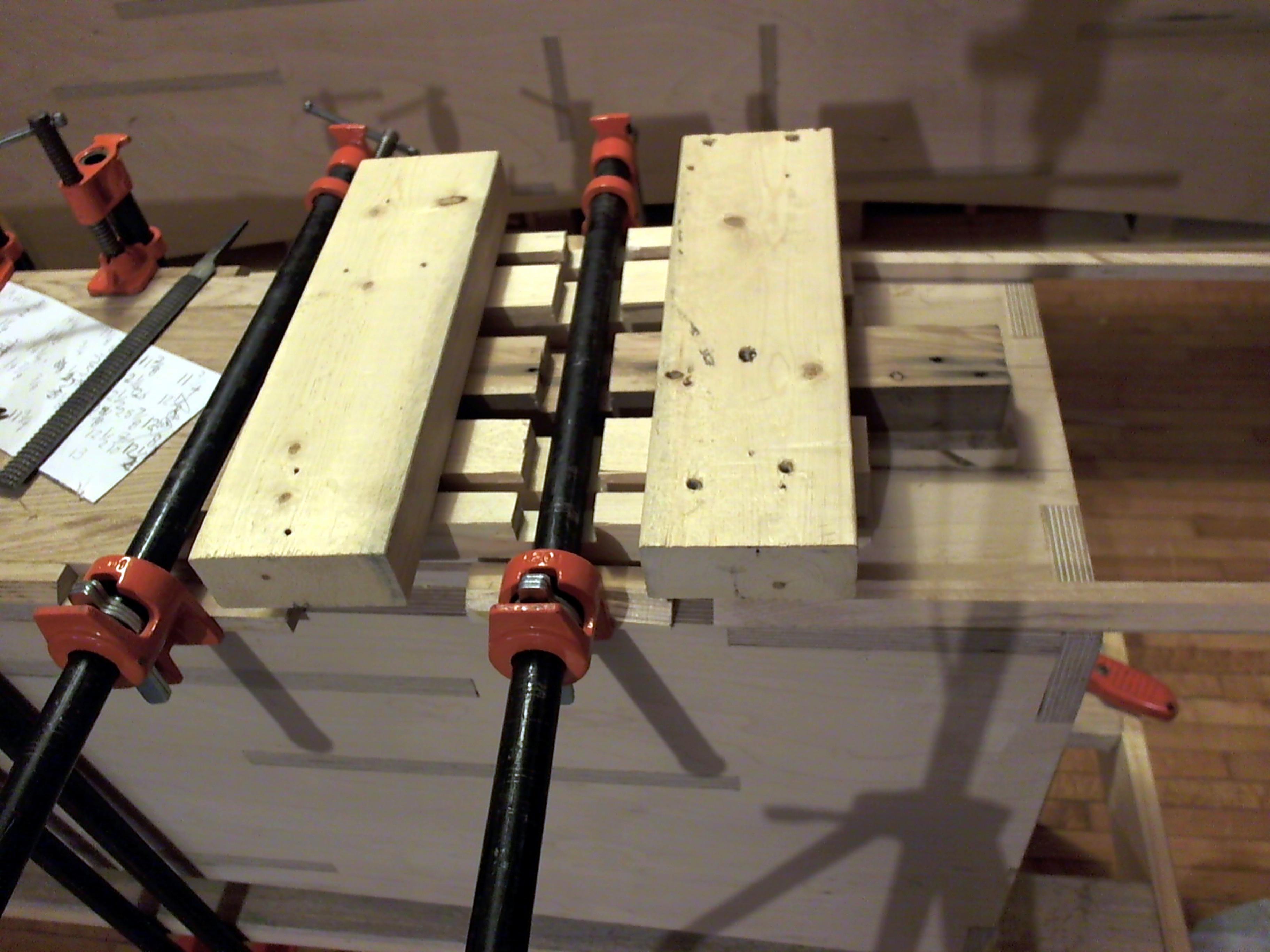

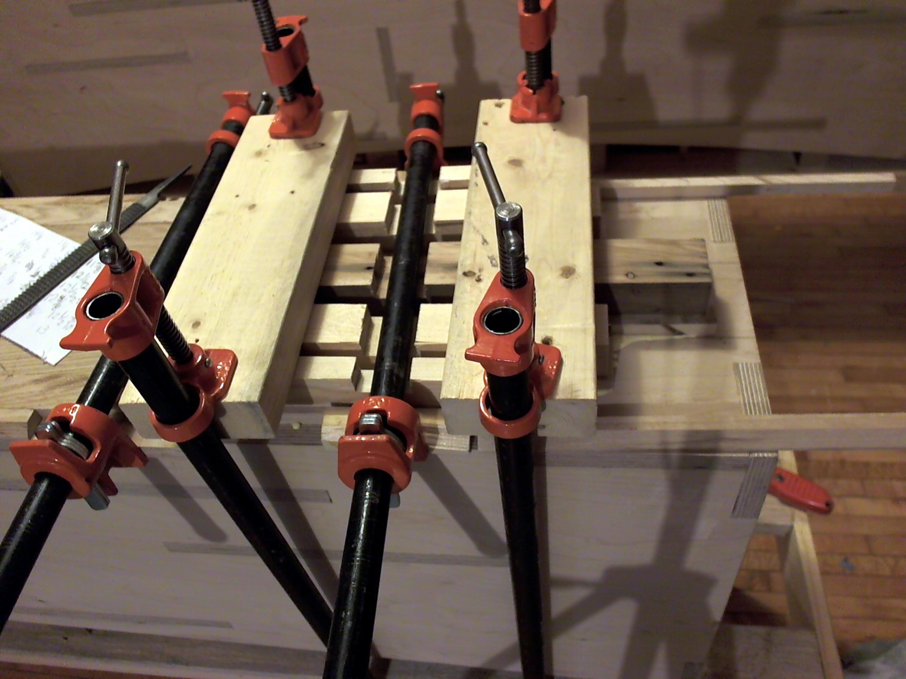

Gluing steps 5-8
Step 4 above shows that the first order of clamping is making sure the pieces are staying in alignment and snug. Step 5 is the clamping for the downward pressure of gluing the mosaic tier to the cabinet. Step 6 applies more side pressure to prevent the individual pieces from separating. I then waited about 20 minutes for the glue to form that initial bond. I would then remove all the clamps and jig (step 7) and start cleaning excess glue (step 8)...

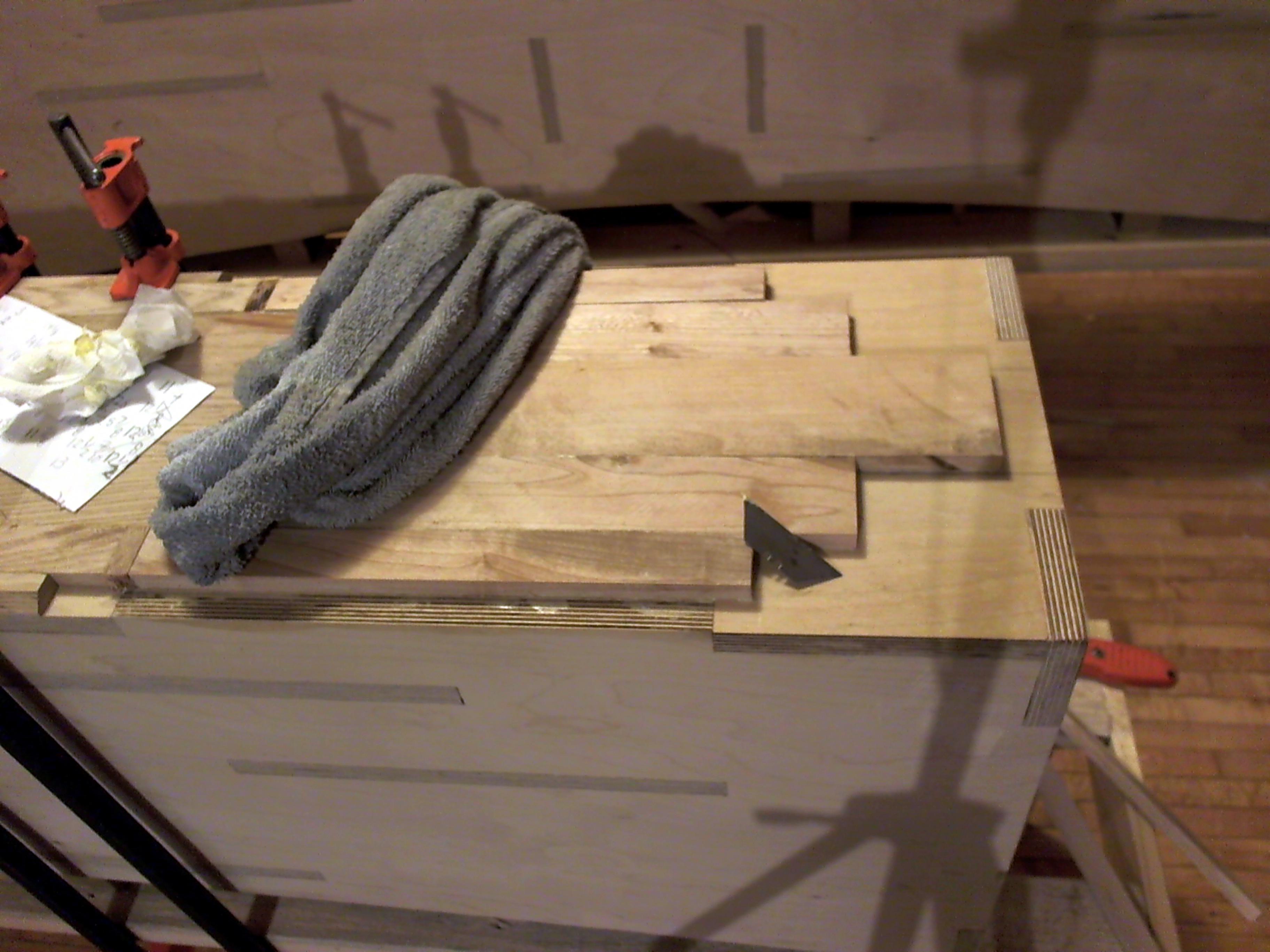

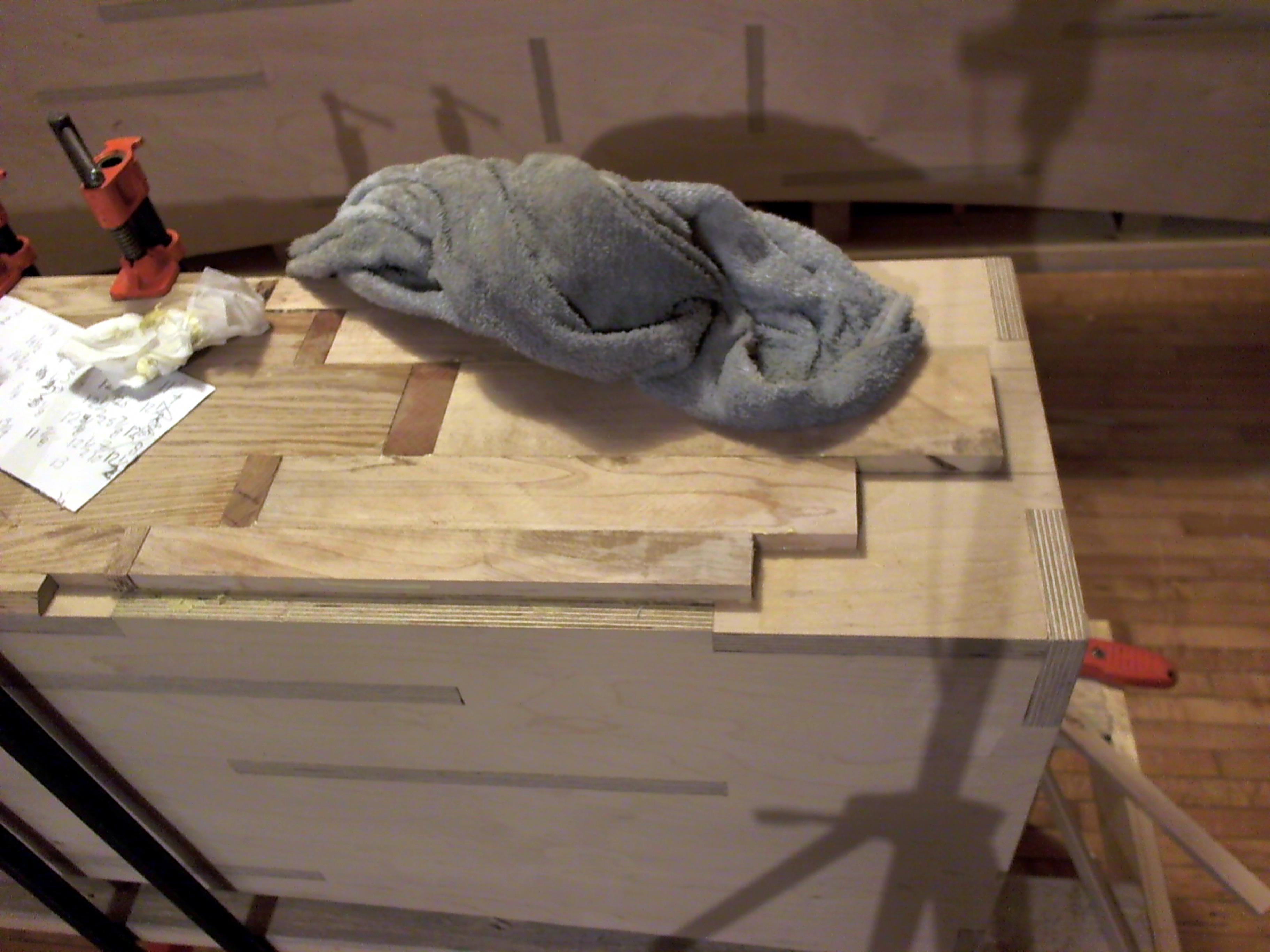

Gluing steps 9-12
After cleaning with the scraper shown above, I would go in with a wet cloth and get as much glue residue as possible. I would dry excess water (step 9), then clean up remaining glue with a utility knife blade (step 10). Once the majority of excess glue was cleaned up, I would replace the jig and clamps (step 11-12). As the pieces where initially "set", I did not need the side pressure clamps until installing the outer most pieces (not shown). I was able to do two of these tiers at one time. I would get four tiers done in one eight hour day. Bear in mind, I was cutting and dry fitting the next tier of pieces when one tier was drying. The whole gluing process for both cabinets took about one week...

The Call Out resolved...
You aren't going to rebate them? Do you have another sceme to to get the fronts flush?
dave
At one point, Dave called me out on driver rebates. What do You think of my scheme? This is actually what I envisioned from the beginning. It certainly is labor intensive and very time consuming, but I have this thing for making patterns with real wood... :D

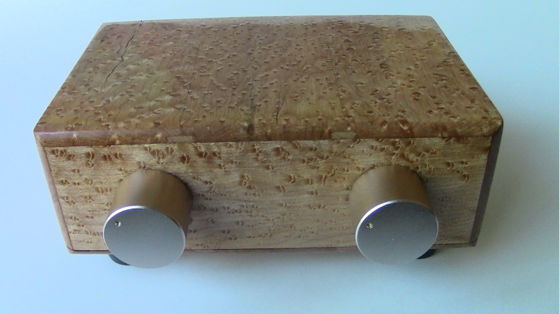

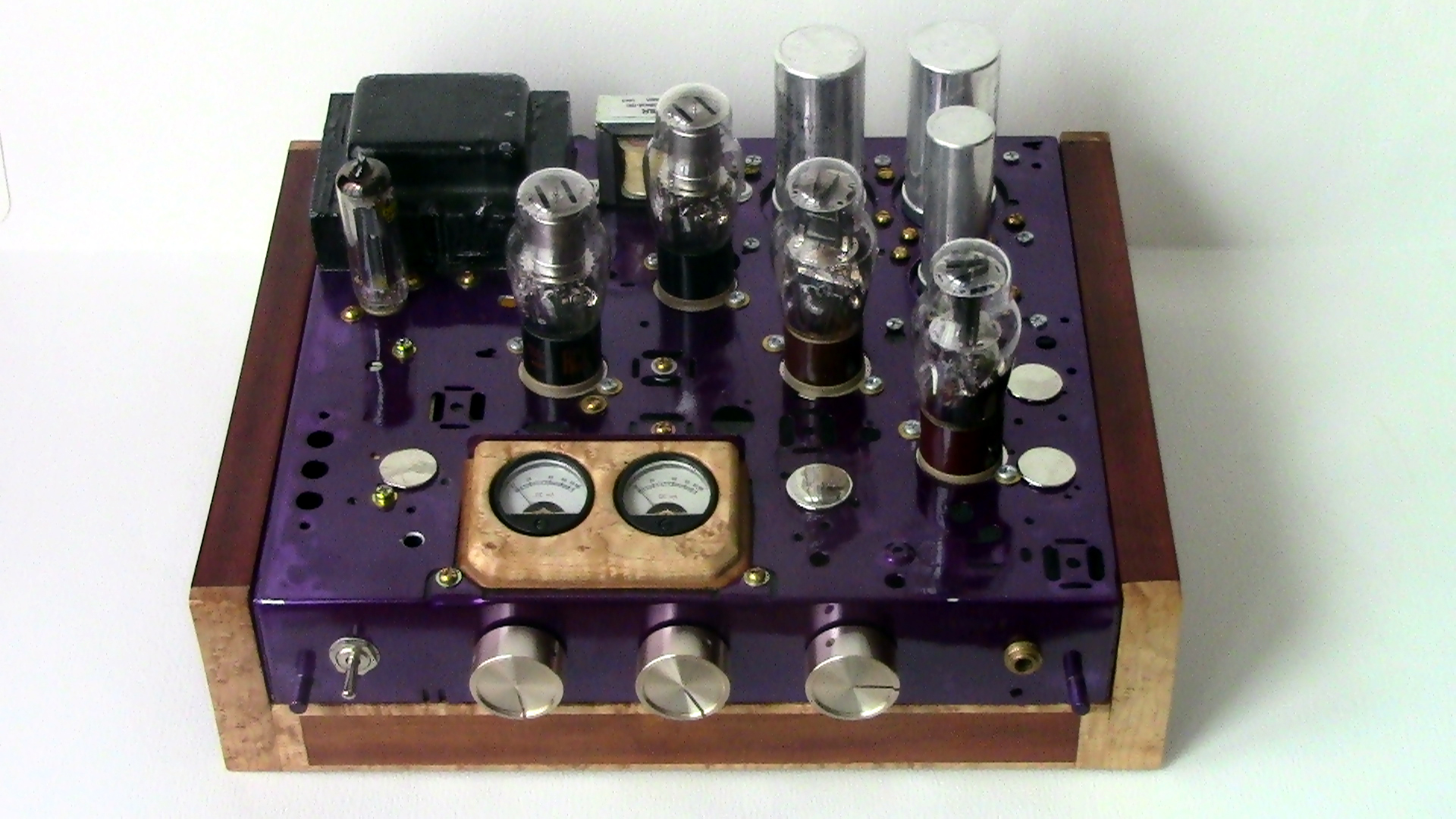

EnVogue Darling Tube pre-amp...
Boy I really wish I had this done.
I have all the construction work done, but I still need to do the wiring.:eek:
I actually was assembling this chassis for diyaudio member PainoLydia. The chassis is from an old "airline" tube stereo console. The revised circuit was designed by John at Bottlehead.com for the 1626 tube. This is not the typical application for this tube, as it does not provide much gain, but does provide more output current. PainoLydia ended up getting a different audio chain, so this design would no longer serve her system. As I really do not need much gain for the chip amps yet would not mind giving them some more current, we figured that this would be a better match for my system. I had already invested quite a bit of time into this project, so I took a chance and bought it from PainoLydia for the cost of the materials. I will probably start a new thread before I finalize the wiring on this. I read the Morgan Jones stuff, but it is quite overwhelming. I prefer to do the chassis work. I will leave the amp circuit design work to Nelson Pass and John Broskie. My realm is Art and Design, woodworking, stained glass, graphics, photography, video editing, sound production, life coaching and care giving. :) The only reason I took the plunge on the Buffalo III DAC kit is that it is a proven design; I just assemble, build a designer chassis and enjoy.
Having said all of that, I think this pre-amp will bring both the Chip Amps and SAE amp to a new level. The SAE is sitting in a box right now, awaiting to be shipped out to Ken Ealey for restoration. This is my reward for getting established in my new career. I will let the experts do the electronics. I will continue to hone my skills in Audio Art.
Allen ;)

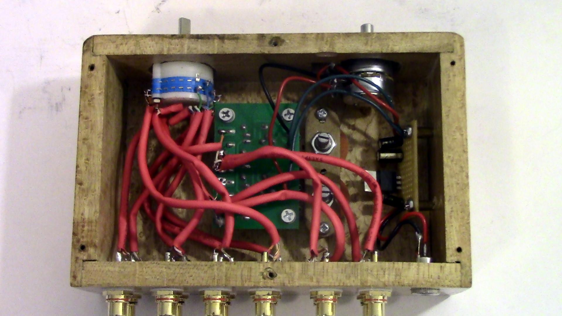

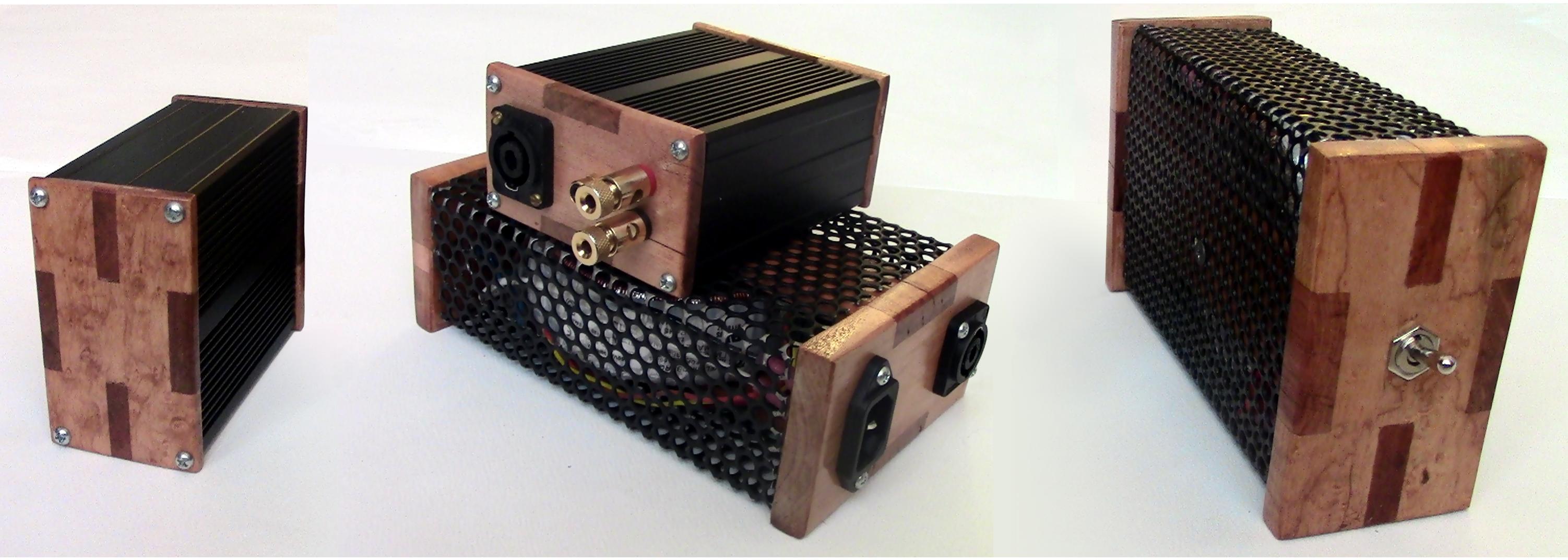

Lightspeed volume control...
I finished the Lightspeed volume control also.
The bummer is one of the Light dependent resisters shorted out inside after a static discharge due to the intensely dry winter we have had. So I am sad to report that this unit is not in service right now. I checked George's website, and there is nothing there. I will try to e-mail him to see if he has any new matched pairs of Light dependent resisters. I can not be bothered to buy 100 of them to test for a matched set. As both the Darling pre-amp above and the Buffalo DAC have built in volume controls, my time would be put to better use finishing one of those...
