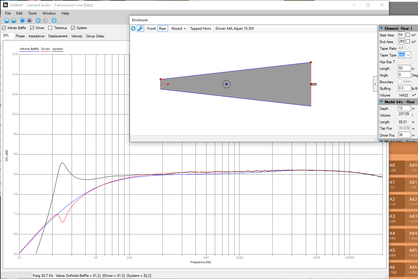

Metronome Design 2.0: "The Simple Giant"
Start Area: 64"
End Area: 288"
Length 82"
Stuffing .3lb/ft3
Driver pos: 36" (~48" off the ground)
(Think ~8x8" at the top and 12x24" at the bottom)
Mass loaded w/12"^2 opening 3" long (essentially a 3" length of 4" pvc pipe)

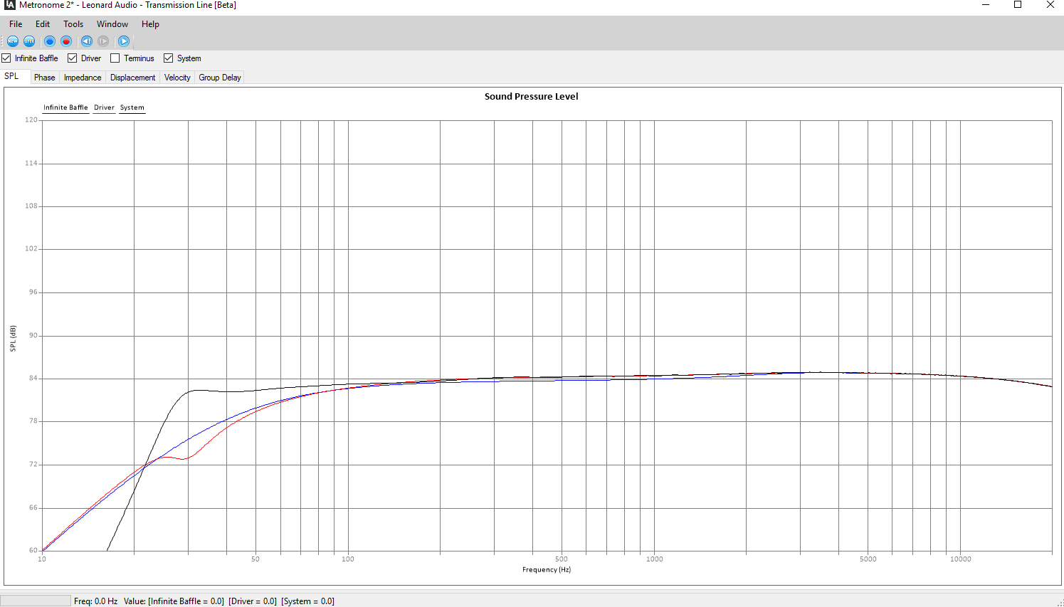

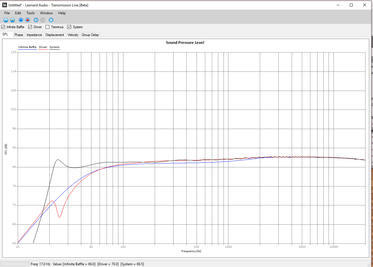

I've included graphs of the alpair 10.3m and the 12p (I have both). 10.3 uses additional 4ohm series, 12p uses +8ohm series. The flatter response is 12p. Both showing 1w output.
The peak for both is at 25hz. I'm hoping that is low enough to be below any orchestral notes which afaik bottom out at 27.5hz which is about +2db for the 10.3m and about -1db for the 12p

Just a quick question: If you are not aiming for maximum bass extension, why are you then tuning your enclosure so low and having to put up with all kinds of compromises like loss of efficiency due to additional resistance, loss of cone excursion control, loss of bass quality?
If I were you, I would try to aim for as flat a response as possible before the knee in the response.
And remember to fudge room gain into your response, this could easily lift your bass response an extra 3-6db in the lower octaves.

Right now I am aiming for max bass extension for 2 reasons. 1) because 90% of what will play on this cabinet is symphonic music which needs to be able to go that low. Standard double bass without extension goes to E1 (41.2hz), and most modern basses have the C extension (goes down to C1 @32.7hz). Bass Trombone and Tuba often hit a low Bb at 29hz, and the piano goes to A0 at 27.5hz. I don't currently have the budget to add a subwoofer, hence why I'm hoping to get as much bass extension as possible. 2) step one is to see what is possible without too many compromises; step two is to find a happy balance among overall sound quality, monster/aesthetics, bass extension, and any other compromises.
Mild loss in efficiency doesn't bother me since the room is enclosed and I generally do not listen to loud music anyway.
You're the first to mention anything of loss of cone excursion control or loss of bass quality. Could you explain what causes these drawbacks and how they are modeled in the software?

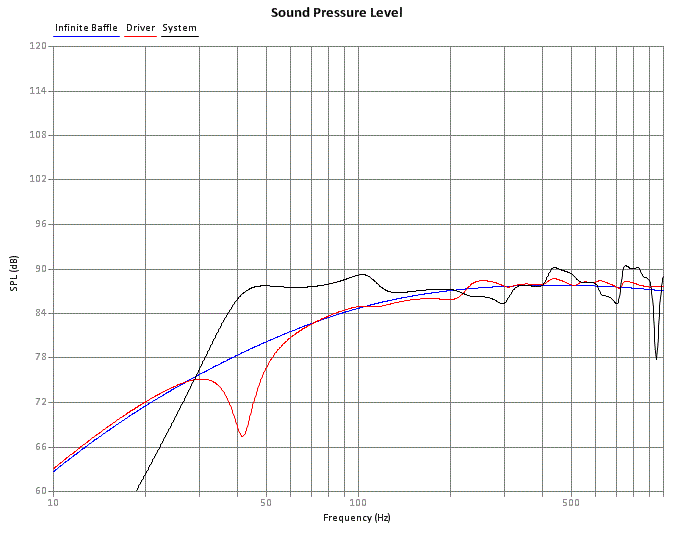

Am going for flat + extension. Attached is the graph for the version I mentioned with half the starting and ending area. How's this for flat?

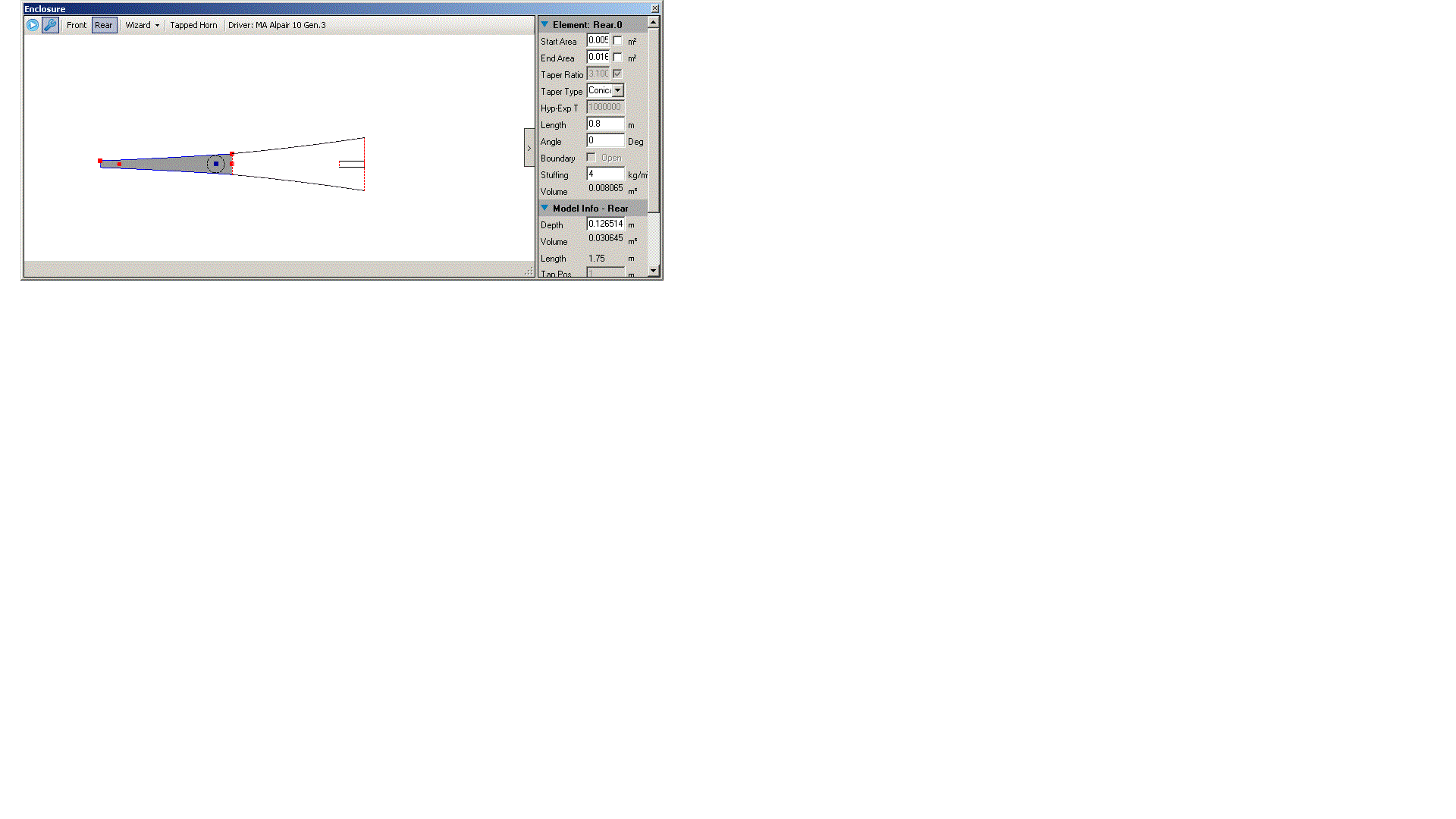

OK, I have been working on this too! My strawman design: 2"x4" top, 7"x9" bottom, 72" line length, 3"ID x 4" vent, driver 28" down from top, only top half stuffed.
My goal is to reproduce the lowest note of double bass, 41hz. This is above the FS of the driver, 38.3hz. Any thoughts?

So I just checked, halving the start area and end area and keeping everything else the same is even better for 10.3m. The peak at 33hz is +2db, and 27.5hz is -2db.
Right, gets rid of the big spike at Fb that otherwise may require excessive damping, eating up acoustic efficiency.
GM
OK, then due to the aforementioned driver issues below Fb, then driver Fs, cab Fb should ideally be at/below the lowest note with any acoustic power that's on the recording, so at least 27.5 Hz assuming no large pipe organ symphonies or some movie music scores.
This is pretty far below this driver's Fs, hence the potential need for trading some acoustic efficiency for extended LF BW with some form of EQ if the room's boundary gain + room gain curve isn't sufficient to flatten it out.
'Flat' is nice, though if the room gain boosts it too much, then acoustically you're back to having the big peaking response, which may/may not sound good or may sound good on some recordings and not others.
GM
