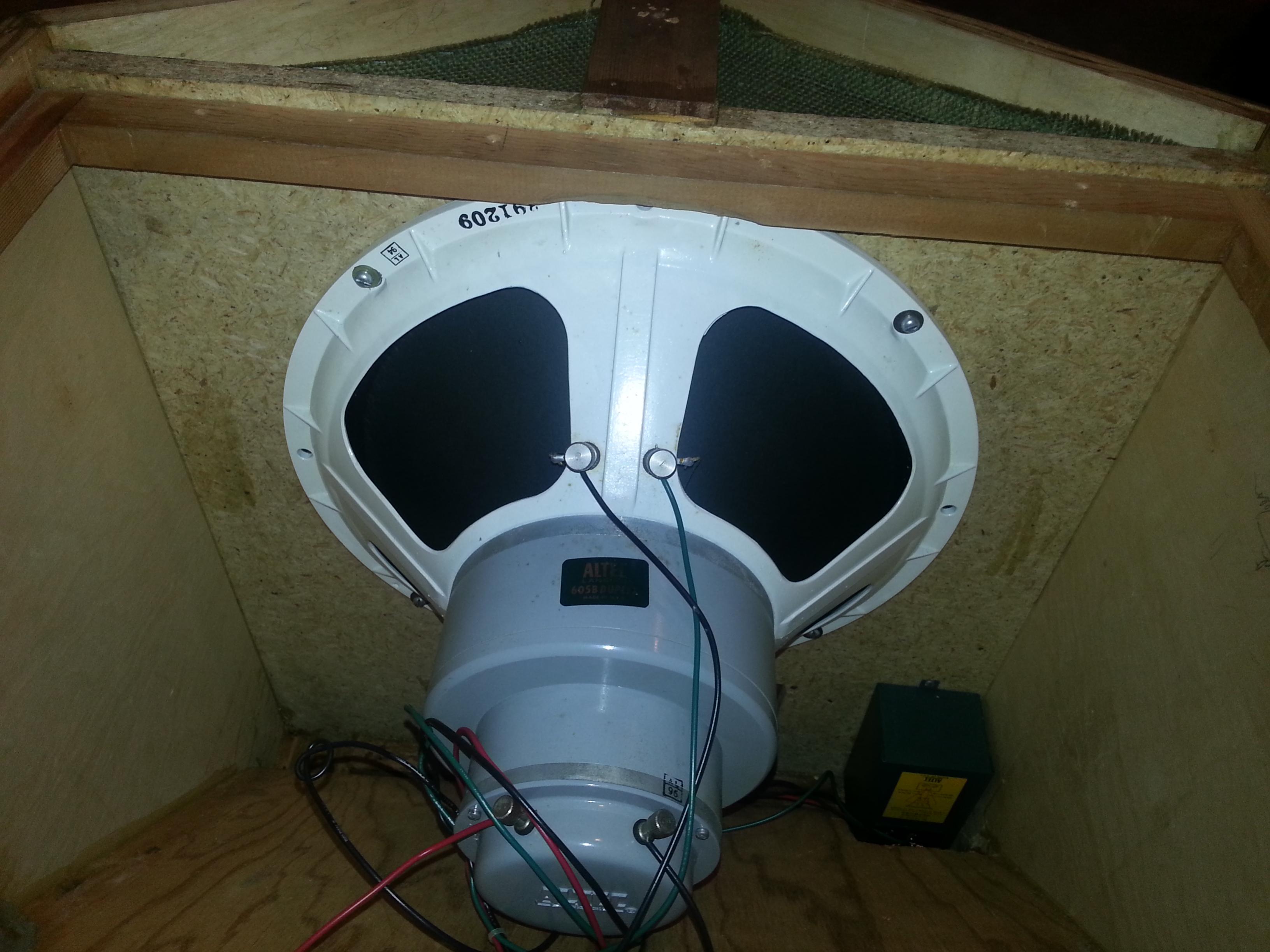

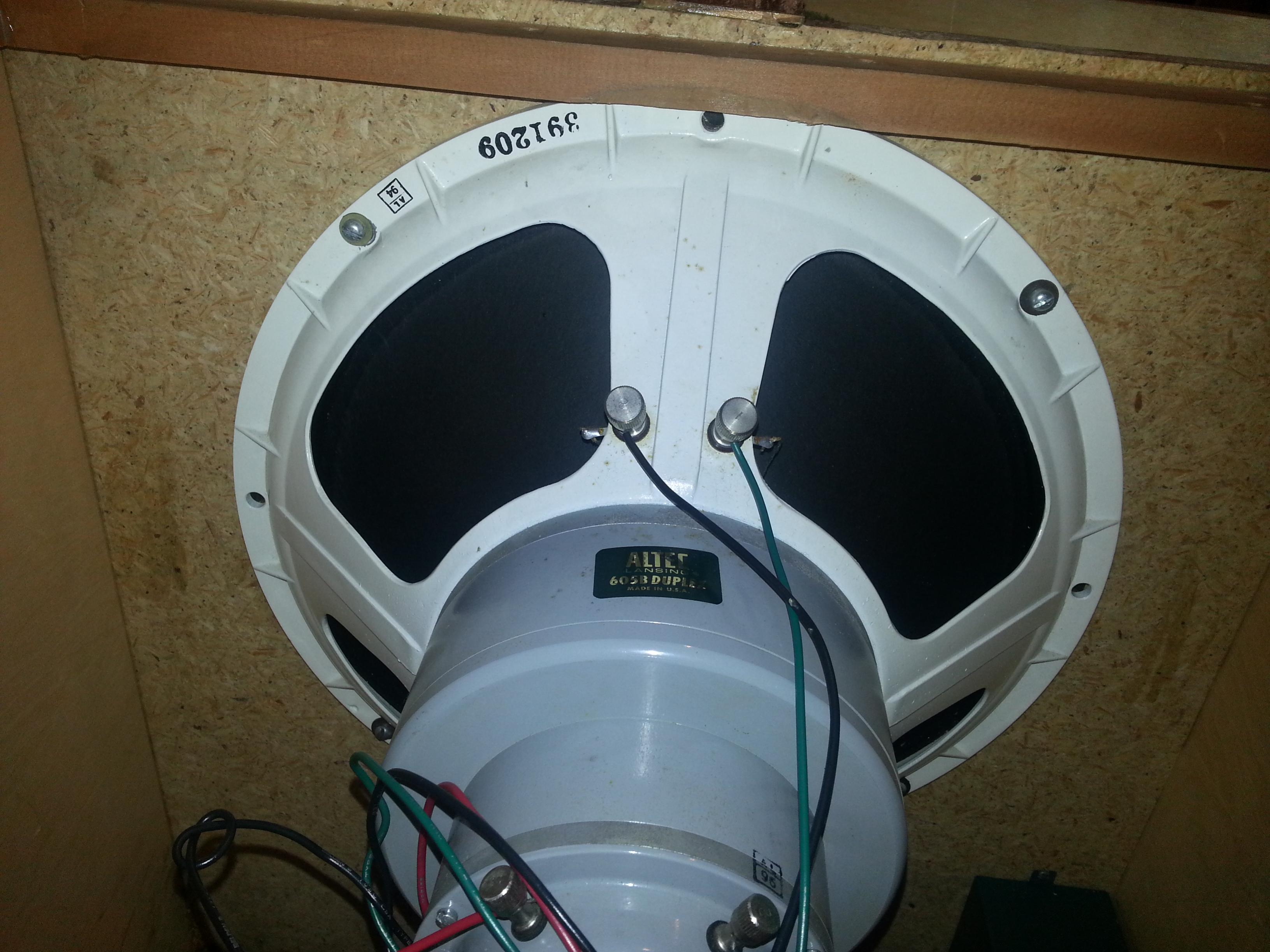

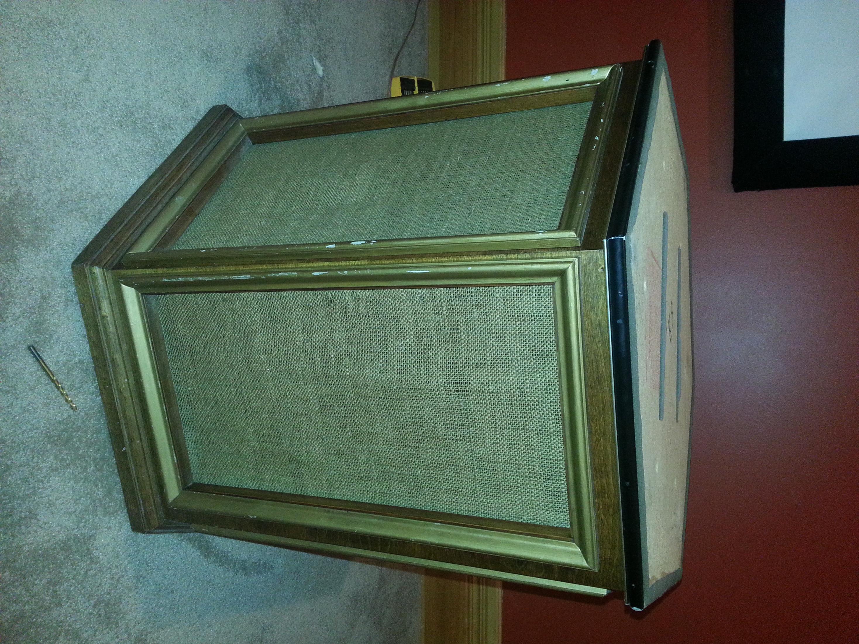

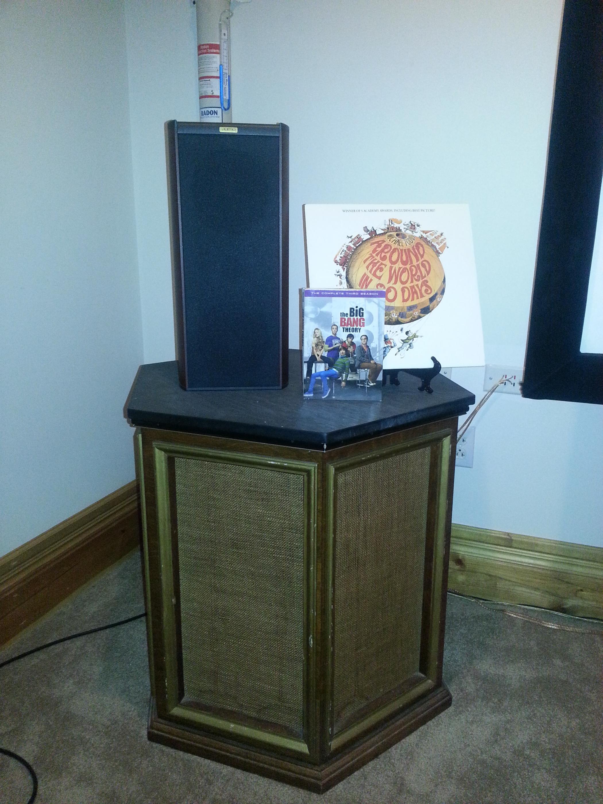

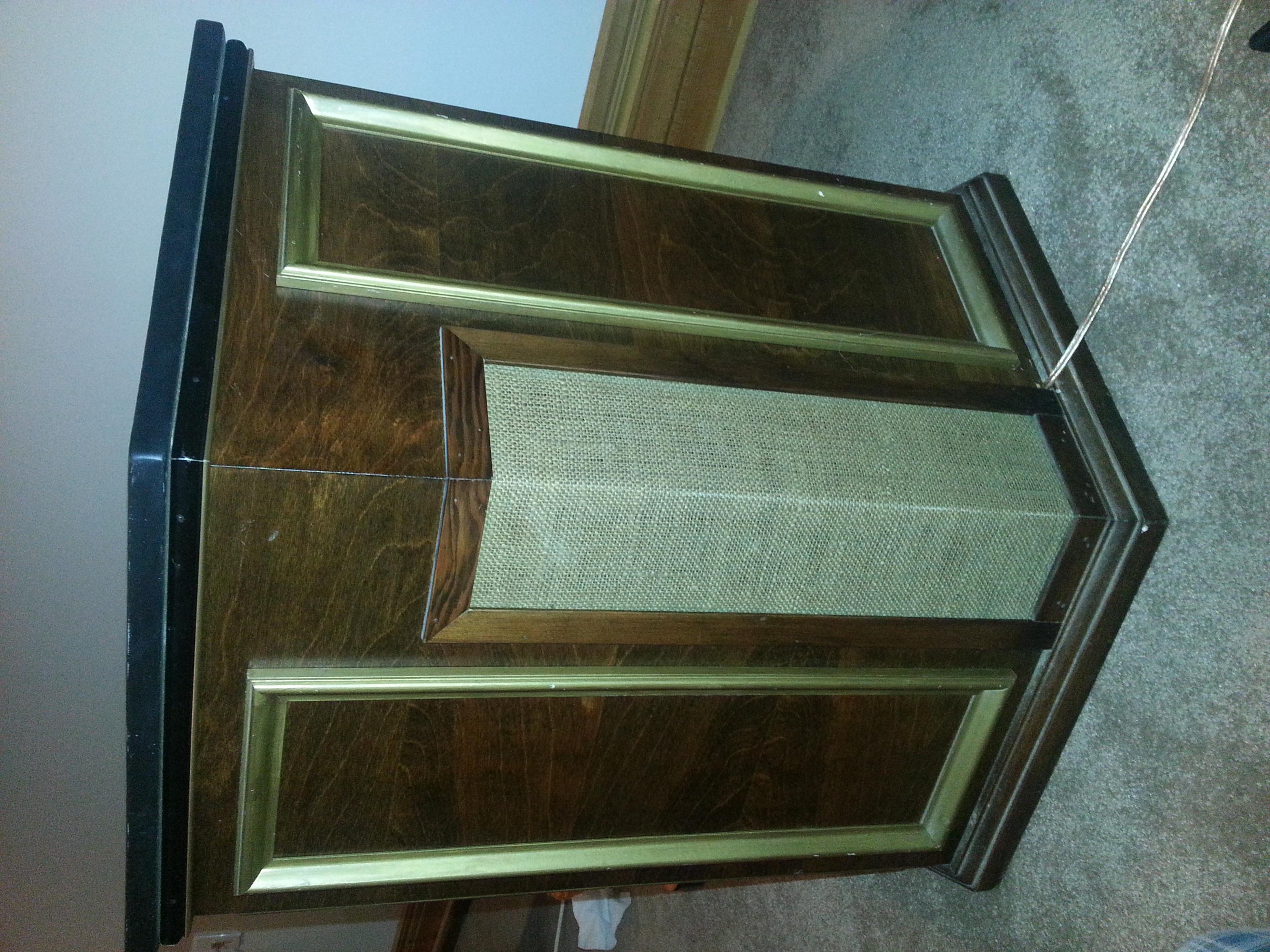

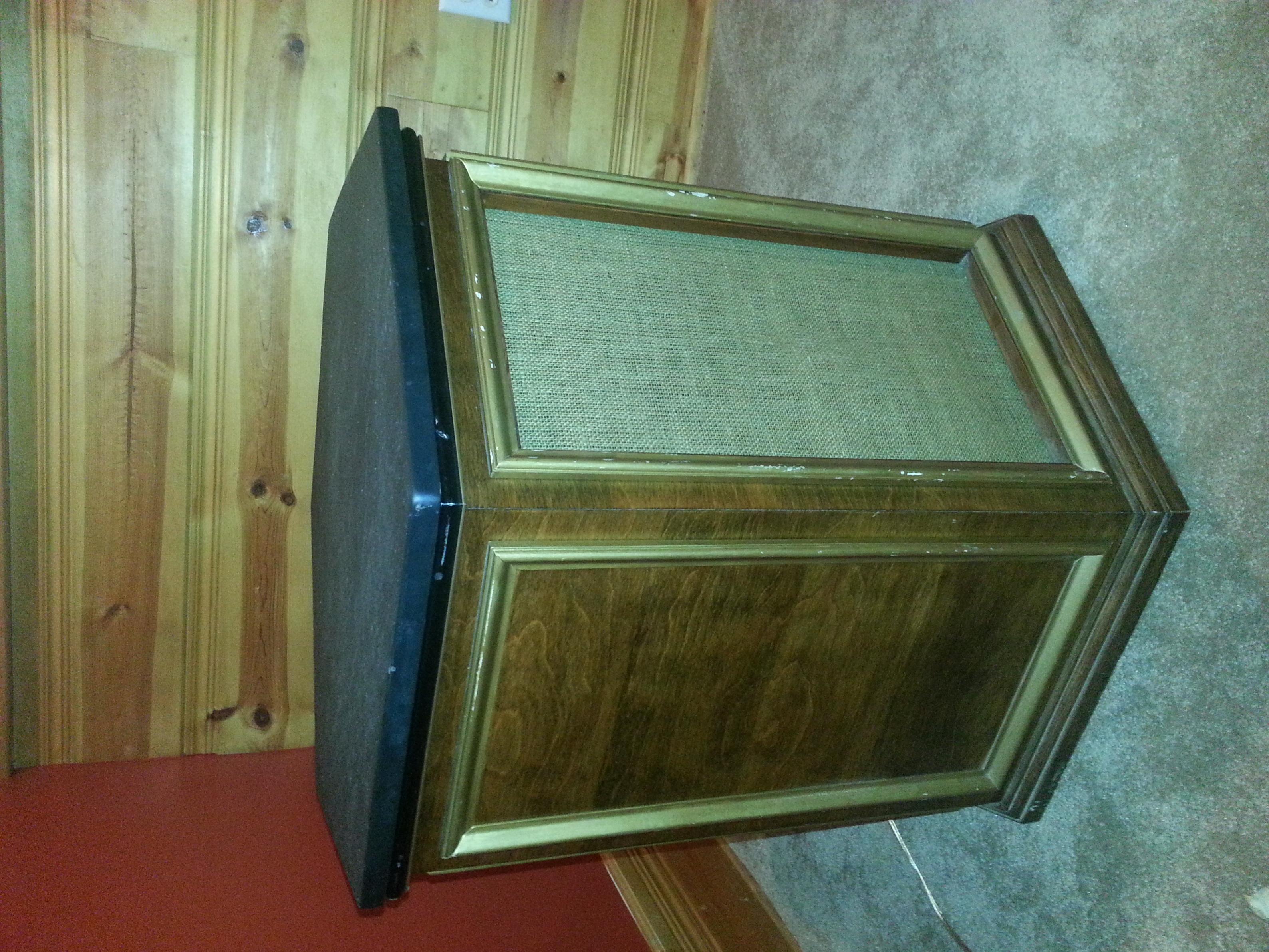

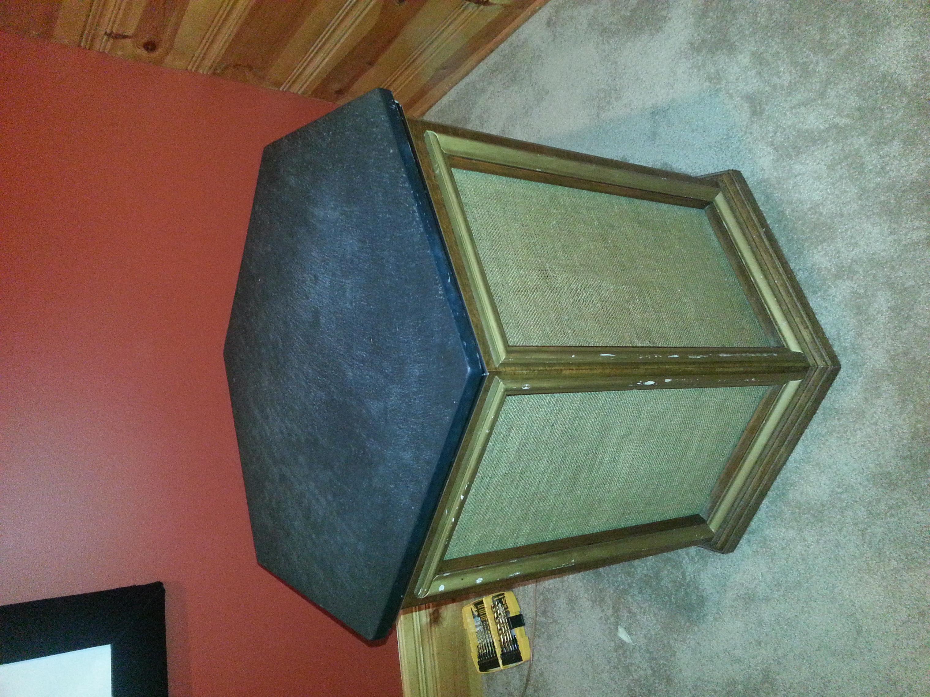

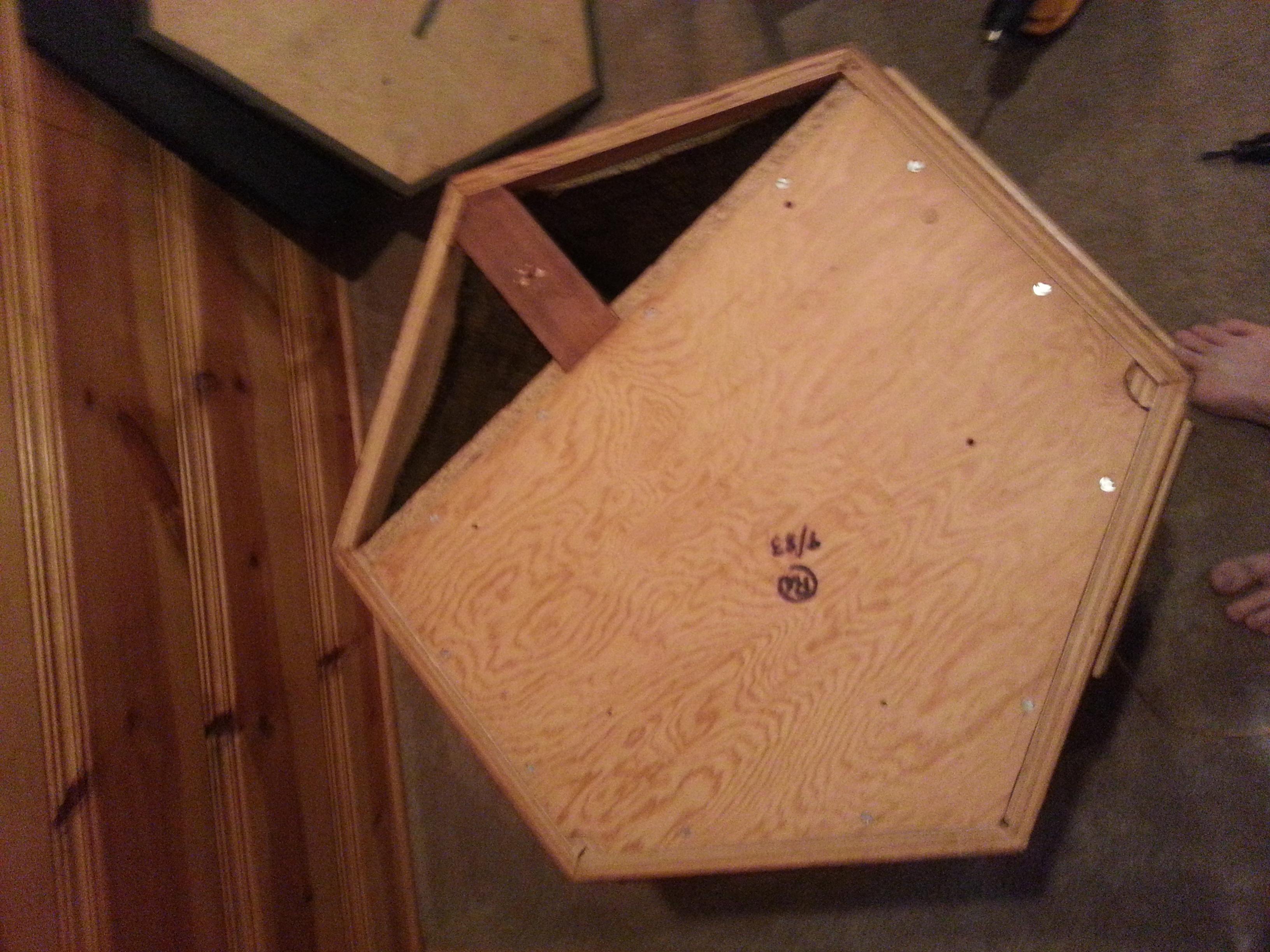

Meantime, here's a story/picture show: Back in the 60s/70s my grandfather wanted to build a nice set of speakers and went to his brother inlaw for advice on what to get/build. My uncle was an engineer and exec at GM at the time where he helped develop stereo audio for cars and as a side hobby designed and built hollywood level movie theaters and sound systems for execs' homes in the Detroit area. This was their solution to WAF:

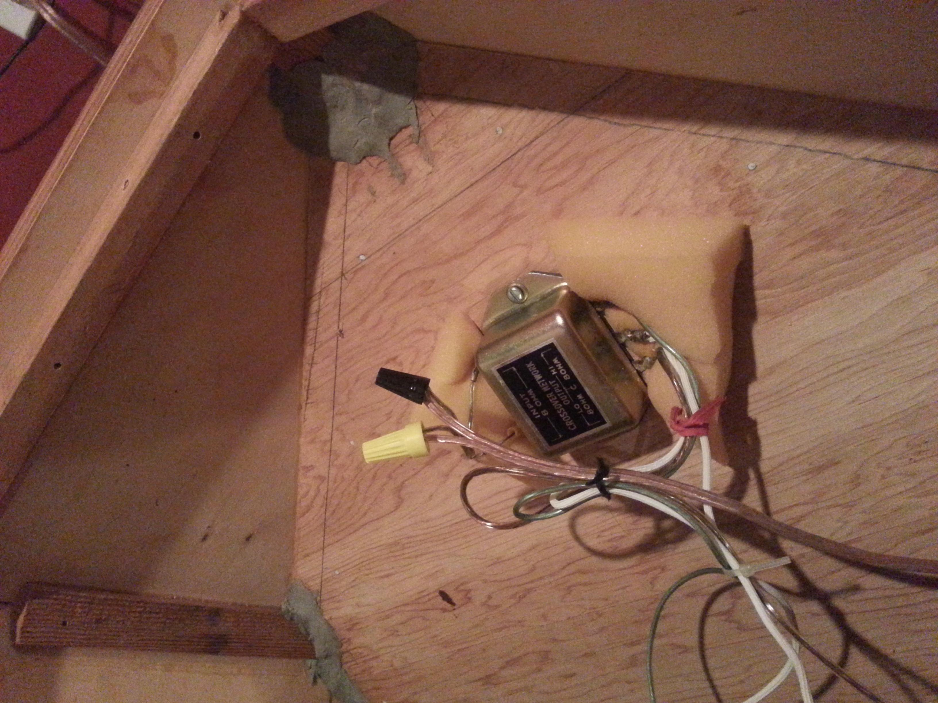

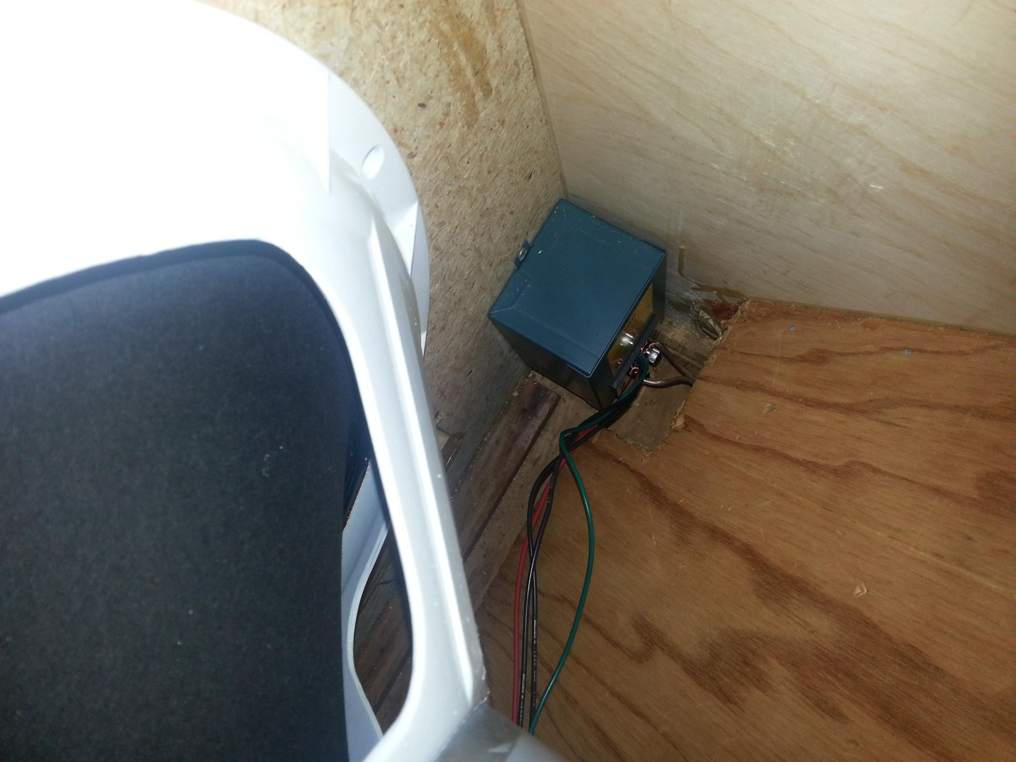

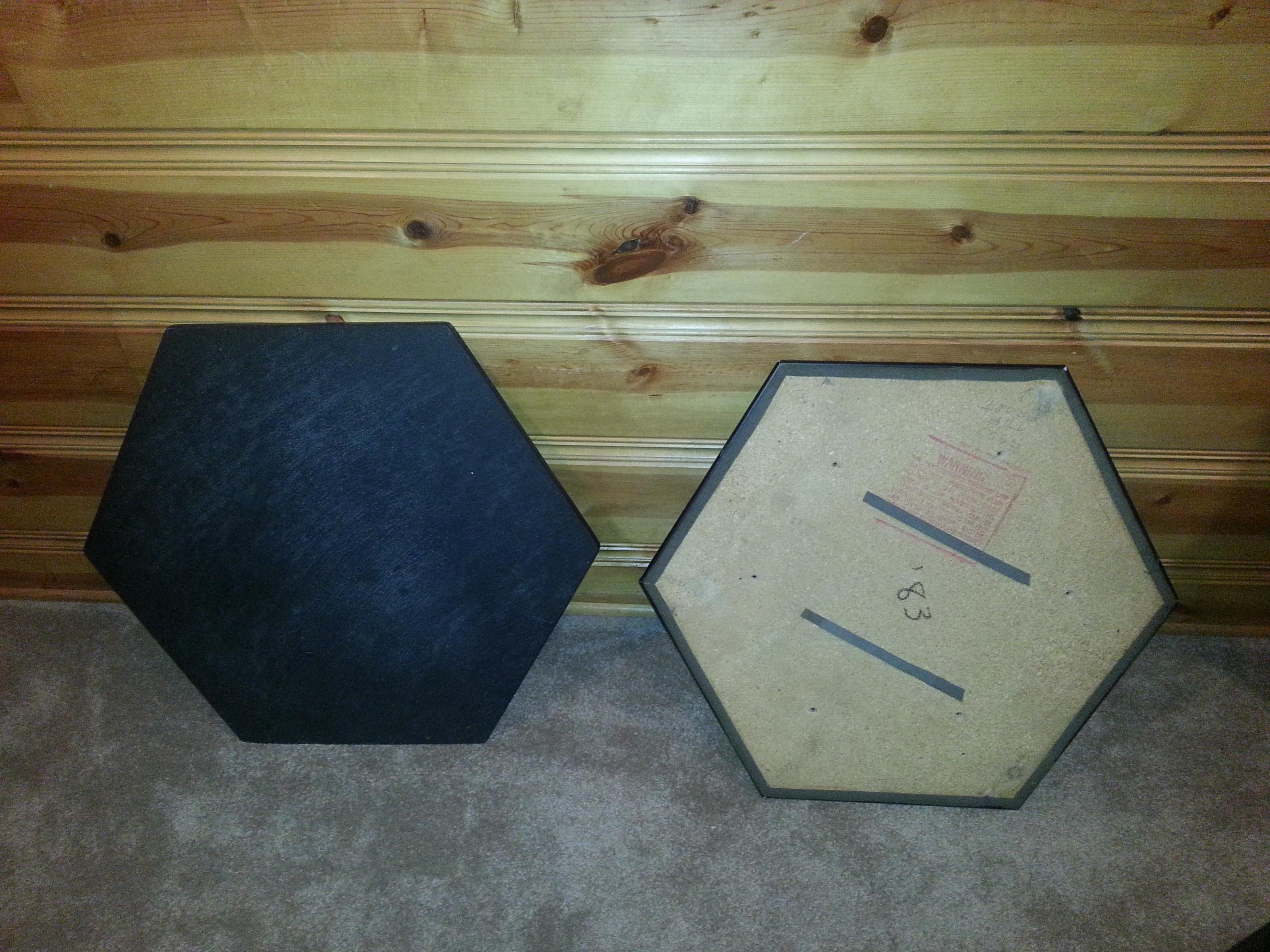

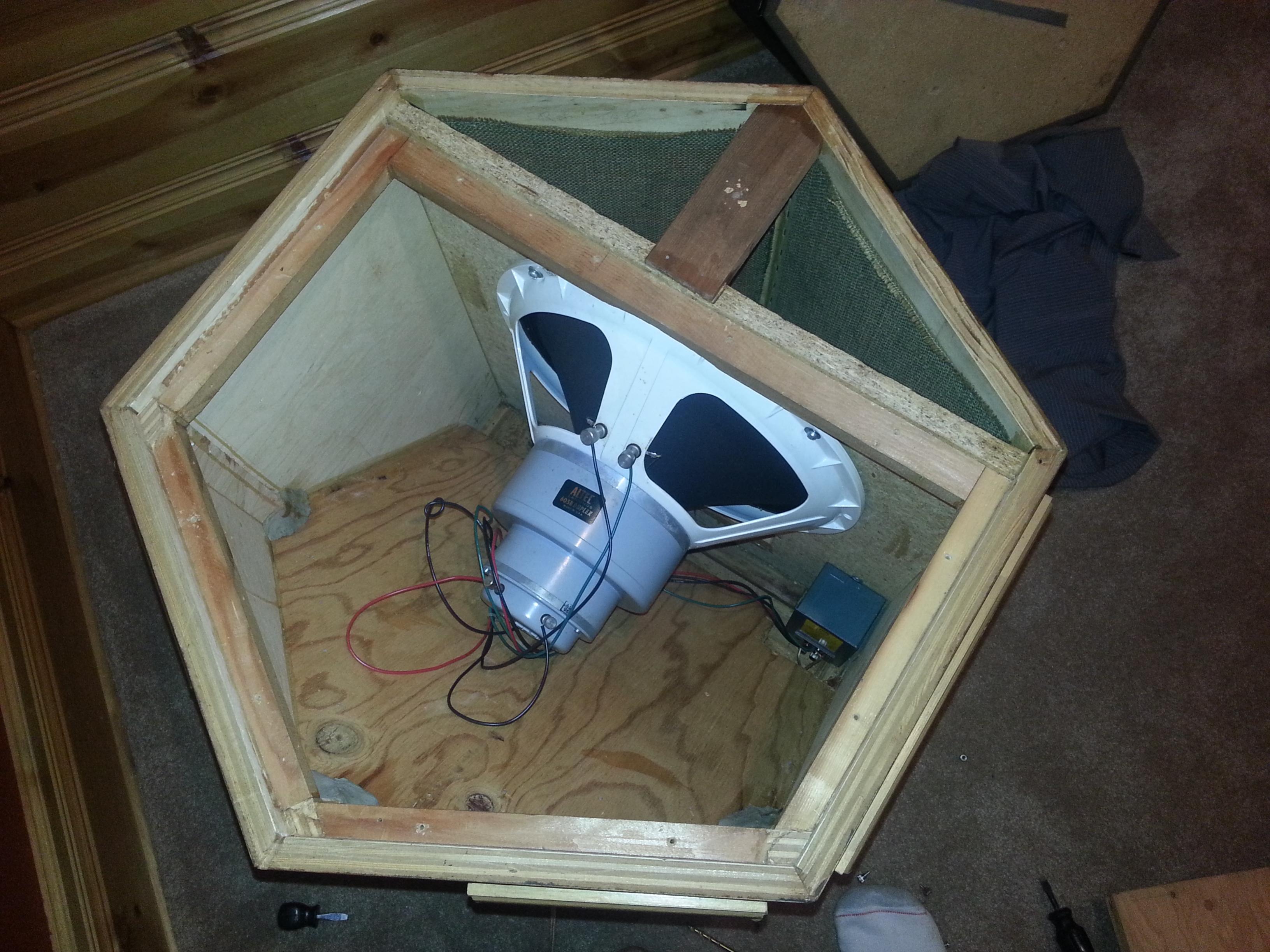

Here's pics from the inside of the other one. For some reason he went with a different driver the 601-8D. Both cabinets were clearly designed for the 605. Unfortunately my grandfather died before I had a chance to ask him why the mis-matched drivers. My suspicion is it was an availability/money thing. But I don't know. The top of the cabinet is ~1" thick solid slate. The last pic is an old one for size comparison. The bookshelf speaker on top is a Jamo classic 4.

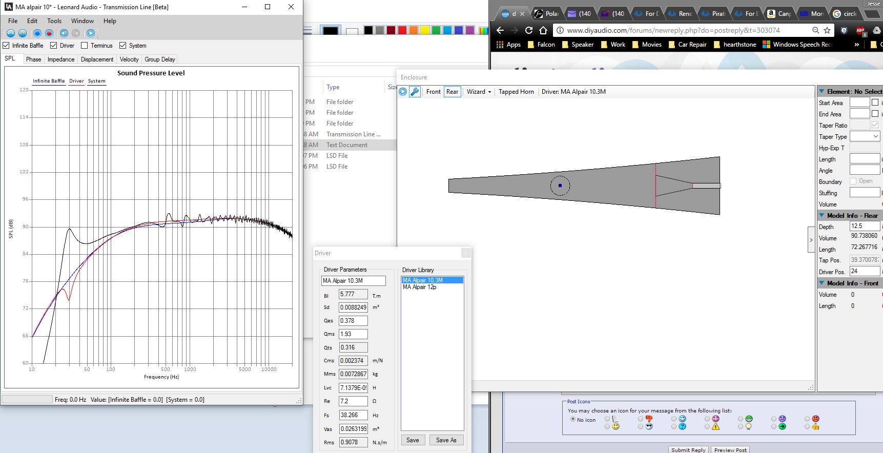

Here's a metronome draft. Summary:
Start Area: 36" (6x6)
End Area: 155" (12.5x12.5)
Total Volume: 90.75 L
Length: 72"
Driver Pos: 24" (48" off floor)
Stuffed: 0.3lb/ft3
ML: 6x6x4 PVC Y attached to a 4-6" length of 4" PVC pipe, or I may build something out of wood, not sure yet.
Am I on the right track?

I am also interested in building an A10.3M Metronome. I have just started fooling with the Leonard software and am still confused by the entry of parameters, etc.
Count, how are you proposing to do the vent?
-Tom-
6x6x4 pvc y to 4" pvc straight pipe.
edit:
It's a bit crazy, but an existing piece, inside the enclosure so out of sight. I calculated the openings of the 2, 6" pipes at the end of the y for the total area of that element end.

I started w/sketchup for wood working, basically modelling standard size boards and then assembling. The learning curve wasn't to bad. At least for basic shapes. Complex curves/shapes is trickier but not so much if you assemble piece.
One model I played with had the low spike at or below 20hz
Speaking of the spike, I'm concerned about that -3db+ dip in the low range before the spike at ~30hz as well as the drop off above 10k. Compared to that MLTL which is nearly flat from ~40hz up, will this curve likely be annoying or still ok?
