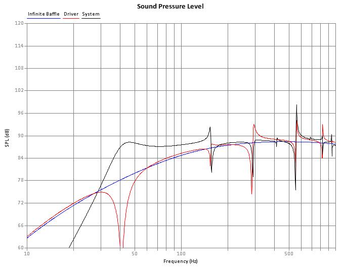

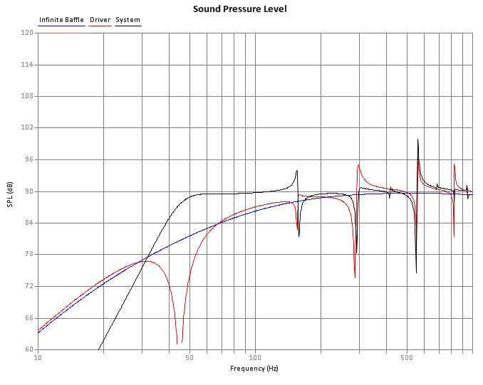

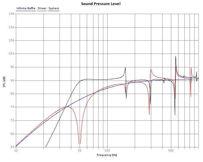

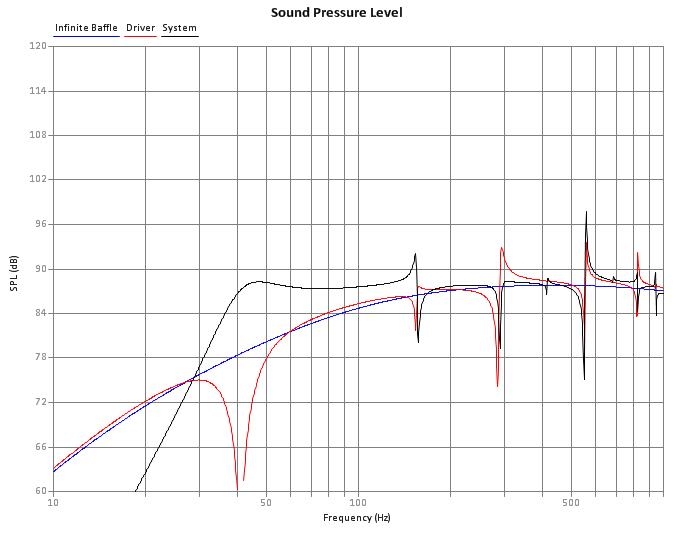

>need to add some series resistance for low tuning.
How would I model that? And then just add a resistor to the red wire in the finished cabinet?
That "saddle" in the low range is very resistant to being taken out in the model. Shortening the line length and taking out volume seems to help but it still persists.
I am confused about the relationship of the quarter wave tuning vs the bass reflex tuning in a mass loaded transmission line.
Increase Re if there's no field for [Rs or Rg or similar] to put it.
That's one way; I typically use a cheap 25 ohm pot to dial in each speaker since the room dominates, then swap it for a good quality non inductive resistor of whatever value I read off of it.

Not much to know, the basics of the pipe is a closed cone: Resonances of open air columns
Shorten it well above the desired tuning, add a vent [open cylinder] to tune it lower and you're done.
Remember, in theory we want the damping of a vent with the same area [Av] as the driver's effective piston area [Sd], so now what's basically happening is you're trading a high aspect ratio's pipe action to shorten the otherwise too long/large vent it would ideally need to be well damped and in the case of the closed cone, it's inherently smoother, more evenly damped due to having both even and odd harmonics.
