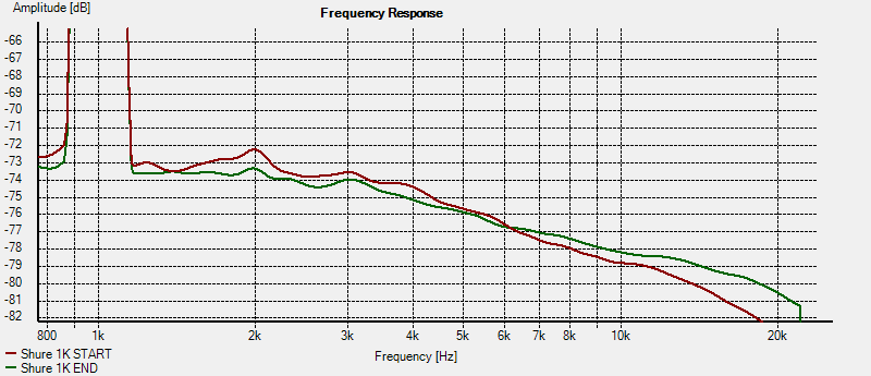

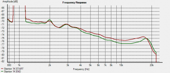

FWIW, my findings on noise are inconclusive. See below noise from the 1K track from the beginning plays to the end plays. These are 1/6th octave smoothed, to better show the amplitude. Shure on one graph, Stanton on another.
NOTE: The Stanton's output is 4.5dB higher than the Shure. Graphs not normalized.

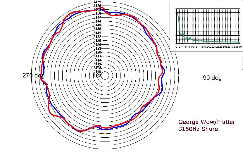

Attached is a plot that illustrates how FM varies instantaneous pitch for the Wow & Flutter test tone you recorded as part of this suite, George. Once around the plot is one revolution of the platter, the radius is 'instantaneous frequency', red and blue lines are successive revolutions. Inset is a spectral analysis of the FM modulation: in this case it's mostly eccentricity plus some stuff at about 4Hz (warp?) and a few other spots, but the cart-arm resonance appears quite stable IME. Overall, this fairly typical of a normal/good playback system, IME.

The flattening of the circle btn 4 and 7 o’clock shown by the diagram is something I notice with the in build stroboscope in this Kenwood KD-3100 turntable .
I have been given two Kenwood KD-3100 units and they show exactly the same platter rev instability. The Kenwood is not the TT I use for playing music though.
If you’ll have some free time in the future to run the W & F analysis on these two files I link to, I’d love to see the polar plot of them.

Sorry guys I have not been following along the last couple of days. The plot shown is for instantaneous frequency only, right? I'm possibly confused around the discussion of instantaneous amplitude. I'm assuming that's a third dimension sort of like a plot of the analytic signal.
