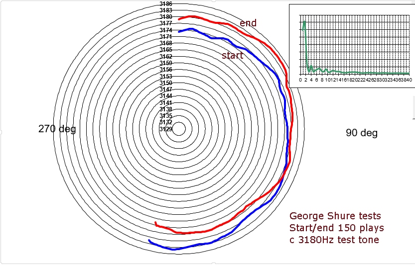

One more polar plot that is interesting and relevant to George's Shure before/after 150 plays test.
One can examine the test tone section from George's Shure test recordings that is near 3150Hz as a polar plot: even though it's only about 1s long and doesn't span a complete revolution there is still a usable fragment. Attached is a polar plot that shows before/after 150 plays from George's Shure sections, No 11 section to be precise.
Good news is that stability generally is very good on this rig - this is much more like a good rig should be IMO. And there is very little difference in stability generally between the before/after 150 plays, suggesting stylus-groove friction remained much unaltered IME. This tallies with much unaltered conventional LF spectrum.
Strangely however, one can see that the two files appear to have different once per platter revolution start points, as though the record had been centred differently perhaps......however we know that George didn't remove the record from the TT, so some other TT drive strangitude must have caused this effect.
It does explain the very weird effect that different sections of the before/after test track recordings appear to have different relative frequency offsets. Some fast, some slow. But now we know that, because a section doesn't last a whole revolution, it depends where the section is on the record as to whether it is faster or slower than average - and this relationship apparently has changed between start and end tests.
I hate loose ends, and this one was very tough to explain until now, but has a very interesting cause. It doesn't affect the outcome of test tone amplitude measurements so long as they properly take care of FM spreading - as mine do. But it does highlight yet another pitfall of trying to make precise amplitude measurements of test tones. And who knows what happened back in the day when tools and methods we take for granted on our laptops now weren't even conceived.
Very interesting? The main points are that George's Kenwood rig used for the test is generally very stable at LF, but drifted as to phase of polar speed variation around the platter in the course of the 150 plays.

Ah ah. Thanks for that. When I looked at different passes or different frequencies of the same file I'd see some fast, some slow. I couldn't figure it out.It does explain the very weird effect that different sections of the before/after test track recordings appear to have different relative frequency offsets. Some fast, some slow. But now we know that, because a section doesn't last a whole revolution, it depends where the section is on the record as to whether it is faster or slower than average - and this relationship apparently has changed between start and end tests
Is is just random instability, or something else? If you get time, may plot the Stanton files, say passes 1, 6 and 12. If there a drift? How about the late plays, are the closer to the 150 Shure? Just wondering if it's random fluctuation or a progressive drift.
Cool, I'd like to get my order in tomorrow, just needed to know about the chips cuz I'd like to order the boards from twisted with the chips in placeThe Low-Z board uses 1642s in the servo. One per board. Gimmie another 48 hours to confirm bits with Hans. Nearly there.
I have a hunch that something has slipped - perhaps simply the record on the mat - over the course of the 150 plays !?Is is just random instability, or something else?
Yes, I'll turn attention to the very interesting 150 plays on the Stanton, and the 300Hz@+12dB tests that apparently point to that cartridge performance progressively improving.........(!!!)If you get time, may plot the Stanton files, say passes 1, 6 and 12. If there a drift? How about the late plays, are the closer to the 150 Shure? Just wondering if it's random fluctuation or a progressive drift.
I wonder if it's possible that 300Hz@+12dB (and beyond) re-laps the stylus wear flats, and/or conditions the stylus suspension elastomer ? Peak angle for groove walls is about 25 deg or so...........repetitively for tens of thousands of cycles at high force...........?
