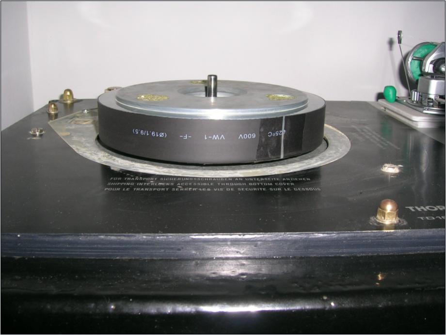

See attachment. The shim of a thermo-shrink around the sub platter.
It was a temporary installation in the mid of a mod to reduce the RPM of the platter (from +1.59% to –0.11%).
