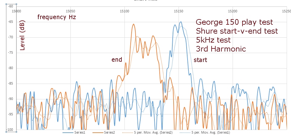

Maybe we are through to the other side ?That's a lot for polishing to account for. TT issues????.

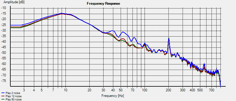

I just had a sneak peak comparing 2nd and 85th files, trying to work out the best long term way of analysing them.
Looking at the whole files for low frequency cart-arm stability seems sensible. A quick look suggested significant improvement for the 85th play over the 2nd, which similar progressive effect was observed in George's 2.5g 300Hz tests.

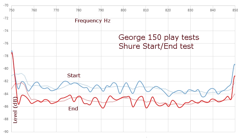

Again using the complete files to look at noise floor in the 750Hz-850Hz range, outside of the test range and free of most artifacts, suggested significant improvement for the 85th play over the 2nd play.
Both these effects can be markers for reduced stylus-groove friction, IME.

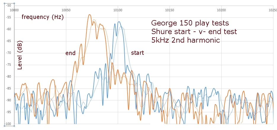

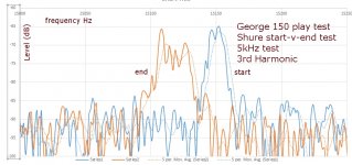

Looking at the 5kHz portion of the files only, it was necessary to select a section free from a large click event which seems to happen on all files. Amplitude of the 5kHz test tone relative to the noise floor and cart-arm resonant system suggests this test is quite quiet or moderate in terms of modulation.
Briefly comparing 2nd and 85th fundamental 5kHz test tone amplitudes suggested no significant difference. However, both 2nd and 3rd harmonic distortion increased significantly for the 85th play over the 2nd play, which IIRC is consistent with Shure's observations in a similar experiment at 6kHz. But inconsistent with George's 2.5g test results at 300Hz and Shure's tests at 1kHz, which showed progressive improvement for 3rd harmonic.
So I think this methodology for slicing the test files into frequency specific bits, and analysing them is OK, the best approach I think, as Pano has already started. But, being MM/MI, it's difficult to observe 3rd harmonic distortion much above 8kHz fundamental because of electrical roll-off.
I'm intending to analyse distortion at 1kHz and 5kHz spots, and tone amplitude only at 10kHz and 20kHz spots. Plus LF cart-arm stability and noise floor 750Hz-850Hz across the whole file. How does this seem as a start ?

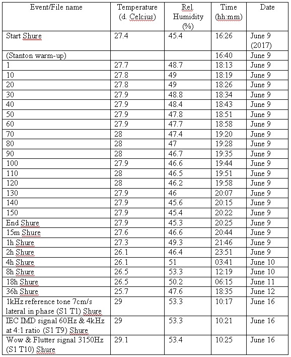

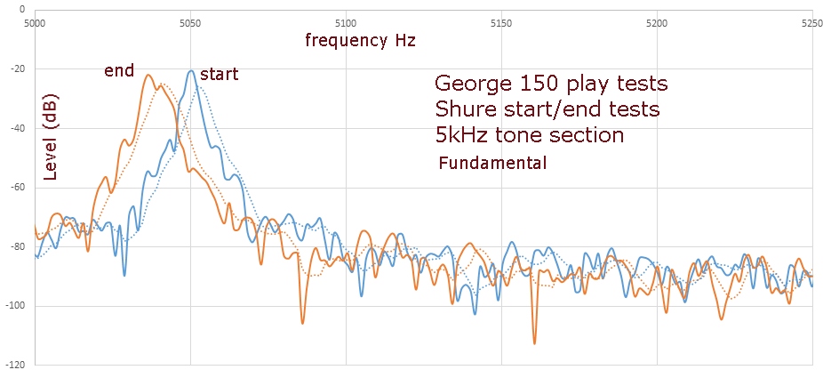

Some notes on the x150 play test
Proof cartridge: ShureM97xE (brush raised) playing with 1.5gr VTF
X150 play cartridge: Stanton MKV D5 playing with 2.5gr VTF
Kenwood KD-3100 turntable, to Hagerman Bugle RIAA pre, to M-Audio Audiophile USB card. 24bit/96KHz recordings.
Test track: Side 1 Track 6 stepped sweep 1 kHz to 20 kHz at -20dB, Mono (Lateral)
from Analogue Productions “The Ultimate Analogue test LP” (*)
Wave editing SW: Steinberg Wavelab
TT and electronics warmed up for two hours. Cartridges were not exercised.
I first played the test track with the Shure cartridge. This is the first proof recording named as “Start Shure”. It is to show the condition of the test track before the x150 plays.
Then I installed and adjusted the Stanton cartridge. I warmed it up by playing for 90 minutes a music vinyl LP (Lightning Hopkins).
Then I started playing and recording the test track for the planned x150 times (**).
I was raising and dropping the cartridge manually.
For to reduce the loss in case of a possible pc problem (***),instead of doing one recording for all the x 150 plays, I made one recording for every 30 playbacks. During the 1min of each recording saving , I was brushing the needle with a soft brush. I wasn’t cleaning the vinyl record.
I was keeping notes on number of times and for temperature and humidity notes were every 10 recordings.
After completing the x150 recordings, I immediately changed cartridge shells, made the adjustment and did a recording of the test track with the Shure. This is the “End Shure”. It is to show the condition of the test track after the x150 plays.
Then I did a series of delayed plays/recordings with the Shure on the test track and finally I recorded three other tracks from the same test LP. One is the 1kHz reference tone 7cm/s lateral in phase (S1 T1), the other is the IEC IMD signal 60Hz & 4kHz at 4:1 ratio (S1 T9) and the third is a Wow & Flutter signal 3150Hz (S1 T10), all with the Shure.
All the Stanton recordings I’ve linked to, are sections cut from the long x30 recordings. Each raw section was about 40sec long from needle drop to needle raise.
I first removed the rear section after the test signal decay (approx 5sec long) and then I removed the initial needle drop and the subsequent impulse decaying low frequency vibrations plus some ( total approx. 3sec long), intentionally entering into the initial 1kHz test signal for to reduce the smearing of the sub frequencies -which Lucky pays much attention to- in the final recording.
Then all the sections were time aligned (+/- 2samples anchor point at the rear of the recording) and a 1.5ms fade in/fade out was applied.
This doesn’t mean that one recording can be sample aligned along it’s full length with another recording. They are time aligned to such an extend only around the anchor point. But this is all one can do with vinyl.
The same editing was applied to the Shure proof individual recordings
The finished test recordings are all 31s 250ms (3M samples) long.

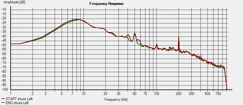

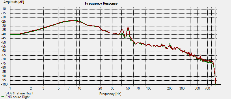

Lucky - I took a look at noise below 850Hz on the Shure start and end files. There just isn't much difference as far as I can tell. Start and End on each graph, a graph for left and another for right channel. This noise has been amplified by 40 dB so the hump at the low end is 20 dB below the 1K test tone level.
The only differences that shows is a little difference in mains noise. Let me know if these are helpful.
Yes, I agree that's true for the Shure files, run before and after the 150 plays on the Stanton. But there's significant difference (improvement) between 2nd and 85th files for the Stanton 'test in play', which is all I've looked at so far (busy ripping the last few of George's files). I looked at the range 750Hz to 850Hz.Lucky - I took a looked at noise below 850Hz on the Shure start and end files.
Perhaps it's possible that what we see in the Stanton tests is compounded by stylus wear or progressive cartridge changes? But early days yet, and best to reserve judgement methinks. But certainly significant progressive changes, generally improvements (?!), are present in the first half of the Stanton files, and a quick look suggests absent from the Shure 'before/after 150 plays on the Stanton' test.

Here's some analysis of the 5kHz section of the Shure before/after test, with 150 back-back plays on the Stanton in between. I used the section from 16.35 seconds to 17.1 seconds to avoid a big click event in both files.
Noise in the 750H-850Hz range, averaged across the whole file, shows about 2dB improvement for the 'end' test over the 'start'. This is statistically significant, and therefore probably real. A similar improvement was observed in progressive tests 300Hz@+12dB for George's Stanton 2.5g tests previously. If one looks at the waveforms visually, one can see obvious reduction in peak noise excursions for the end test over the start.
Amplitude of the 5kHz test tone is similar between end and start files. Attached is a plot which includes point averaged lines, by way of smoothing, which suggests end amplitude is within 1 dB of start amplitude: there is no significant amplitude/energy difference IMO. The turntable has slowed down between start & end tests, BTW
2nd harmonic distortion is similar between end and start files. See attached pot. There's some suggestion IMO that 2nd harmonic distortion is slightly increased in the end file, but within reasonable error bars the files are similar.
3rd harmonic distortion is similar between start and end files. See attached plot. If one visually integrates to find total energy in the peaks, one can see the results are similar, though there seems to be more FM (lower Q) in the after file, possibly due to speed variation?
