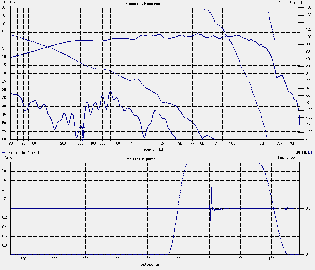

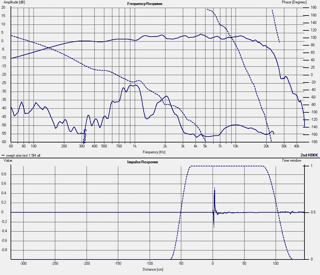

Hi Earl,
I have no problem with what you are saying here, but at what point do you classify the system as poorly designed (ie the distortion is just TOO high). I would imagine that there comes a point where second and third harmonic distortion really do become quite objectionable. Though I suspect this point will vary from person to person, going on my experience of hearing cheap systems overdriven and producing absolutely horribly distorted sound which I couldn't stand to listen to, but the owners were quite content!! I realise this example is likely more amp clipping than the speaker, which as you pointed out DOES produce objectionable high order harmonics much more easily than a speaker can on it's own.
Reason I'm asking is because I felt that I could hear some distortion in my new speakers (work in progress), only on certain music or voices. I did a swept sine measurement in holm impulse and whilst it says THD, and all orders though 10th are OK the actual figure for 2nd was quite a high result (to my untrained eye). Basically the peak level was about 5% between 700 and 1000 Hz.
Would that be considered broken/poor design... At what level would you start to be concerned. It is of course possible that there is a psycho acoustic effect going on here that because I'm aware of it, it makes it seem worse. I also can't rule out that the distortion isn't coming from somewhere else, eg my amp not coping too well with the relatively low impedance of these speakers, or my mic or mic preamp having a problem in that freq range.
Sorry this isn't meant to be a thread jack, but I think the question of what point is there a problem with the design is relevant to the topic, as identifying such design flaws is I guess one of the points of doing measurements :)
cheers,
Tony.
