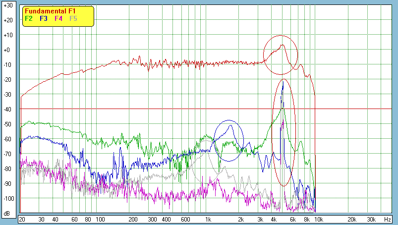

Interestingly, I have also done some distortion measurements that could not be repeated after I used a different test control box with some changes in the interface. Driver distortion measurements are also very hard to coorelate unless the test setup is designed to look into a specific problem. If the driver is not operating in a piston mode, results will vary enough to be misinterpreted.
There's the rub. If you design the system so distortion isn't a problem, then distortion isn't a problem.2) in a decent loudspeaker system design the nonlinearities are such that audibility is not an issue. It CAN BE if the system is poorly designed, and lest face it a whole lot of them are.
An example might be running a metal cone high enough that the cone breakup isn't suppressed enough. Anyone can hear that (fatiguing) sound. The driver may sound fine if you cross it low enough and not so good if you cross it too high. Zaph's measurements of the otherwise excellent Seas W18 show the problem. The 5K breakup has huge spikes in all the harmonics at 5K. There's also a smaller spike in the 3rd at 1.7K (5K/3) and the 5th at 1K (5K/5). If he had plotted the 7th and 9th, they'd probably show similar behavior at 5K/7 and 5K/9.

That data has obvious problems. It just doesn't look right. (Look at all the orders right at 5 k - they all jump up discontinuosly - not possible. ) But anyways, you are pointing to an extreme case, finding a unique problem and calling that proof of the general case. That doesn't work.
What I see done all the time is people comparing two curves nonlinearities and saying that one is better because the distortion is lower when there is no obvious problem. Its the marginal cases that become completely unreliable, not the extr'eme one. To call THD representaive of what we hear, it has to be consistant in all cases and its not. That makes it an unreliable indicator of perception. It can find the agregious problems, but it cannot be used to improve a loudspeaker that isn't broke.
Yes his mic was overloaded, or something else in the system was clipping.
Yes, that was my opinion as well, or something like that. So I don't accept his data, but I do accept his point that disortion measurements CAN find a "broken" speaker.
