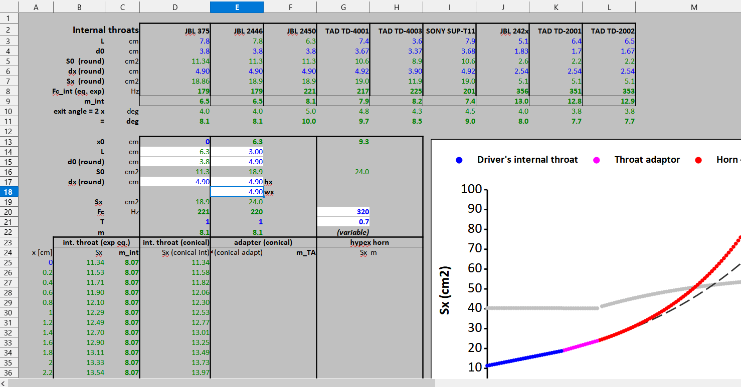

I'd happily share mine, but Excel files do not seem to be allowed as attachments.My spreadsheet isn’t giving me consistent numbers.
[EDIT: Weird! They are allowed if saved as ".xlsm" (macro-enabled workbook). - Here it is, then.]
@marco_gea I'll have Jason look at file types again. It should be xls or xlsx (the new, zipped version) for uploads. .ods would be nice too.
I've been cruising around your spreadsheet, it's quite a lot of work you've put into it. Bravo. The graph with the driver throat, adapter and horn and throat continuations is very handy and allows rapid checks. In the sheet there are only 10 unprotected cells where the user can input data. Some of them are obvious, some are not (too me)
Cells that are obvious
- D14 = L from chosen driver in top table
- D15 = d0 from chosen driver in top table
- G20 = Fc of hypex horn
- G21 = T of hypex horn
Cells I don't understand
- G17 = dx from driver data?
- E14 = unknown
- E15 = same as G17?
- E17 = adapter exit?
- E18 = adapter exit?
- E14 = length of throat adapter
- E15 = diameter of throat adapter entry
- E17 = height of throat adapter exit
- E18 = width of throat adapter exit
It is assumed that the throat adapter transitions from a round entry (on the driver side) to a rectangular exit (on the horn side).
E15 should be equal to driver exit diameter (D17), but the spreadsheet allows for some slight mismatch (e.g., 5cm vs 4.9cm)
Ah yes, hadn't thought about that, but cell E19 should have been the clue.It is assumed that the throat adapter transitions from a round entry (on the driver side) to a rectangular

OK. Here is a list of the cell functions you need
@marco_gea What’s your process for finding a hypex horn that fits the flare rate of the driver? Your spreadsheet gives us the expo horn, but what is the process for finding the hypex horn?
Not to intervene in this healthy and fruitful discussion (I am learning too), but how do snoutless drivers play into the horn matching? For example, the JBL 2452 1.5” exit driver has the exit right at the end of the phase plug. Does this mean it is a good match for a larger variety of horns?
Quick trial and error will do it.what is the process for finding the hypex horn?
Just try different combinations of Fc and T, until you get a matching initial flare rate m (grey trace).
