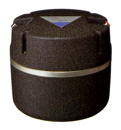

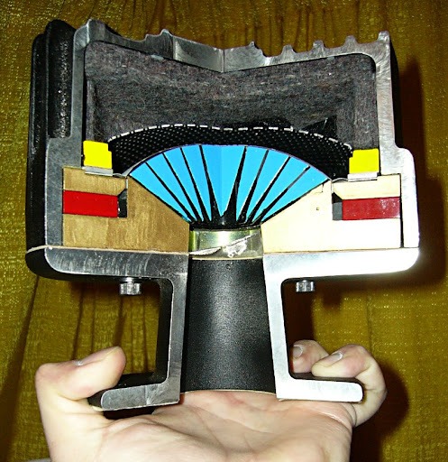

I'll cite a recent example. Forum moderator @kevinkr recently went thru a good deal of trouble and expense to learn what driver works best for his new Yuichi horns. The Yuichi is a wide horn, but not very tall. In fact the horn very quickly goes to over 90° flare in the horizontal axis, while remaining with zero expansion along the vertical axis for about half its length. The horn is very much axi-asymetric, as opposed to a round horn where the expansion is axi-semetric. Is the horn a rapid expansion, narrow, or somewhere in between? What driver geometry would work best on this horn?
This is what the Yuichi looks like inside.

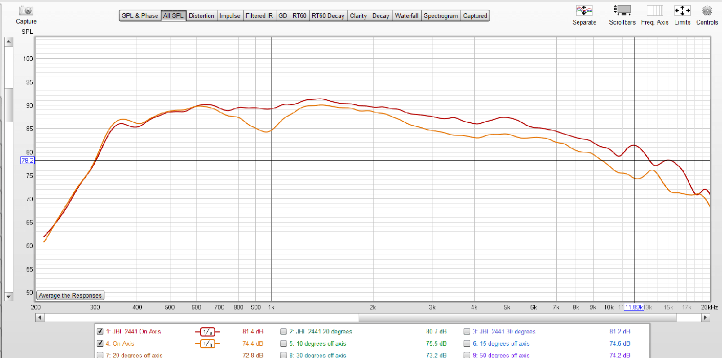

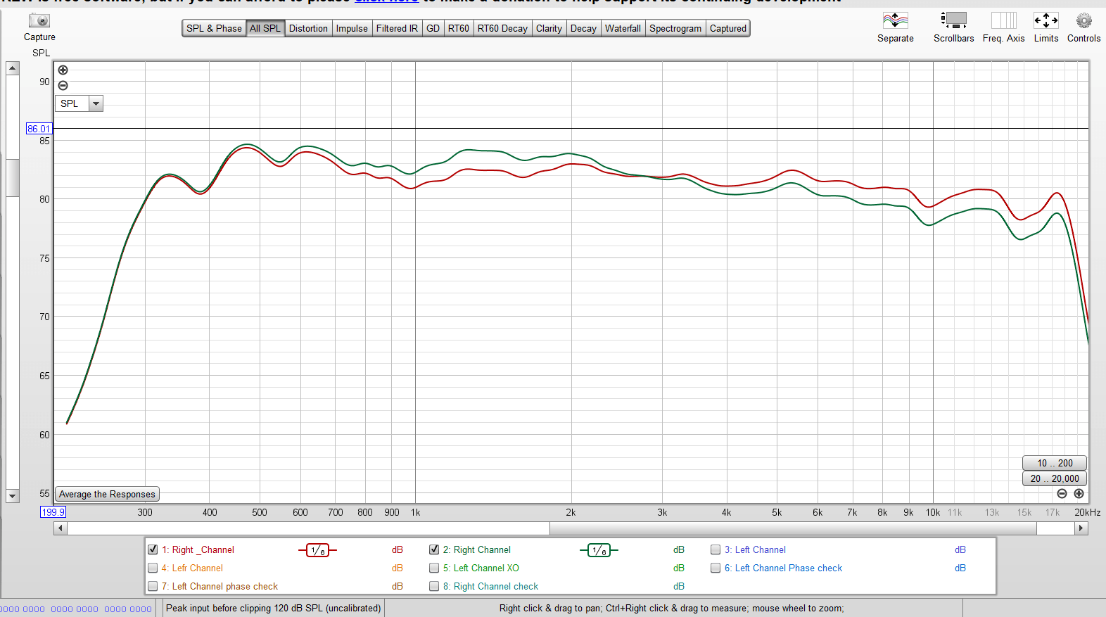

Let’s take @kevinkr example of different drivers on the Yuichi horn. The first driver tested was a brand new pair of Radian 950-PB. This is a modern style driver with a shallow throat and somewhat wide exit angle of 21°.
How well did this driver perform on the Yuichi horn? Not horrible, but below expectations and not as good as some published measurements of the horn. Here is the Radain 950 on the Yuichi.
A good response with low distortion, but not as good as it might be. The dip circa 1kHz was troublesome and difficult to EQ out. Top end drop off is not unusual, but could perhaps be better.

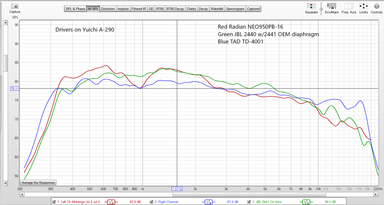

The JBL 2441 is a 2” driver of similar construction to that of the TAD-4001. Here is a comparison of the 950-PB (orange) and the JBL (red) on the Yuichi.
But contrast, here is the TAD-4001 on the same horn. Red race is with EQ, green trace no EQ. Response is flatter than previous drivers with fewer artifacts. Low end response is good. I’ll let Kevin elaborate on his efforts to get a good response out of each driver on the same horn. Maybe Kevin can combine these three different driver onto one FR plot.
How would we know ahead of time if a driver might but suited to a particular horn profile or not?
To me the Yuichi looked like a horn with a very fast flare rate, that might work well with using a driver with a short, wide throat. But in this case it didn’t. @Arez and some others have pointed out that it’s the combined horizontal and vertical expansions that matters. The overall expansion. See here:

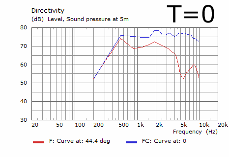

Simulation case - Radian with wide angle throat into Iwata-JMLC horn, T=0 and T=0.8.
file "sim" with conical adapter (see side view)
file "sim1" T0 regular is perfect match
conical adapter makes a dip around Fc or Axidriver artifact
I'll try to find simulation file on archive disk if somone has Axidriver installer. Anyway any sort of adapter or large angle mismatch will create dips on SPL when T is closer to zero. But dip in Radian is cavity inside the VC.
T=0 is needed for good bass extension in case of fullrange in a horn.

Yes the 950 PB in stock form, has a resonance at 1050 hz ish, that has been confirmed by several sources.
I suspect it might become worse if you add they're shims for extra excursion ontop?
They're machining tolerances are not as tight as JBL/TAD/Emilar etc.
That is a tradeoff when chasing power handling and cheap production I guess.
They also have no foam/felt damping in the back chamber unlike JBL/TAD again.
The CSD below shows that behaviour quite well. This also has the 10k resonance from the AL diaphragms showing very clearly.
As for the Yuichi it has a slow flare rate, as do "all" the TAD drivers due to the ALnico magnet design. The only exception is the Neo magnet, 4002 without the adapter, that has a short 10 degree exit, after the phase plug in comparsion, as seen below.

So as everyone probably knows Pano and I have been friends for a long, long time. I shared the details of what I was dealing with him and a few other friends. Here is the overlay of the 3 drivers on the same horn. The other channel is identical within the tolerances of the individual drivers. This was the best I was able to do with the overlay. These are nearfield measurements about 5cm from the horn mouth, on axis with no EQ and no crossover.
The 4003 obviously does not have the Alnico mag, a shorter distance, different exit angels but a slow flare rate, and fairly long exit still.As for the Yuichi it has a slow flare rate, as do "all" the TAD drivers due to the ALnico magnet design. The only exception is the Neo magnet, 4002 without the adapter, that has a short 10 degree exit, after the phase plug in comparsion, as seen below.
So does the Pioneer ED 915, and the different versions from Linear technology, which are basically rebranded TADs.

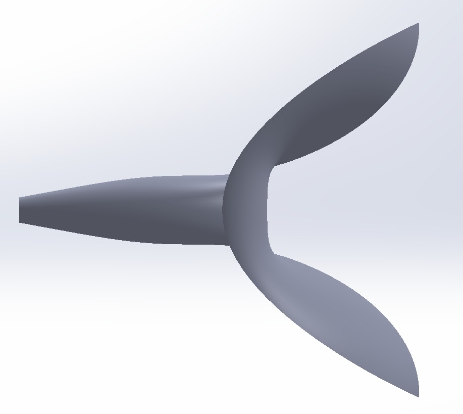

My 12" woofer boxes are slowly coming along and I'm getting closer to settling on some kind of wave-guide for the tweeter. Maybe an "econowave" or something. So I'm weighing up either designing a wave-guide (or horn without the compression chamber) for one of the non-horn tweeters/mid-tweets I have lying around, OR getting a neo compression driver.
Looking at DN07.10LM, there doesn't seem to be a lot of info and plugging in the numbers to Hornresp requires a lot of guessing. All I can see is that the flux density is strong, which seems to help avoid narrow ripples in the response. I can adjust smooth curves with filters.
I'm looking at making it the old-fashioned way with a collection of wooden rings made into a full teardrop box shape. Developing a nice expansion curve may be a nice challenge. I have an idea for an expansion model, based on taking a curve that smoothly transitions between the throat exit angle and a 4pi steradian box exit angle. On a 2d plane, it would look like an 'S' curve -- at some point the expansion decelerates to minimise any sudden impedance changes as the wave exits the box.
Wonder if anyone has any advice on this? All the designs seem to be either copy-pasting someone else's pre-existing horn, or endless playing with FEA style analysis.

If we model the system like a series of conical sections, as the wave exits the first segment, there is then some available space at the fringes for it to expand into. And that's where we get the rotation, and for each subsequent step the expansion has to be referenced to the starting angle of the previous step.
If we draw an exponential curve on a plane, it seems like the axis that's normal to the expansion should actually rotate as the flare progresses. So the expansion would be faster than what would be expected from simplified wave motion purely in the X axis and expansion in the Y axis.Exactly right.
The wavefronts will be normal to the horn walls at all times.
Assuming that the driver's phase plug does its job correctly, the wavefront will be plane at the phase plug exit.
Then, the internal conical throat will make the wavefront spherical (i.e., a spherical cap with a radius of curvature dependent on the conical throat exit angle).
Instead, radial horns are designed assuming perfectly cylindrical wavefronts. That is a reasonably close assumption, but not a perfect one, of course.
So, the throat adapter (in between the driver's exit and the horn throat) has to somehow force/squish the wavefront from spherical to quasi-cylindrical.
None of this is perfect (as Dr. Geddes would surely remind you, while throwing his hands up in the air ;-) )
But it has worked reasonably well for many decades.
