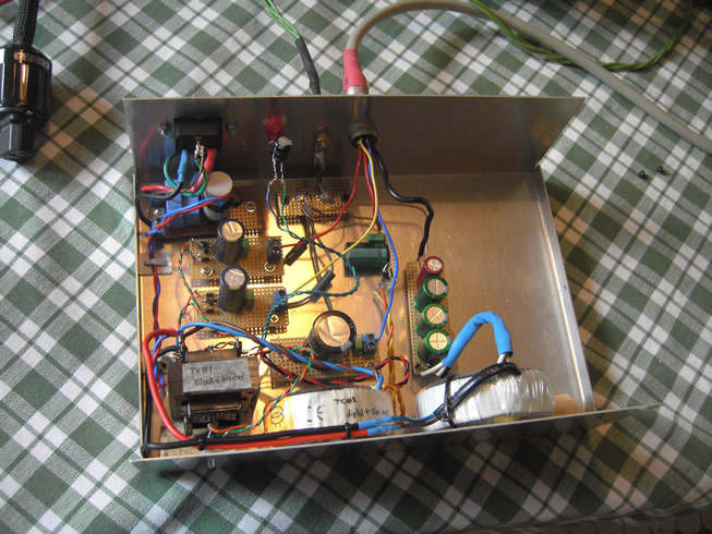

3 transformers, 5 power supplies. One ground connection, isolated from the chassis, connected to the cd player via a thick jumper.
I'd do it all a bit differently if I did it again. For example, I'd keep the power supplies simpler with just a single cap or two, and I'd go for all toroids or better (R-core etc.) to avoid the hum. The small frame tx in there hums a bit.
I'd probably not even bother with the external box if I could start anew. The big transformers do sound good, but the gains are probably lost in the extra wiring required. I did it as I knew I'd not be able to realistically fit many psus on the CD63 chassis.
There's a slightly odd noise problem, which only arises when nothing else is plugged into the preamp (such as my sound card). It's not an earth loop in the obvious sense, but something weird is happening. I'm going to remove two of those supplies (leftmost in the picture) and upgrade them to ones using a small toroid, HEXFRED diodes and 4700uF BHC caps, all mounted inside the player. It should be better. And perhaps it's bad to have off-board clock supplies (causing the noise?)

Hi SimonSimontY said:3 transformers, 5 power supplies. One ground connection, isolated from the chassis, connected to the cd player via a thick jumper.
Thank you for the pic.... I did enjoy this work because I had the same idea before.
I managed to locate three TX inside the player plus the stock one.
The fifth TX is outside, fixed in the back plate.
I have no hum problems.... The sound is incredible as is.
Regards
Ricardo

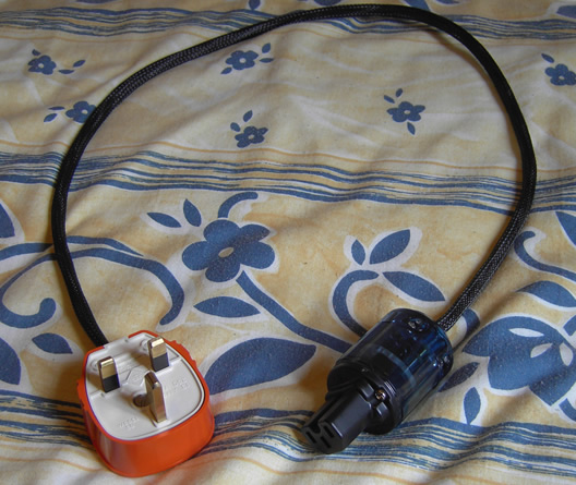

Erm, I can't find it
I had to console myself with making a couple of power leads for my amps.
And I modified my sound card yesterday, which has brought it on a lot!
Simon
Simon
Looks nice, Simon.
Any impressions yet, and if they're good, how about sharing your recipe?
Jim
