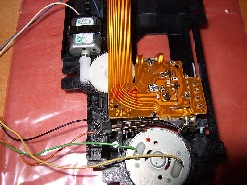

I just tried to hook up my separate power supply which made the thing go wrong last time. And I've broken it again
I'm getting a focus error this time instead of a radial error.
The separate power supply was putting out 5V, so I don't understand it. I only hooked it up to the DAC digital and analogue and removed U200.
In diagnostic mode,
P01 does nothing so the laser does not move up and down as if to focus.
P02 starts to spin clockwise then spins rapidly anti-clockwise.
P03 the laser moves backwards and forwards OK and the disc spins backwards then forwards oscillating every second or so.
I have tried two transports, so the error resides on the main PCB. My guess is the section that controls the transport.
Please, does anyone have any suggestions. If I get it working, I promise I won't try and hook up the separate power supply again.

I should have known...the laser IS the right one. BUT there are all those tiny wires that have to be soldered and re-soldered. And the rubber suspension thing'ys, and getting it all back together again!!! There's a trick, I know there is but I don't dare take any more bits out or I will never get them back in the right order.
Gag sob howl...this better be the fix...I feel like driving the car slowly over a Marantz 67, several times. Nobody talks about the horriblle stuff, only the glowing results
shepperd said:There's a trick, I know there is
This may help
http://www.diyparadise.com/cd46/cd46repair.html
Lee.
Thomo said:
That's a very good guide!
It's not difficult - I've done it on two 63s and a 67SE without incident.
The only thing I will say about this guide is please ignore the bit about greasing up the cogs. That's asking for trouble.
Take a few pictures along the way with a digital camera. Then you can remind yourself what it looked like when you're rebuilding it.
Finally, the last one I did required a LOT of force the get the flat cable connector into the RF PCB, but I got it in eventually.
Good luck.
Thank you guys! that was a good guide. I'm getting some help to do the soldering. The rest should be ok. It can be rather daunting and taking pics was an excellent idea (too late!) Having inadvertently lost my way, torn a wire, burned a componant, forgotten how to put something back together (this happened and I had to junk the cdp in shame), I really didn't want to end up with my 67 in the garbage this time. For some of you this is kids stuff, for others it's like having to fly a plane without pilot, who's just had a stroke...

A couple of harrowing hours of very fiddly work and I got the new laser assembly mounted and to my astonishment it not only works
but the mistracking problem seems solved. The LM4562's are in place too. Now to let everything run in (it seems just like I put a new cartridge on a tone arm!) Thanks to Brent for the address. I never would have found the laser otherwise. Special thanks to malefoda for the opamps and the pics (je suis fier de moi, carrement!) In my next life I think I will take up fish instead, less stressfull
