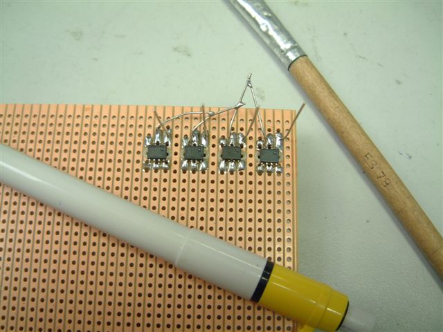

I am messing with some regs on a CD63SE and I am happy with the result.
I purchased some smt 7805 (LM78L05ACM/NOPB) and am running these with nothing other than 4x 220uF FC for the dac and decoder.
I am finding the audio to be better than with T0220 packge ones, better seperation and timing.
Brent
Brent
Cool Brent :)
There's only a few mA to deliver, why not. Did you put -like before- 20cm cords between your PSU and the load?
Regards, Jaap

So far all ive done is use croc leads to the relevent resistors and drop those FC caps.
I have tried each voltage rail individually and (no real suprise) the DAC analogue rail gave the biggest improvement.
Brent

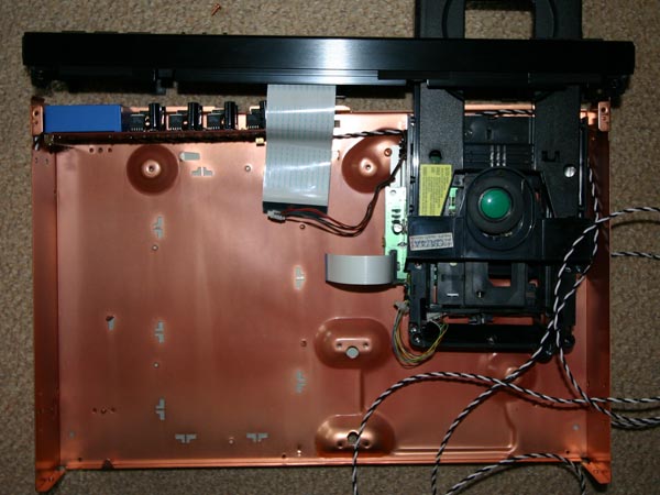

Hi fellows,
here is what I get from some gentle workmates...
Got also more AD8620 ( friends want some ;) ) and a ferrite for flat cables ( usefull for the player ? ).
I wanna know where to use the dampen material, first to load the mecanism ? And then the bottom of the case ?
Also I am now quite scared if I do the Ray's mods list my tranny will suffer... I own a simple CD53... is it dangerous ?

This black stuf, is it heavy? The idea behind damping the case is to add mass to lower its resonant frequency. Screwing in a (wooden) brace from side to side would probably do more for the thin case. Or a giant size camembert... you could fine tune it by nibbling it somewhat :clown:
The higher load presented by the bigger caps won't harm the tranny. BUT. Heating electronics over 50 degrees Celsius is disadvantageous for its trouble free operation and parts wear out faster. Your CDP will probably comfy duck this temp but it's better to be on the safe side.
This material is quite heavy (not as gold...), and it is used on some expensive machines in order to avoid vibrations and noise... my workmates stick it in the inner side of the hoods.
Machines such as this one ;) :
http://www.datacard.com/products/products.jhtml?contentId=778245YuR3ckg6
I red in french forums that the best is the bitumen pads from under the classic bathes, as the sounds like bells if not fitted under and you can have cheap prices for some at your local dealer :)
I've planned to tight the case around the tranny as the SE, and maybe as you said screw a heavy iron or steel plate under. I'll manage some holes on the back panel for air cooling, something like the 67 series.
It's self adhesive, that makes it easy to apply to odd places like corners or bent surfaces (underneath the transport).
If you're a skilled mechanic (I'm not unfortunately) you could think of a new hood for the CDP. One that features a chimney to get rid of heat the natural way. Would be original.
