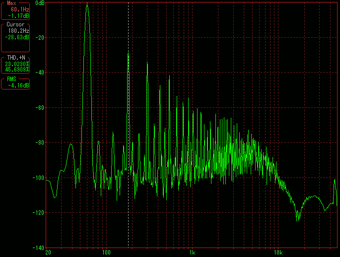

I'm no longer so convinced RF is the prime concern at the end of a power cord. The spectrum below is taken at the output of a 2.5VAC, 10 amp Triad EI filament transformer loaded with 1 ohm to emulate a 2A3. Note the harmonics appear to be all odd.
I was actually thinking more in terms of inter-chassis potentials and ground loops.
Edit: Hi Andre. I've already sacrificed one $200 sound card to the gods of science, I'm not keen to tempt another. I did however try the same experiment with a second transformer laying around, a toroid of different Vout, VA and manufacture. The result was essentially identical.
Over here most equipment, except perhaps amplifiers, are bought with only live and neutral wires, so no chances for mains earth-loops, and I have found that a good mains cable on the amp improved the SQ.
When connecting all equipment to earth, I agree with your thoughts.
That's why I've asked if it is possible. :D
I believe you are on 120Vac? Over here it is 240Vac and I'm also not very keen to measure.
I believe a transformer will stop the rf but it is possible for the rf to transmit into other parts of the cct once inside the chassis. What do you think?
