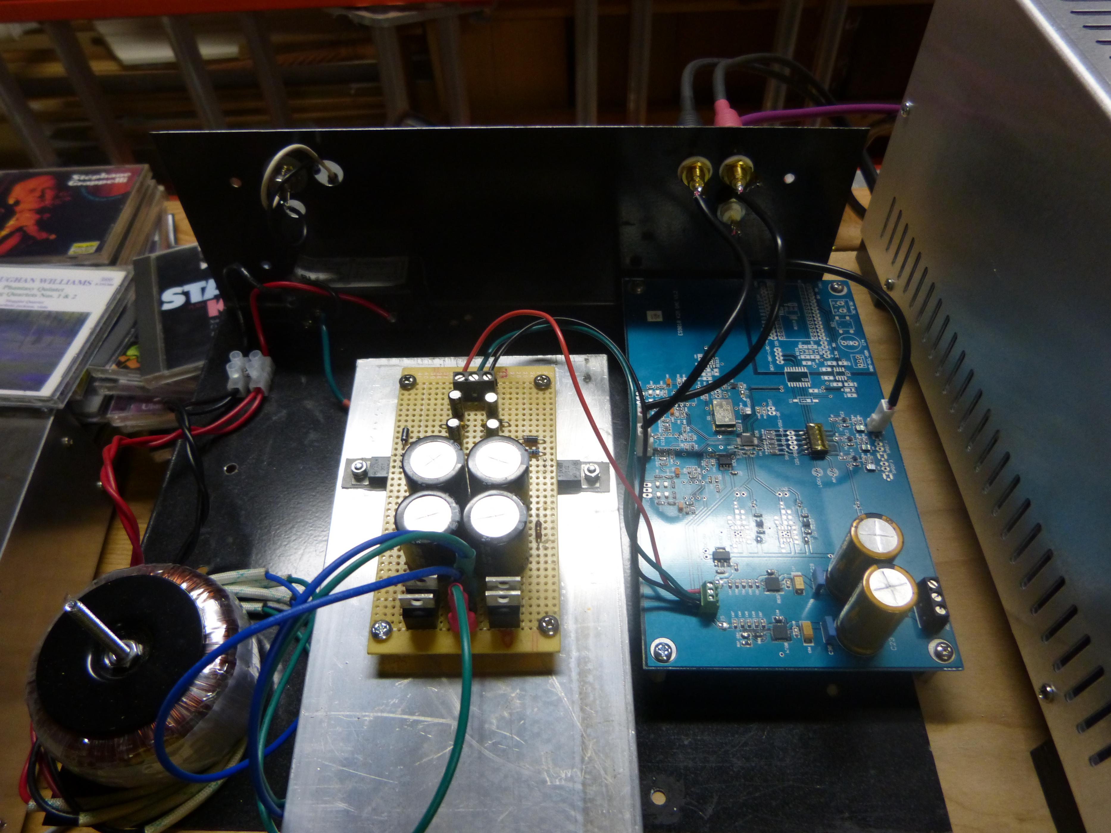

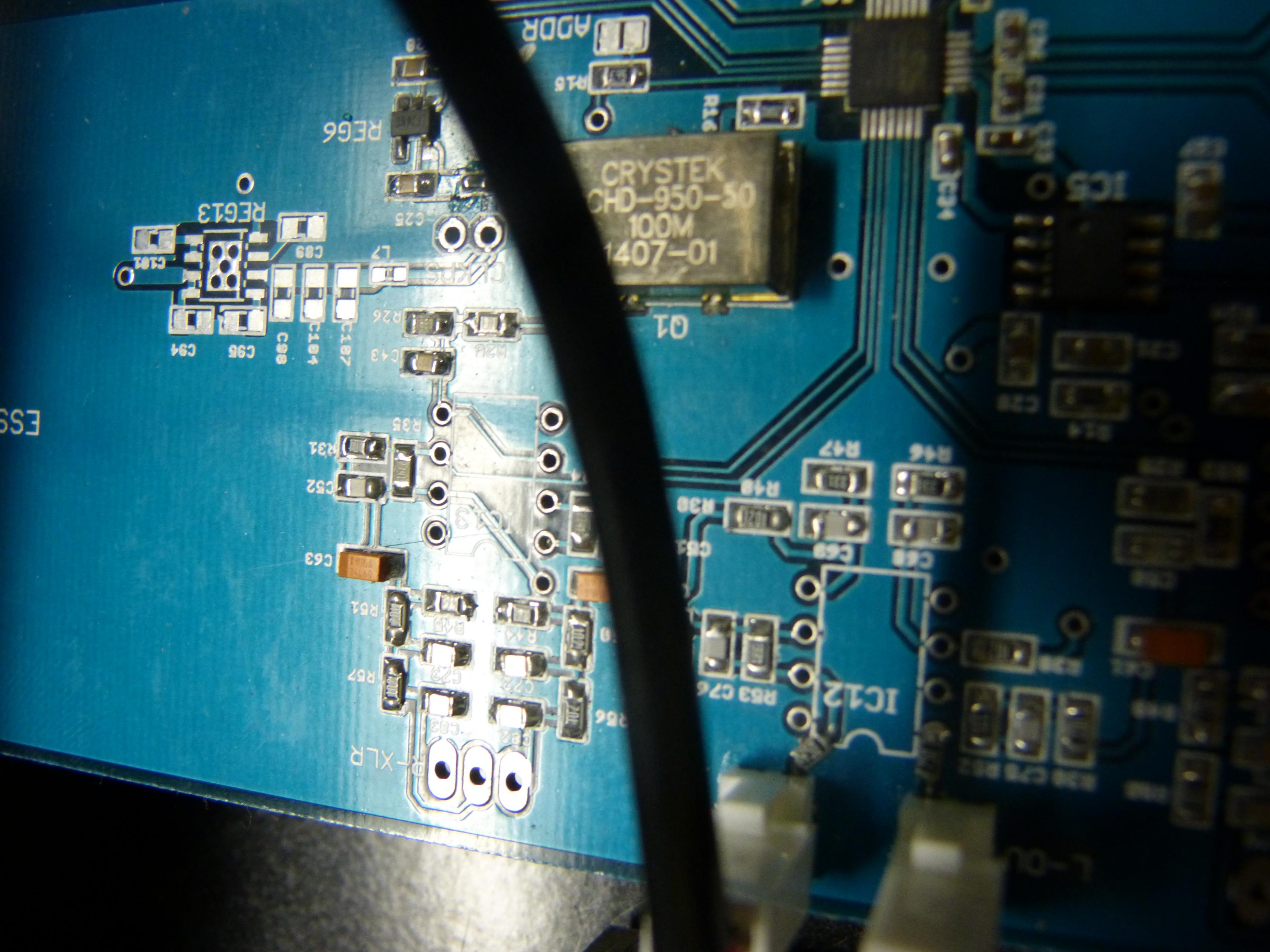

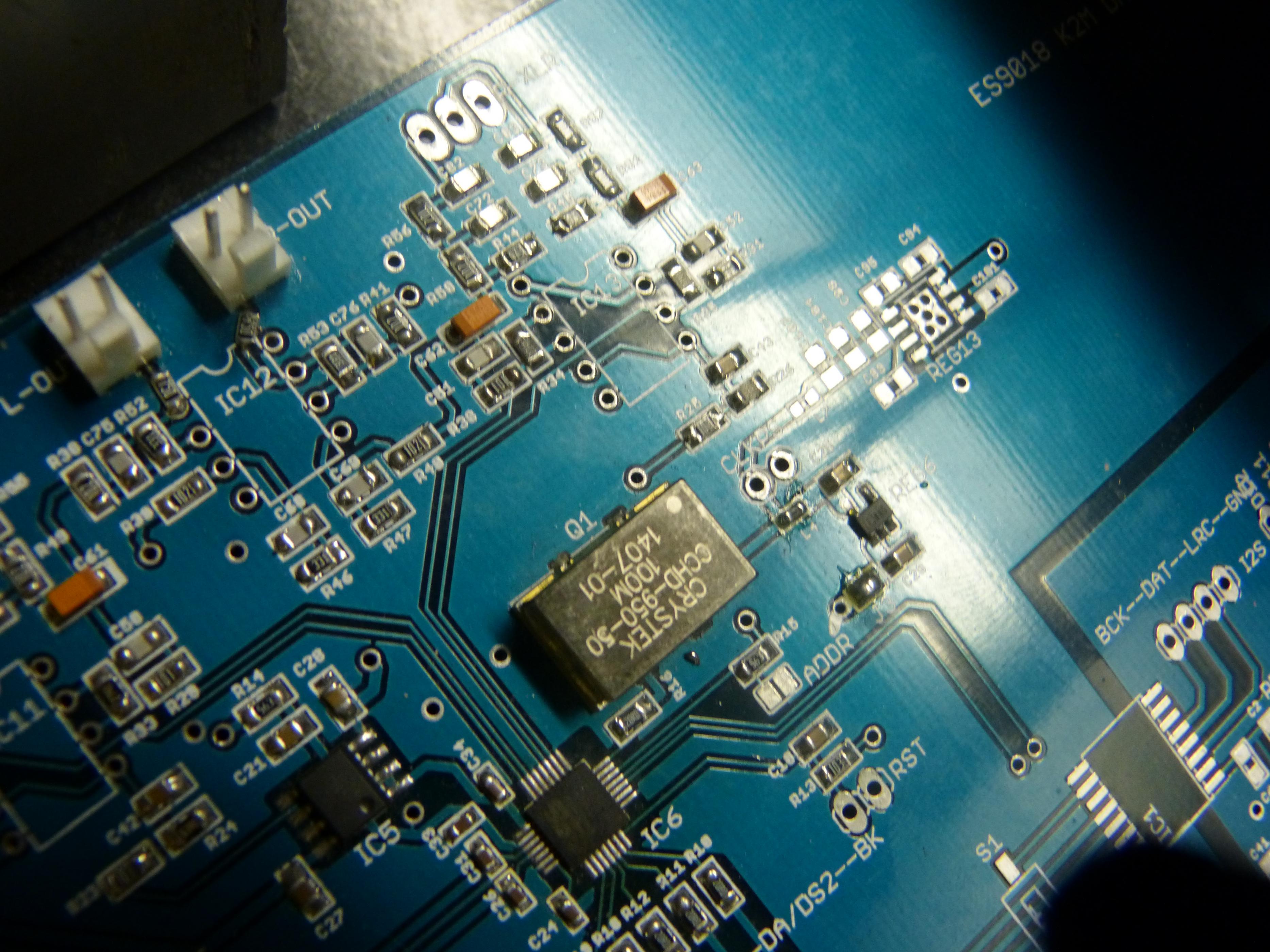

Spartacus, I attached two 75ohm resistors at the output, but still getting the crackling after about 15-20 minutes. I also added some shielded cable to inputs and outputs. I have to say the sound just keeps getting richer. If I can solve the distortion, this will be one incredible dac.
I disconnected the amps and cdp and measured voltages, but still did not see anything unusual. im in the process of inspecting solder joints. Any other ideas? Thanks. Cheers.
