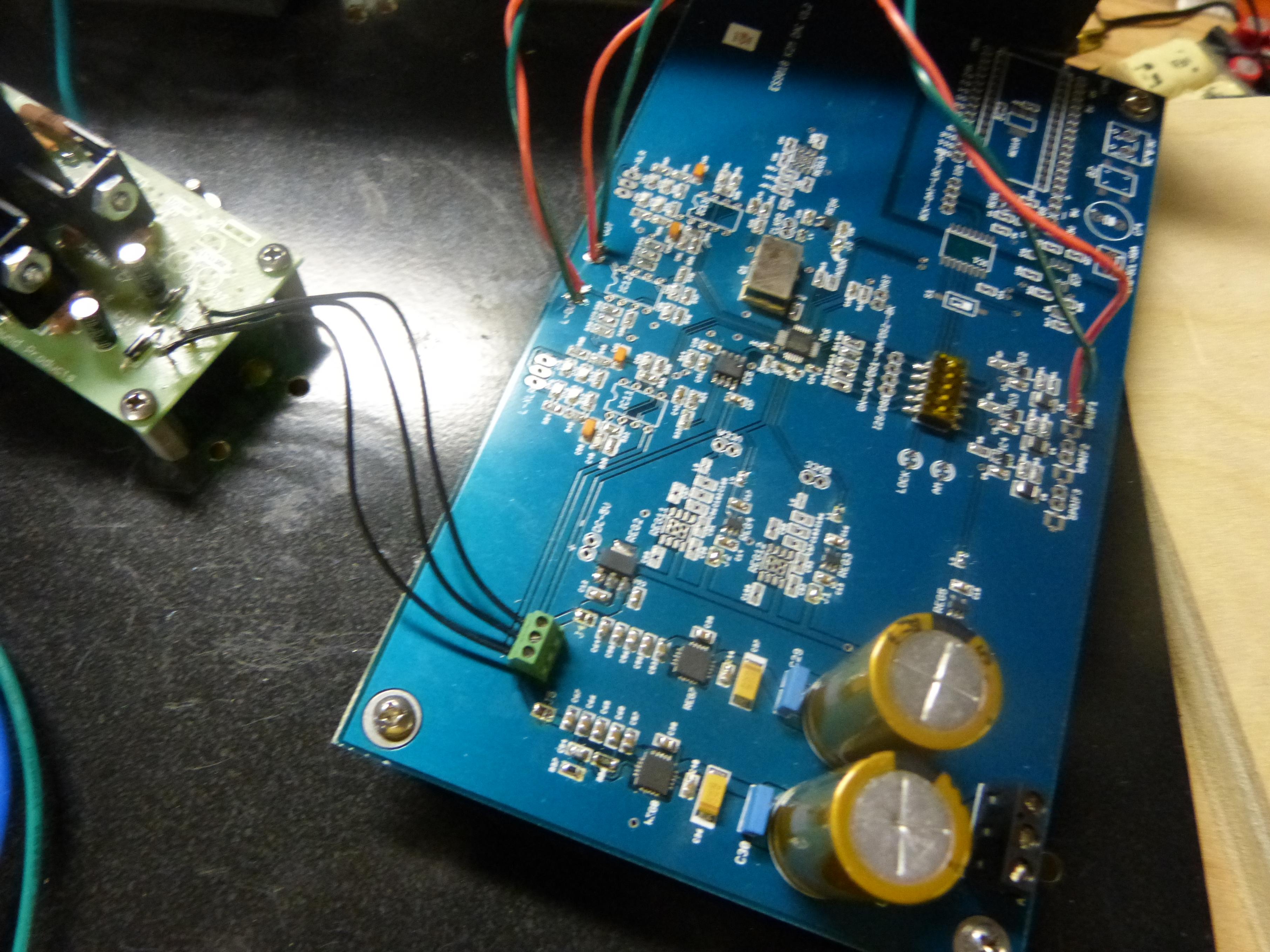

Good news and bad news to report. I managed to fry the TPS regs. I'm getting +22volts/-1.2volts. I connected an external lm317/lm 337 supply and am getting really nice music despite less than ideal psu. Sound is very detailed. I noticed vocals are particularly nice and this is only after playing a few tracks.
I'm new to smd soldering, but is it possible to remove the tps regs by hand without an air gun and to solder new chips without specialized tools?

But how did you fry them?
Not sure. I'm an extreme newbie so I'm guessing that I shorted something when measuring or by overheating something. The chips themselves were pre-soldered.
What voltage is your transformer ? Noticed today on Bom the 47uf tantals on input of TPS regs are only 20v rated. If you use for example 15+15v you will measure 21-22 v on those 47/20v caps. Try to desolder those caps and measure again.
Using 15-0-15 25va. Voltages across c39 and c38 are +/-22v. I will remove and re-measure. Thanks.
For the next builds i think is useful to open J4 and J5 bridges before powering any chip from Dac and check +\- 12V voltages. Same approach with Subbu Dac and it was useful.
I did open those jumpers, luckily. What is the ideal transformer size?
I am very curious how it compares to Subbu V3. I would not be surprised if they sound alike.

Is it possible to find tantals that can take higher voltage,I have a 2x15v trafo that I intend to use...
..not really good idea... more power to dissipate in regs, 2x12Vac is a good option!

Listening continues albeit with makeshift psu I had on hand when the tps regs did not cooperate. The treble is really special with this dac. already competitive with the subbu in that department. I'm going to find a better psu asap and continue listening. Have you replaced QFN package before? Im wondering if I can use the exacto blade technique with these. Sorry about the fuzzy photos.
No I haven't. Good luck removing it, it seems to be not an easy task if you don't have a hot air gun.
