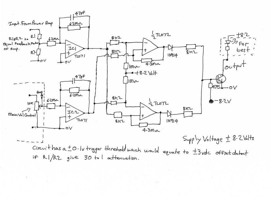

Way back at the start of this thread I mentioned I was looking into a way to overcome the inherent delay caused by the integrating network of most DC offset detection schemes and ways to speed up the turn off of the relay under fault conditions. I would appreciate comments (bad or good) on the following circuit idea. This is only at present an idea (and only the first part of the circuit-no relay drive and power on delay yet) but initial results are promising, the circuit is exactly as designed, and I know some of the component choices and supply rail values are a bit weird, but I know from experience the folly of making untested changes, even if they seem a good idea on paper at the time. One obvious complaint is the fact that it requires connection to the wiper of the volume control but it is via an extremely high impedance that works into a virtual earth, and I would be looking to "up" the value of the 6.8meg input resistors. The input has to be attenuated by a value equal to the feedback factor of the power amp and is set by R1 and R2 so that the inputs to the two OpAmps are identical, the 47pf cap forms a simple low pass filter, the two outputs then be fed to a comparator (TL072 at the moment) . A + or - 100mv dc offset triggers the output, so a 30 to 1 attenuation at the input would give + - 3 vdc detection of offset.
I would welcome any comments or opinions, if you think it's a non starter please say so.
