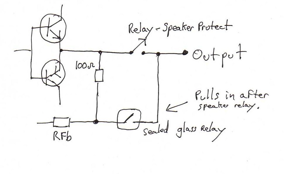

The relay is not within the global feedback loop, any source resistors, emmiter resistors etc are. Personally I don't believe contact resistance is a major issue here, but had this idea, the small glass sealed relay will include any non linearity of the main relay within the global feedback. Thoughts anyone.
Mooly said:The relay is not within the global feedback loop, any source resistors, emmiter resistors etc are. Personally I don't believe contact resistance is a major issue here, but had this idea, the small glass sealed relay will include any non linearity of the main relay within the global feedback. Thoughts anyone.
I think the relay simply makes a negligible difference and I certainly cant hear the difference. But the benefits of having the relay there far outweigh any slight problems. I built an amp and missed a soldered joint in a previous design, the output went to 48 volts and fried 2 speakers !!! So a relay compared to the cost of 2 speakers is a very big saving.
