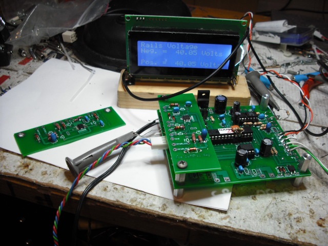

Hi everybody,
Right now I am working in few problems and solutions already mentioned here.
I have a prototype that will constantly monitor the AC and if one of the cycle it is lost the micro will turn off the amplifier. Also it will not allow to turn on again until it is turn off/on. This will prevent the amplifiers turn on in case of AC power outages. Also I eliminate the speaker output relays and control it by shutting down the rails voltages immediately. I am controlling and monitoring the rails voltage and adjust them accordingly of the voltage set point. This will eliminate the output relays. Everything explained above it is running in a prototype. When the amplifier it is turn on/off the rails voltages are slowly ramp up/down and the voltage it is control and monitor by the micro. Everything it is controller by a micro. Attached it is a picture of the running prototype. Also the speakers are turn on/off by monitoring the current using a hall effect current sensor. If the current it is reach the set point it will shutoff the rails voltages to protect the speakers. Suggestions are welcome.

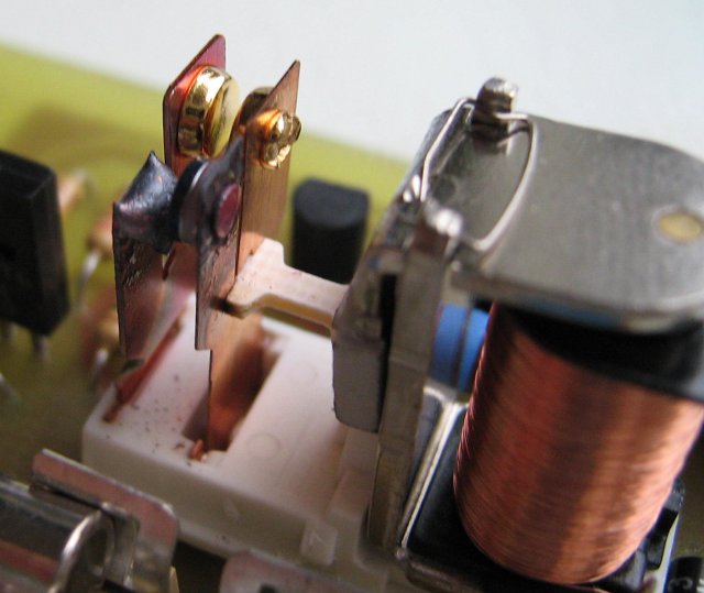

Now thinking about the output relays, the distortion they add, plus their effect on the damping factor. I think having the feedback tapping on the far side of that relay might be a good thing to do so the extra distortion would get reduced. However when the relay switches off, then there is no feedback loop any more, so perhaps a double feedback loop needs to be put in place, with one tap as usual on the amp's output, plus an other on the far side of that relay switch to include it in the loop. This obviously needs to be done right.
If we implement the output relay as a SPDT with the speaker line on its common and the NC contact going to ground, the extra feedback loop would tap on the switch common/speaker line and when the relay drops, that feedback then goes to ground, and there must be an "inner" feedback from the amp's output to keep it closed loop. I would like to know the actual effect of such a double feedback loop.
One of the ideas that I wanted to work on with the NC contact grounded, is to insert a resistor there and have some type of sensor to detect a short on the speaker line through that relay conact on power-up, so the protection circuit would not activate the output relay and connect the amp to a shorted line. Eventually this can detect automatically if/when the short goes away, and perhaps with some extra delay added, then activate the output relay when the path is clear.
Eliminating the output relay and avoid a crowbar on the output would also be nice, however if you protect from the rails, even with a fast shutdown via a crowbar or something of that nature, if something bad happened in the amp's output stage and a shorted device sends DC to the speaker, even for a short burst before the rails are brought down, this may still be dangerous to speakers. The big woofers may survive such DC burst if short, but what about tweeters?
How are the rails controlled and shut down?
I wouldn't go to the extent of using a micro for a protection system, the micro could cost almost as much as the amp's circuit, especially if there is a display, keyboard and whatever.
This can be done much simpler with discreet components, and at a much lower cost. I guess it depends on what use the amp is destined for.
Trench FETs can shut the rails down in a few microseconds.
Protect the speakers AND the transistors.
It's a really nice idea.
Tauroo uses a microCONTROLLER chip. These are a few bucks.
Cheaper than discrete and probably actually simpler, once you are tooled up for them.
He also uses it for inrush current control.
Once you have the microcontroller the extra functionality is almost free.

Relay manufacturers do not recommend this configuration, one datasheet I have seen specifically states not to connect relay in this way. However instead of connecting NC direct to gnd - with a resistor in the path e.g. 3R this would hopefully not be such an issue, and if using higher voltages (much above 40v) this could be a simple solution to ensuring there is adequate fault current to blow a (fast) fuse quickly.

I believe relay protection is the best form, as it also prevents start up thumps. I have not been able to detect any reduction in audio quality with using a relay (the G2R-1-E-DC24 is very tried and tested). My concern with alternative methods such as mosfets in the power lines, is that complexity can be increased, and thus the risk of protection circuit failure. Also e.g. when output stage transistors short, the instantaneous currrent flow can be huge, and this can cause Mosfets to fail immediately short circuit mode.

Sorry for no answer the questions I was working in my prototype with a display bug.
I forget to mentioned but I also slowly ramp the AC to the transformer at zero crossing when the amplifier it is turn ON/OFF. This will prevent the inrush current at the turn ON/OFF. I been using this for at least 8 months in my amplifier with no problems.
I am using the ACS712- 5 amps for the speaker current monitoring. You can buy it as 5,12,20,30,50 ,100 amps.
What I do to the rails voltage it is to monitor the current and if it reached the tripping set point immediately I shut off the mosfet gate. Attached it is block diagram of the voltage control. I can control the rails voltage up to 140 volts single polarity or +/- 70 volts dual polarity.
I am using the Basic micro nano28 that it is $10.00 and it is programming using simple basics.
