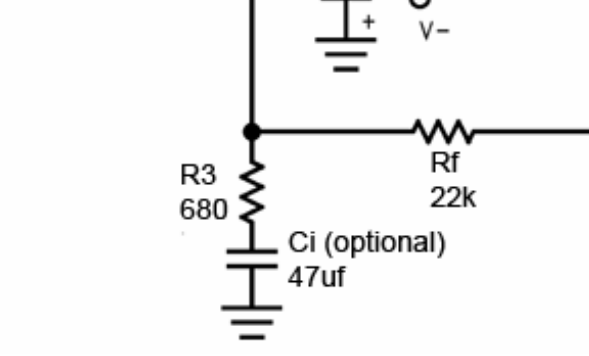

are you using the same pcb layout that is attached in page 1 or you draw your own pcb layout base on the schematic? if you use the attached pcb layout then the position of C4 and R3 is already fixed but in the schematic it is reversed.
you should also check your IC chip if it still good or already busted.
attached image the position of R3 and C4(Ci in the attached image)

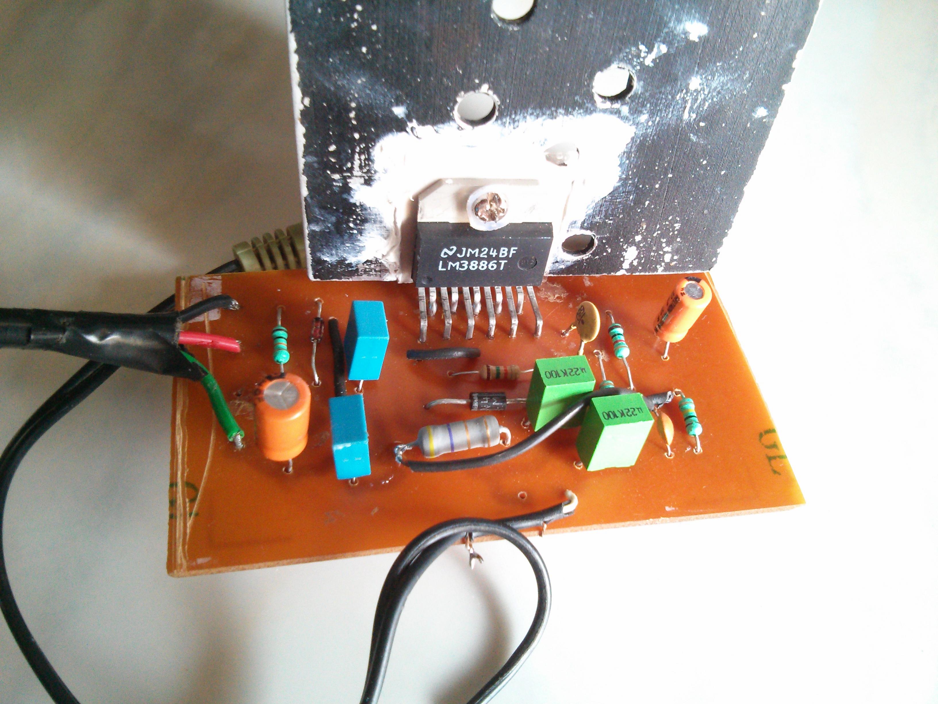

Hello udailey
I am posting pic of amp
My lm3886 chips have light grey writing on them so its possibly a fake. component placement looks correct. My concern in the solder spatter. This is everywhere. Especially near pins 1-6 and there is a bug burn mark in the board near 2,4,6. Spattered solder causes arcing/shorting and will kill or temporarily disable an amp. Thats my guess. I always use an awl to scratch away any spatter between traces on my homemade boards.
Nail polish remover often has oil in it and is rather expensive. Just go to any paint or hardware store and get a bottle of acetone. Clean the toner/ink off the board with that before soldering. Either cover the board with spray flux or solder it within a few hours of cleaning, otherwise the copper will oxidize and make soldering harder.
You also need supply decoupling where the power enters the board. 1000 uF where the power comes into the board, 22 uF || 1 uF X7R ceramic right on the pins.
I don't see the point of the two diodes.
