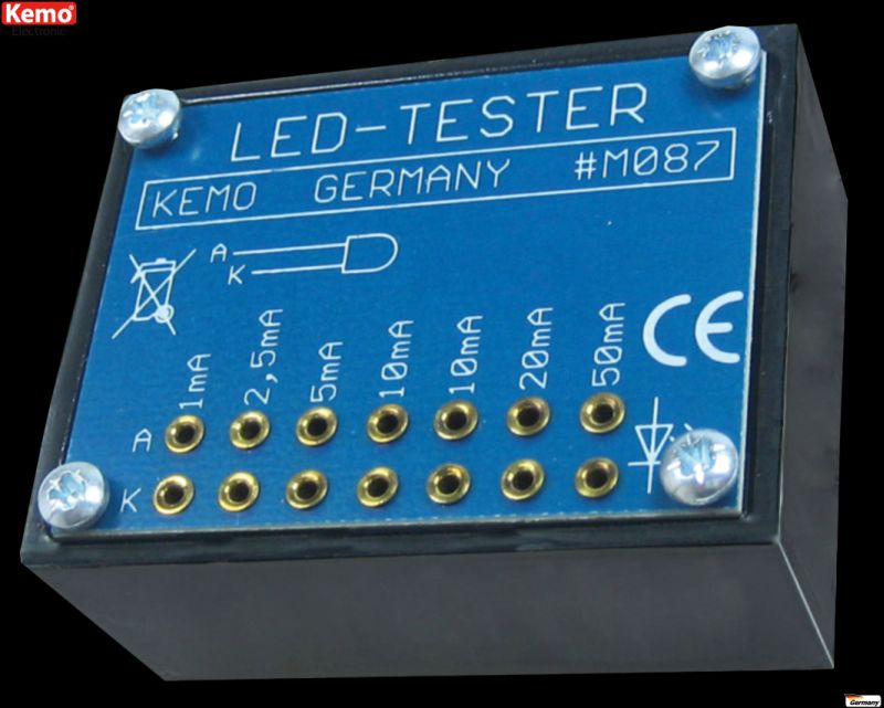

Guys, I have recently tried to calibrate the LSA using a scope. What struck me is the following:
- I managed to calibrate the levels at a certain volume (say 1/4 of my pot). Very nice.
- If I then open the pot further, the matched levels across the channel seems to disappear. In other words, one channel is more attenuated than the other.
I am using a Alps Blue Velvet pot...
What's happening, and how can I counter this?

Sounds like your LDRs are not well matched. Put the volume where you normally listen, and match there using the adjustment pot. Or do better matching on the LDRs.
Got my LDR's from the official source (Uriah)

Your LDR's are not well matched, get yourself one of these and use your DMM with it to match up the resistances from 1-20 mA
