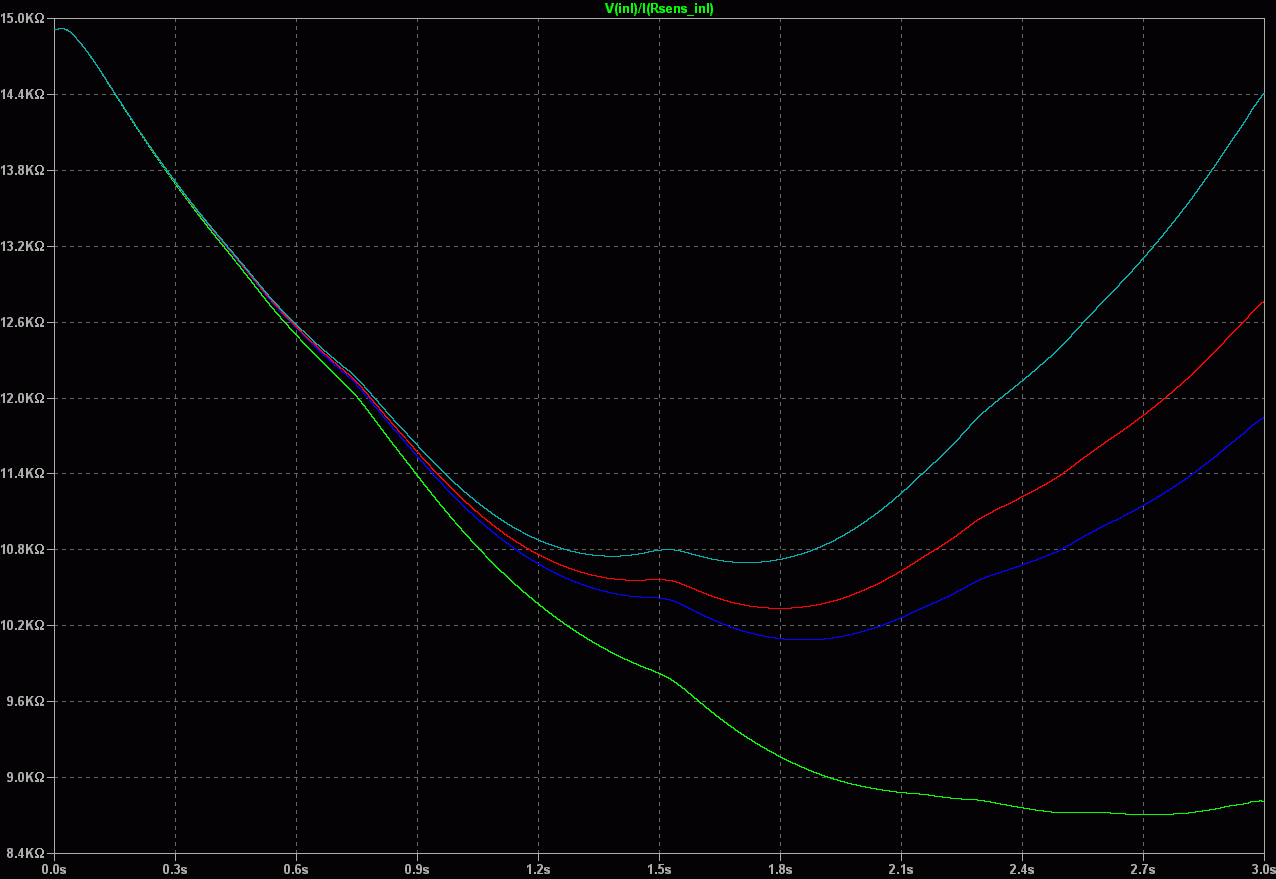

Sure, but since we are in the Lightspeed thread, maybe I would ask another question along those lines - has anyone ever posted a graph of input and output impedance vs. volume control rotation for the stock Lightspeed design? Since we are on page 461 of a discussion spanning many years, I may have missed it.

Yes. I did post such graphs, in this thread, from simulations. If I recall correctly, there was not much interest at the time.

OK, thanks, found your simulation posts and measurements by others around post 1055. The input impedance is not as low as I thought.
Hi guys had this on file hope you don't mind me posting it Tom.
Here is Toms' graph of the MkII Lightspeed Attenuator input impedance from min volume to max with the load (input impedance) of the poweramp being 22k (not recommended), 62K, 100k and 1mohm
As you can see the input impedance as measured by Tom varies between 15k and 10k good enough for virtually any solid state output source and some tube output sources.

Actually, since that was one of the ones that I only let run for 3 seconds, it's not quite right. The sim should run for 10 seconds, because of the time constants in the LDR model I was using..
I think that plot was for the volume knob being turned from min to max over the time on the horizontal scale.
The LTSpice simulation models are also posted. Someone should verify that I had it set up correctly and then re-run it with at least 10 seconds instead of 3 seconds.

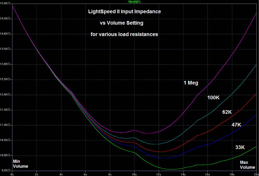

EDIT: OK, I just found and re-ran the original simulation file, but with 10 seconds for the knob to traverse its entire range, instead of 3 seconds. Now, the input impedance is a tiny bit higher, everywhere.
Higher, even better thanks Tom. No need for buffers before or after the MkII Lightspeed Attenuator so long as sources are low around 200ohms or lower and poweramps are 47kohm (industry standard) or higher, as I have always preached.

Very interesting. At this impedance level, interconnects impedance effects are significantly reduced. So the source is really driving a constant load across the frequency range. Plus that lack of moving contacts in the signal path, this makes a good combination. Interconnects with single #24 core would work great here.

Yes like I've been saying all along no need for buffers before or after, if you use real world sources with low output impedances (as it should be).
And you don't use amps that have low input impedance of less than (new benchmark thanks to Tom) of 33k or maybe even less looking at those graphs.
