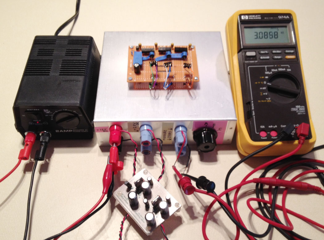

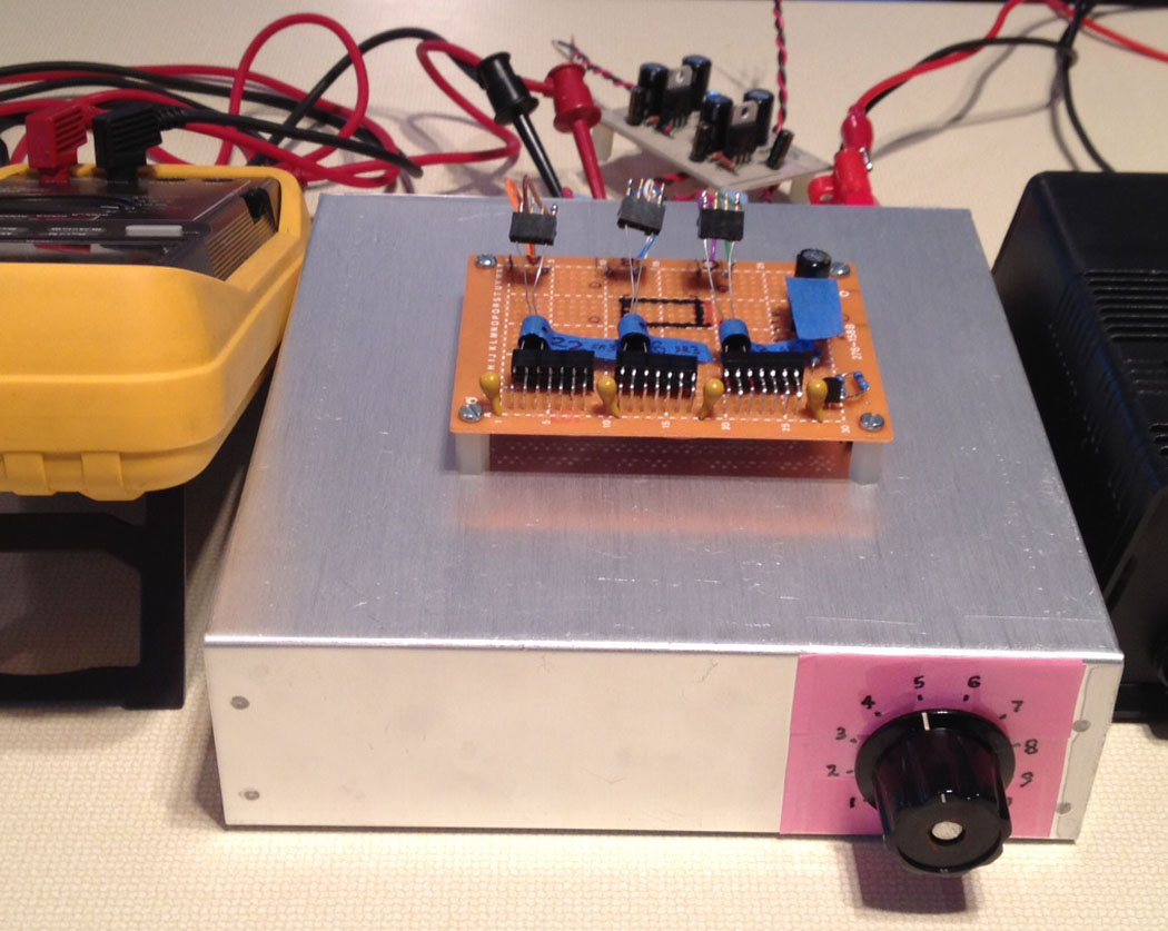

Here is my matching rig - it allows 3 LDR's at a time, (A,B,C on the back) with up to 12 current settings as shown(knob on lower right front).
I use blue painter's tape to mark all the LED's first, and then put the readings into excel for sorting/graphing. Looking at a log-log plot of current and resistance for 2 units tells you instantly how good the match is.

This method is stable to very low uamps, and easily returns value in the Mohms. I agree you need to measure resistance higher than 10K, and very little is gained by taking a lot of data points in the 2-20mA range.

I think the 2 x 10mA holes are a manufacturing defect as they are (on mine at least) both the same.
Cheers George
The documentation says that they are for matching the brightness of 2 LEDS at the same time (presumably by eye)

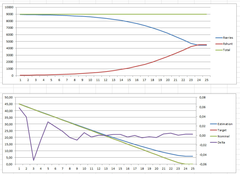

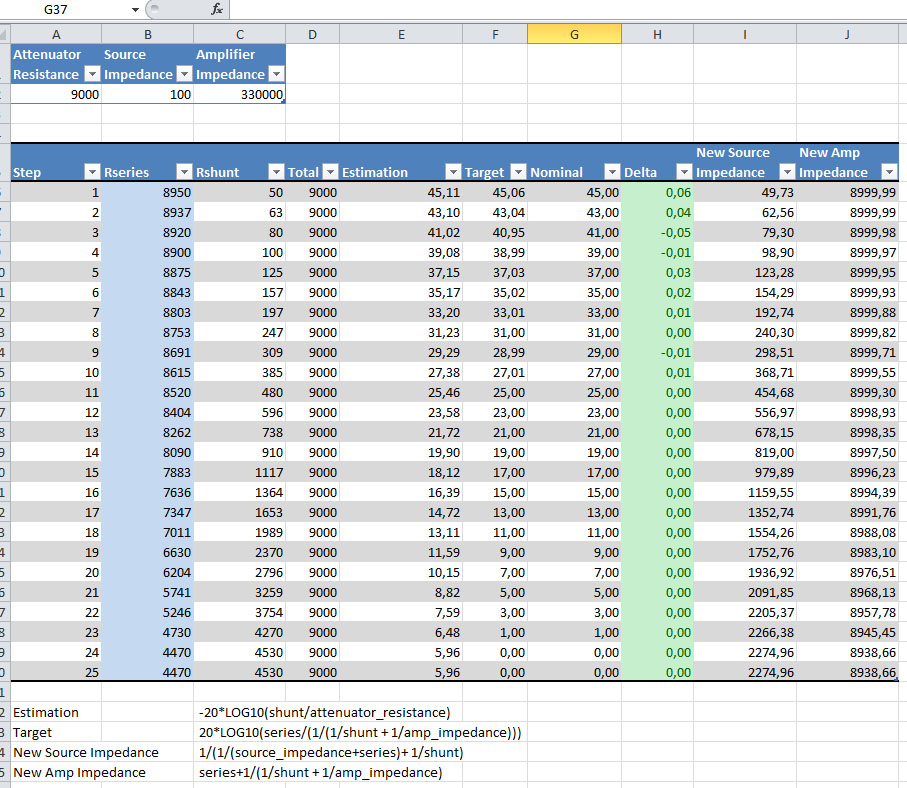

I am still working on my approach to match LDRs on the fly, and I have reached a nice average solution of matching on 24 positions, according to the image below
This seems to work nicely, but I am seriously considering jumping to a Tee topology.

There are many advantages in Tee. Sound is something that I have not yet tested, but what I particularly like is that it will allow keeping the impedance constant for both input and output.
So far, this is the issue that I am trying to find a proper solution to. Wether to used a matched tee (both output and input have the same impedance eg 9k) or to have a 9k input impedance and a low output one (eg 600 ohms).
The advantage of the tee topology is that it can keep those two constant.
The problem to designing for different impedances is that depending on the difference, there is a minimum attenuation. For example, if I go for 9k input and 600 output, the minimum attenuation has to be 17,63db (no small at all) which means that we have to sacrifice the upper end in the power of the amp.

100R output impedance with 9k input, will mean 25,54db minimum attenuation which is very much
