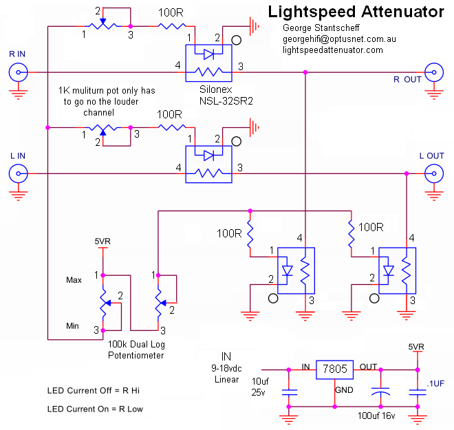

I am keen to make one of these attenuators, and have already made an Eagle PCB ready for when I order my parts. I have a couple of questions ... (These question may have already been answered already in this thread, but I have only read the first 50 or so pages, there's only so much you can read in an evening.)
1. Why are the resistors used 100 ohm? Surely when the pot is fully in one direction you have 5v/100 = 50mA, the Silonex devise LEDs are only rated at 25mA?
2. Do the devices have a logarithmic or linear response? Anyone got a sample plot of resistance against mA draw I can look at? (Basically I want to know whether I will need a log or a lin pot)
3. I noticed in a few posts, that some people said that their attenuation never reached quiet and was nearly full at about 1/4 turn. Surely, when the pot is turned right down, you would have voltage divider of 40ohms / 1M ohm, this would be silent, wouldn't it? As for max volume from 1/4 turn and up, could this be the 100ohm resistor allowing too much current to the LED?
4. Why are there only 2 trimmers used on 2 of the devices? Why are they not used on the other 2?

Another question if someone would be so kind to answer it....
If a 100K linear pot was used and it was set to halfway, that would be 50Kof resistance in series with the top 2 devices and 50K to the bottom 2 devices. 5v / 50K = 0.1mA ! Is 0.1mA enough to light the LED inside?
Is there a point at which the LED doesn't light, and if so, wouldn't this give a band on the pot where the volume doesn't appear to change?

So far, it looks like a 100K dual log pot with 47uF caps across LEDs seems a good place to start.
There will be no need for the 47uf across each led, as if you look at the power supply for the production Lightspeed Attenuator, it already has a 470uf cap across the leds.
As far as using the 100k log pot goes with quad matched NSL32SR2S this is the best progressive control curve from min volume to 2 o'clock then it ramps up faster, which is the ideal curve to have.

Hi GeorgeHiFi. Thanks for your reply.
I've only just got to post #757, where I notice you have used only 1 trimmer and single gang pot. I suppose that's why you need quad matched NSL32SR2S now.
I should have read more posts before I spent 3 hours designing a board on Eagle which uses the old design with the 2 trimmers.
Do both these designs give the same quality, as the newer design has less components, but obviously needs quad matching. Also, you mention a 470uF cap across the LEDs....Is there a post with the schematic of this?

Yes the trimmer only has to go on the louder of the to channels for final calibration. Quad matching gives you a better log feel to the volume control and more stable i/o impedances. Attached is the schematic it says 100uf but I put 470uf in, what's a few uf's between friends.
